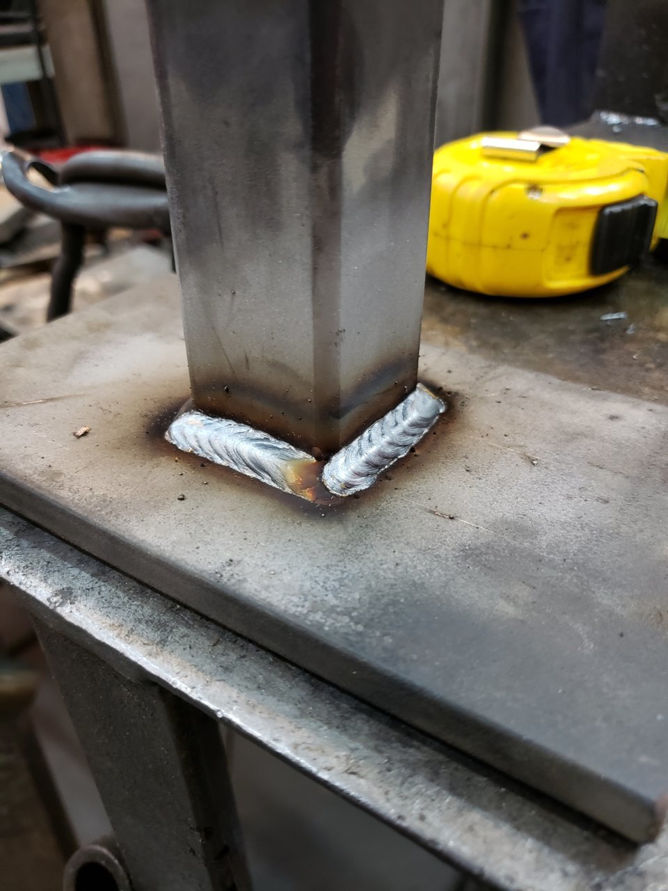

    I welded a cross bar underneath, drilled thru the top, and connected the two on each side of the bar.

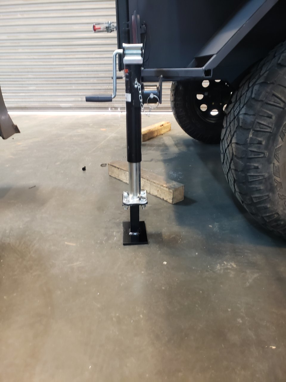

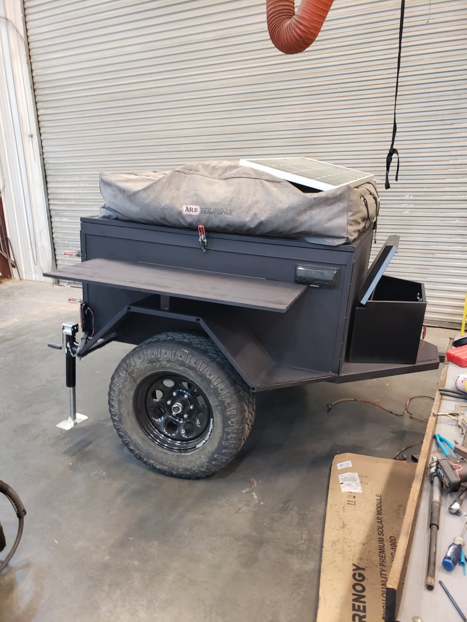

    Rear jacks done. Ran all the brake light wiring inside the frame. Side table done. Working on water tomorrow. And some ideas for shelving.

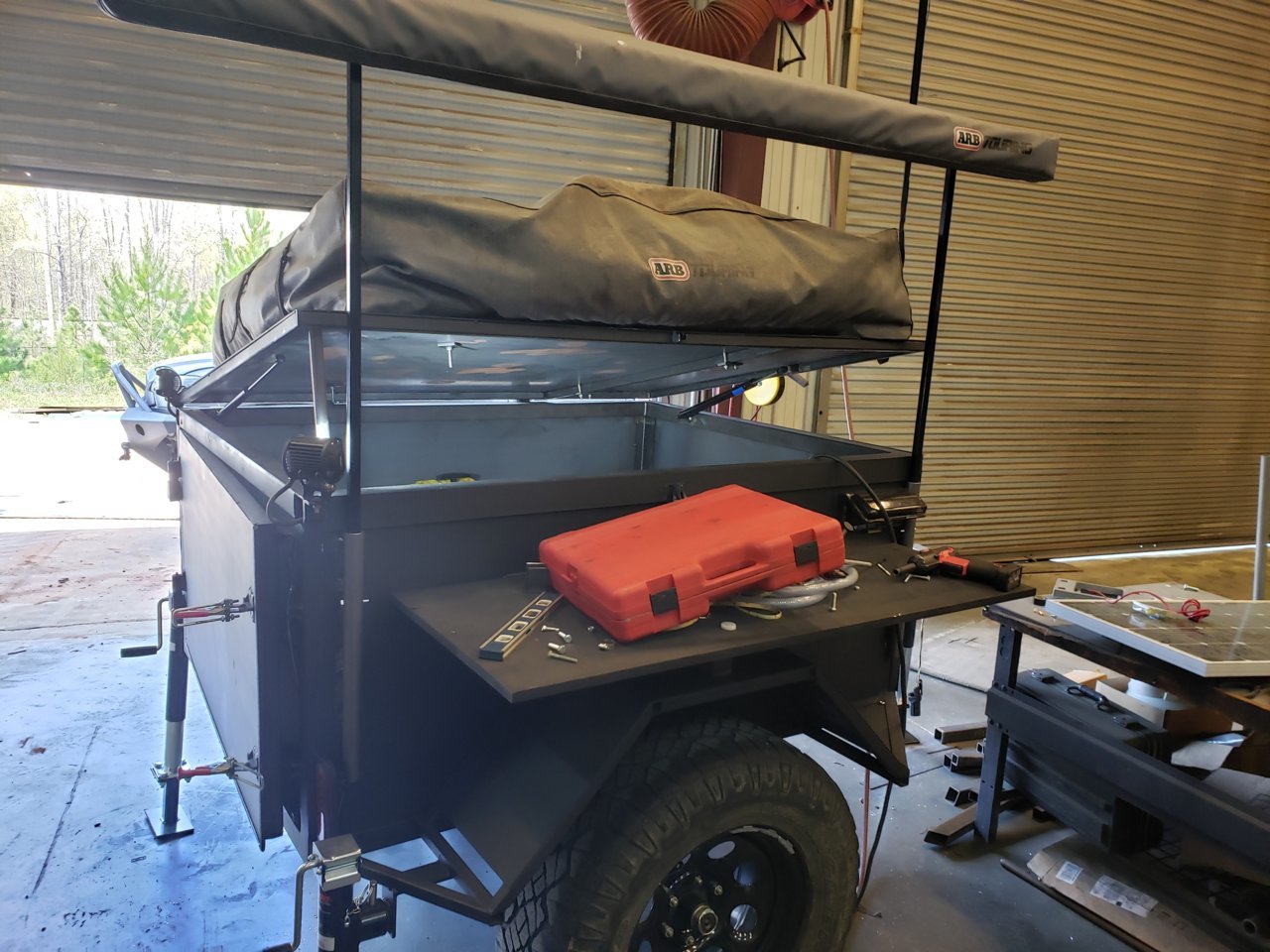

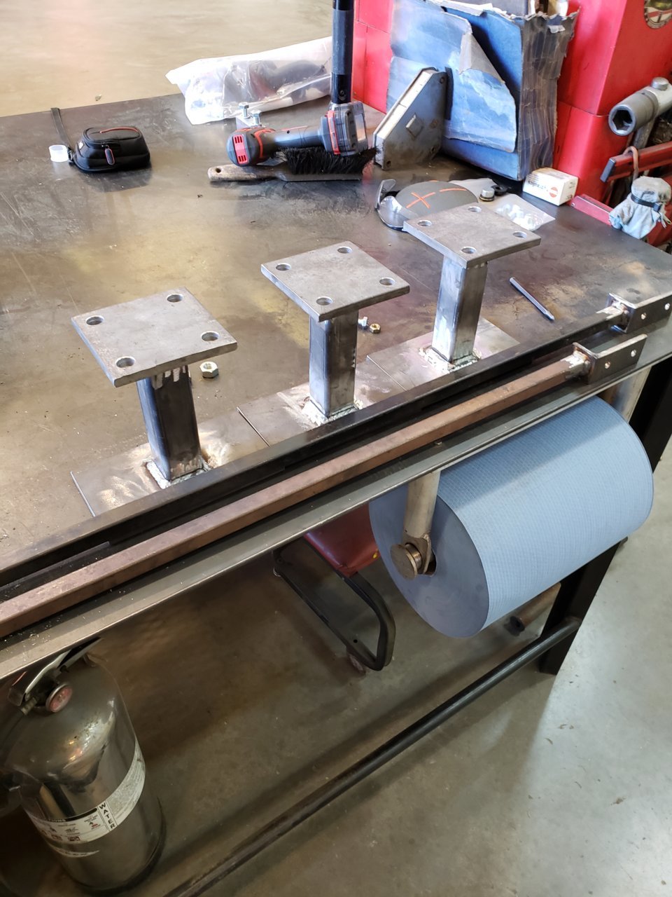

    Jack extensions done.

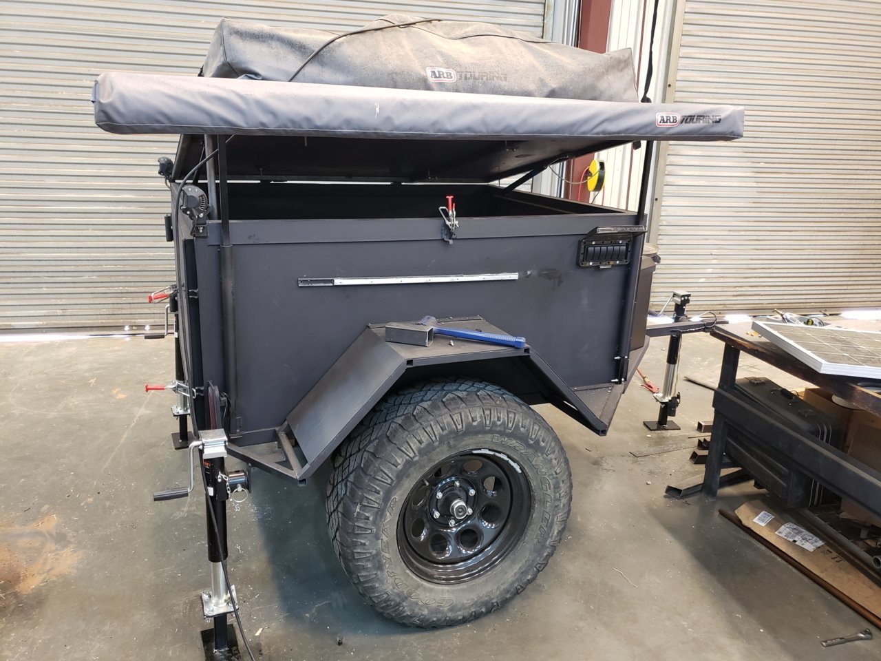

    And fabbed up some adjustable height awning mounts .

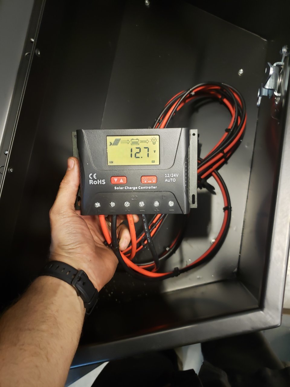

    Solar controller and battery is in

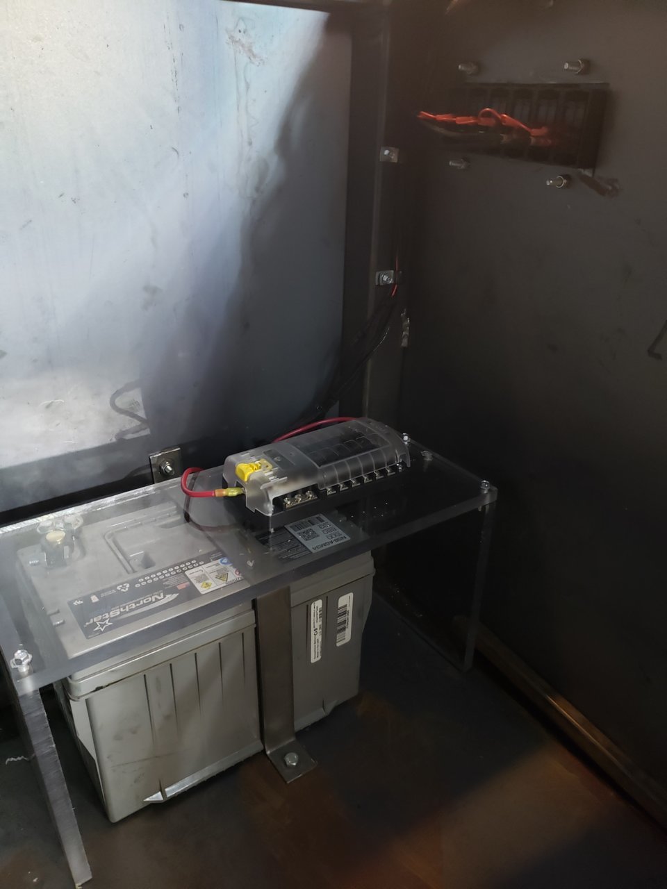

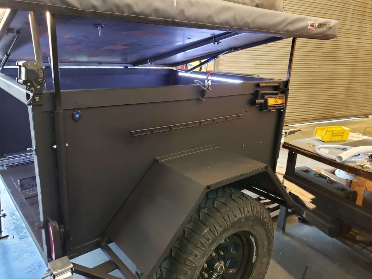

    Made some good progress today.

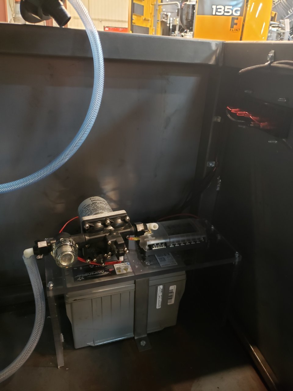

    Battery,solar charger,blue sea box, scrap lexan shelf for water pump and box,finished the awning mount (should have time to weld it tomorrow)added light tabs to the rear, attached the risers,....

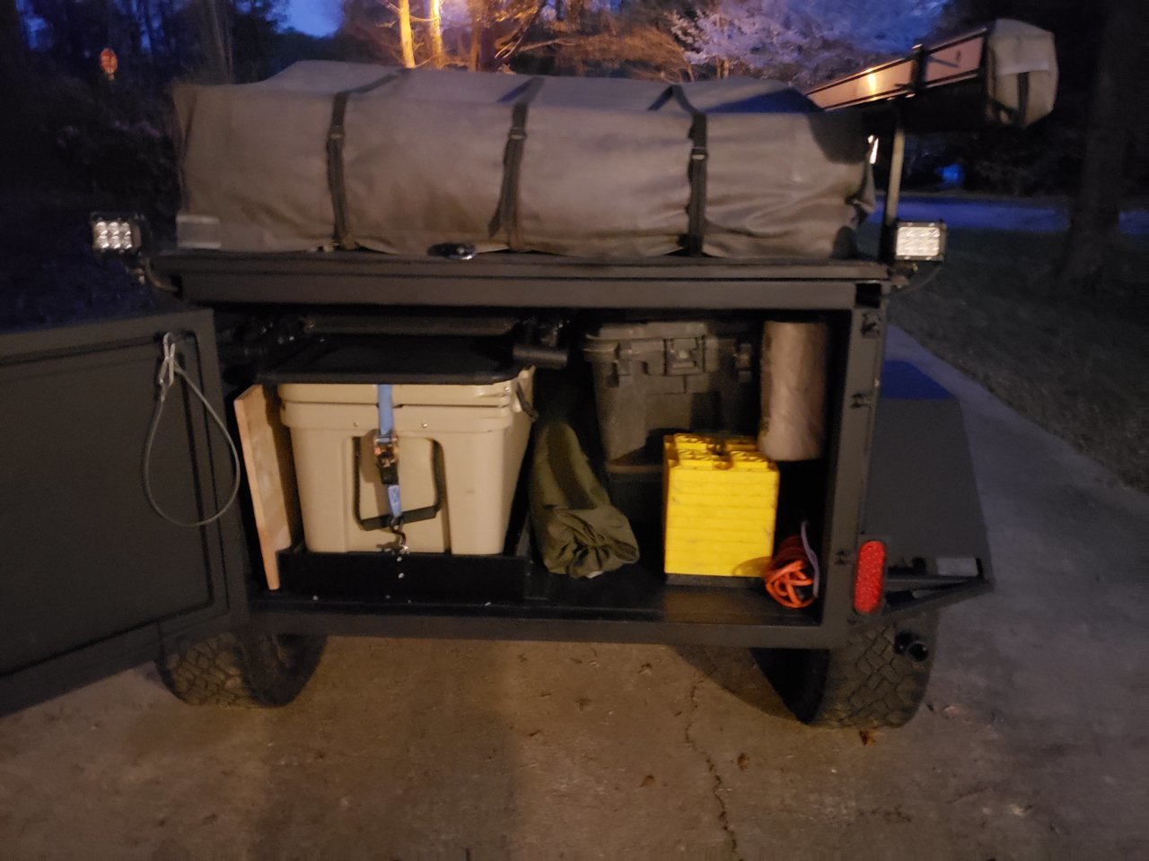

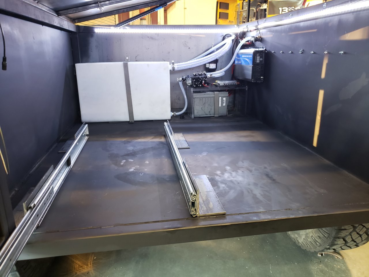

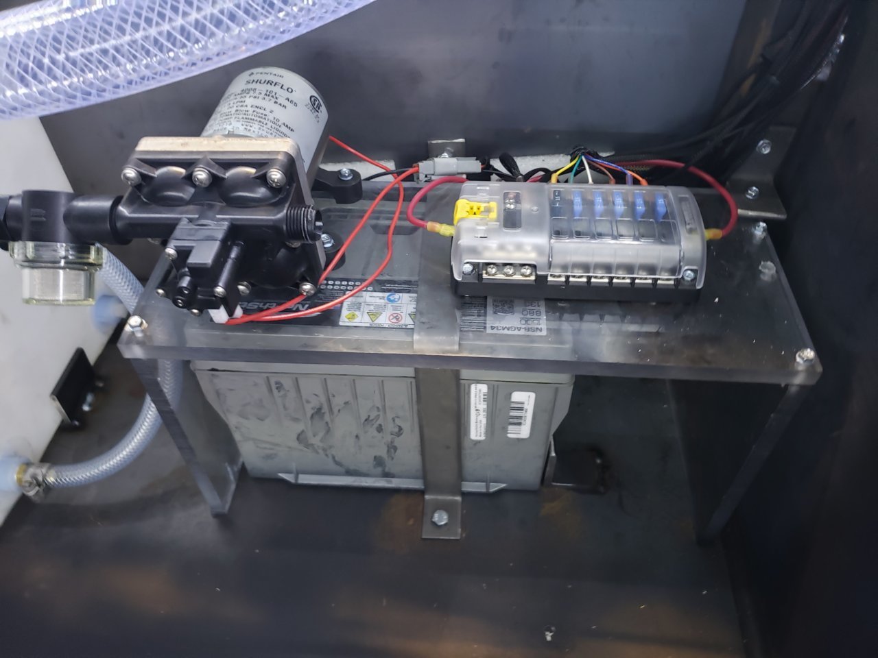

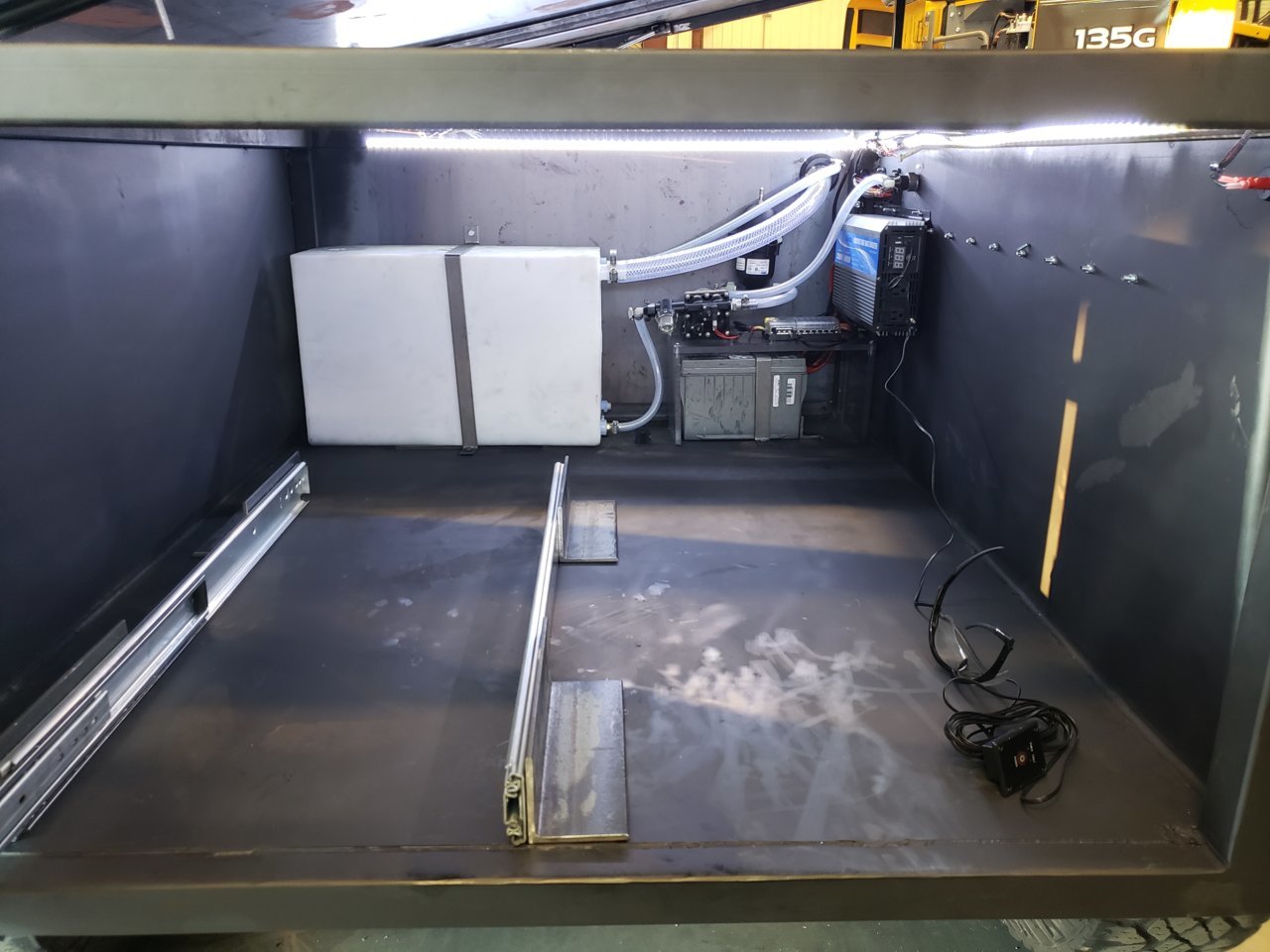

    Made trays and straps for the water tank and battery. Added leds to the inside

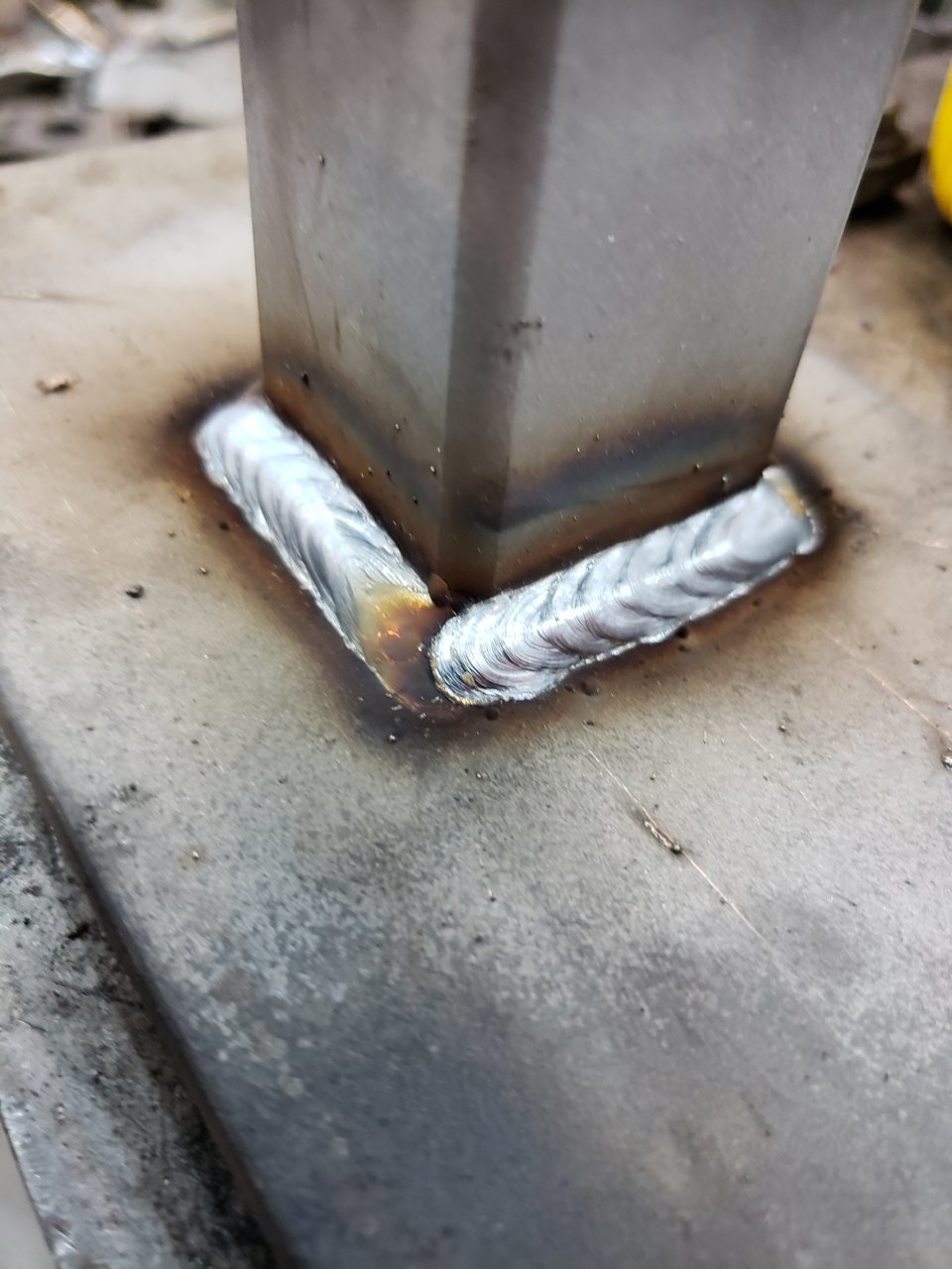

    Welded in the awning mount and few other odds and ends.

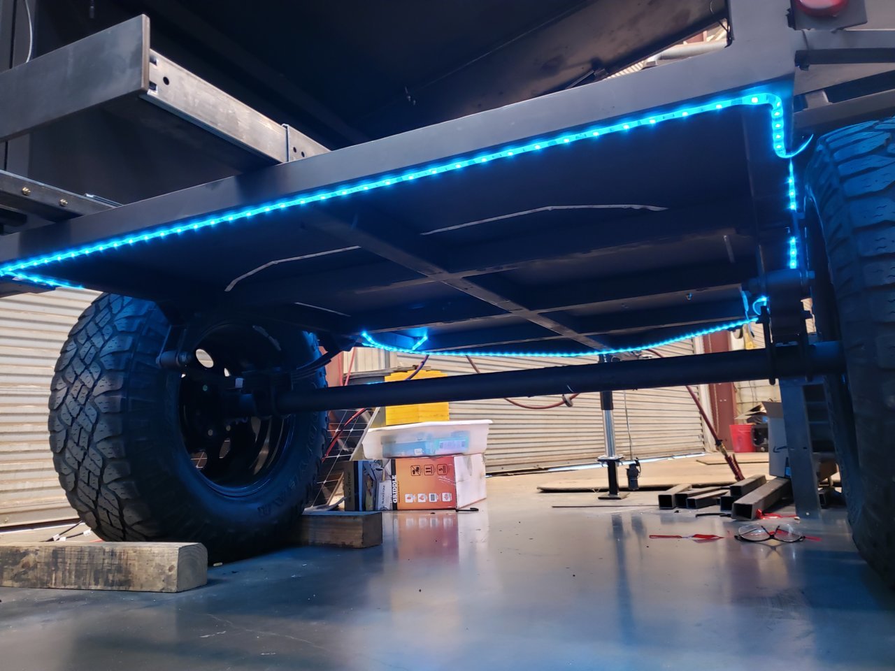

    Leds underneath

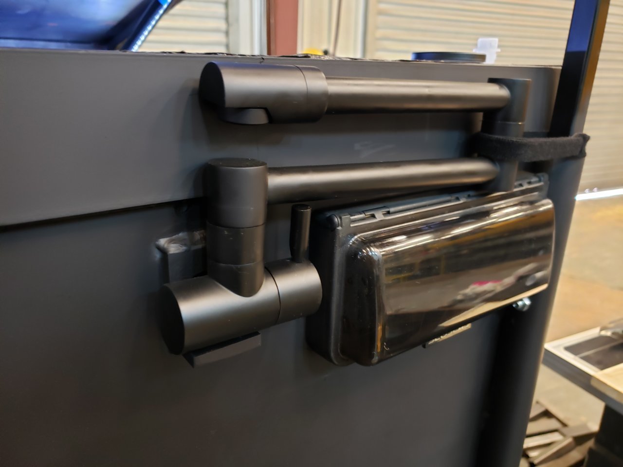

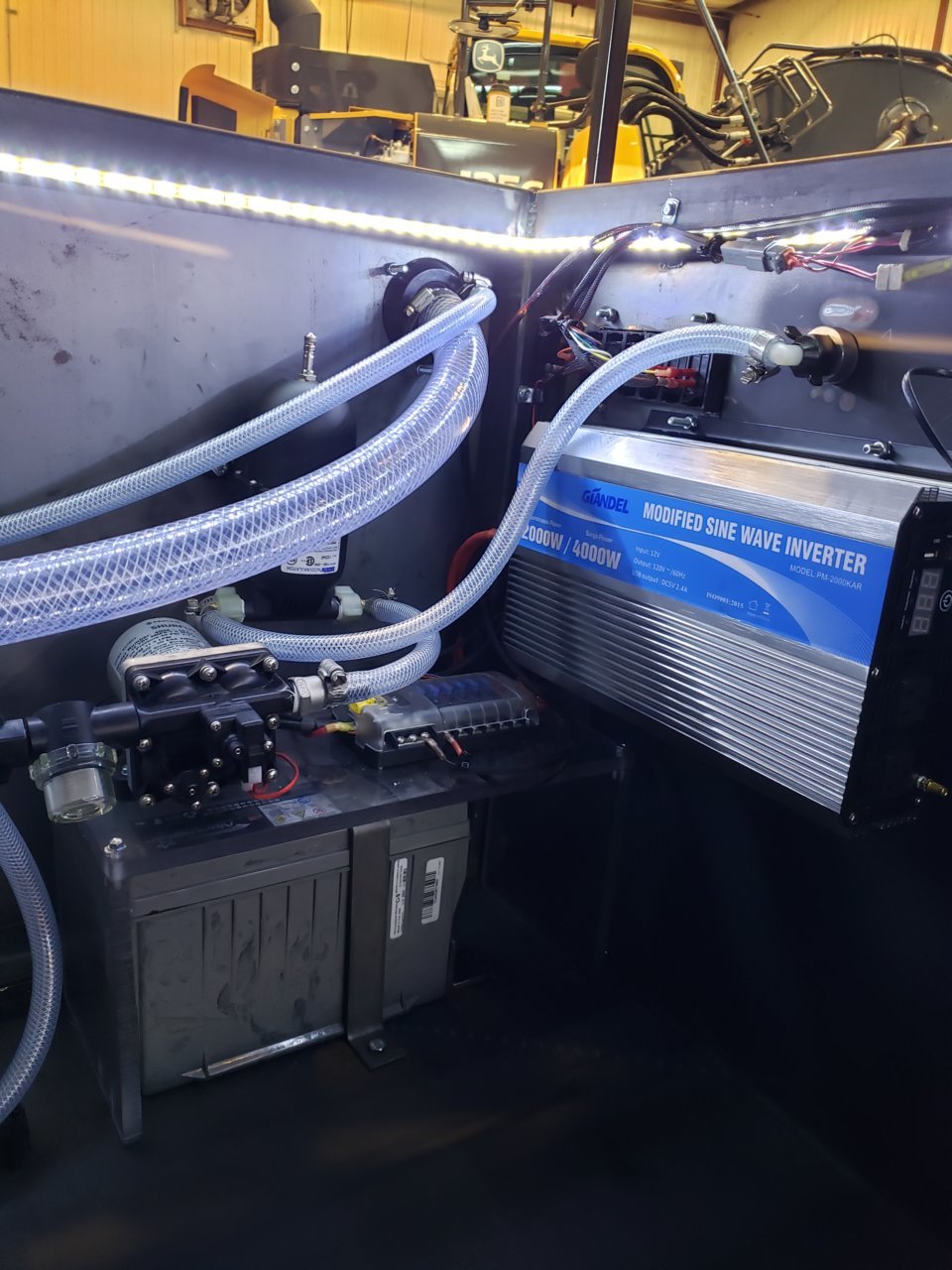

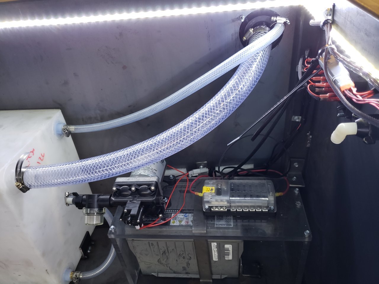

    Faucet is in and all tank connections made. I'll install the accumulator tomorrow. Caulked the all the seams.
    medic2230, tacoma16 and Rexfordian13 like this.

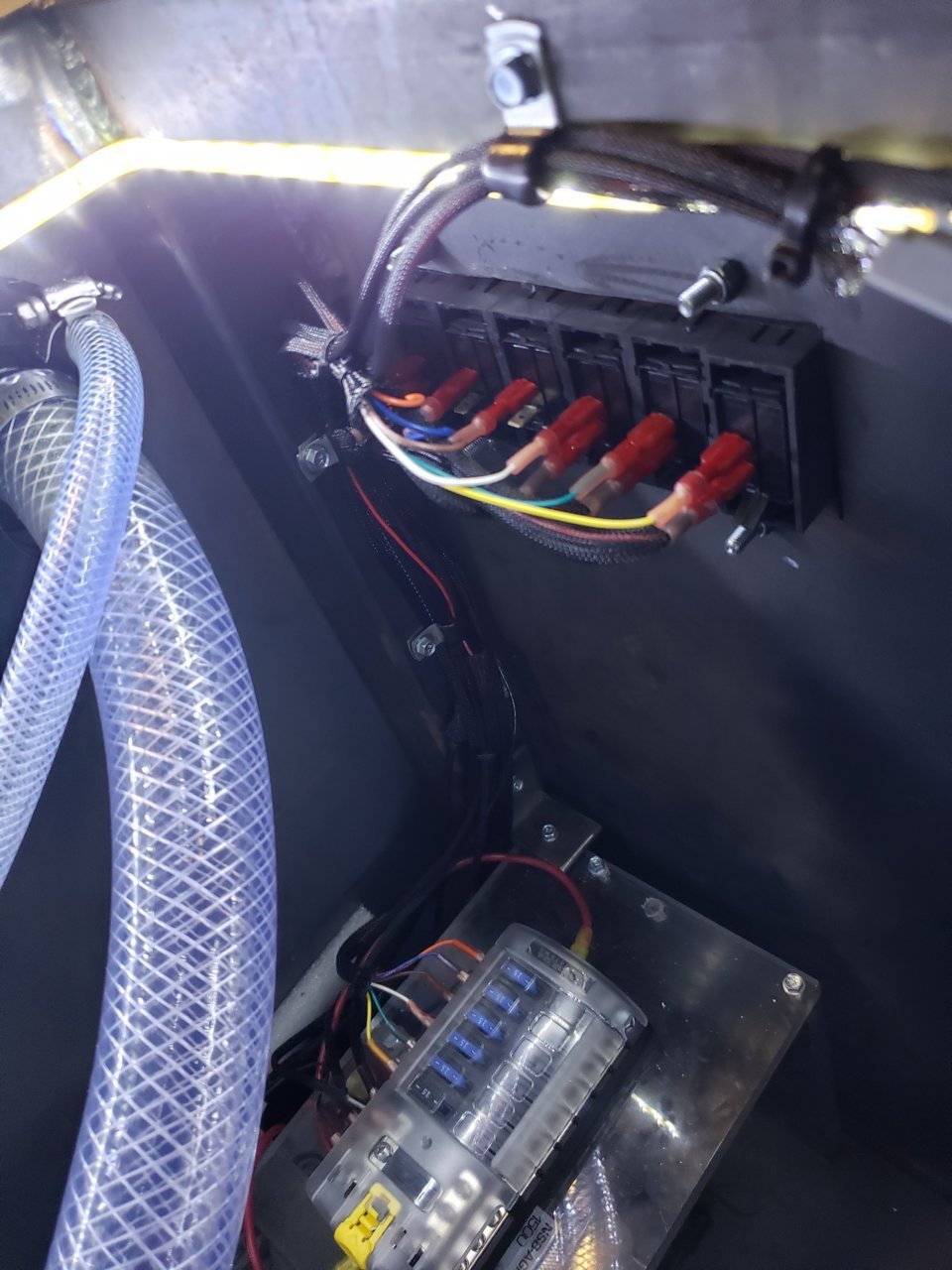

    Wiring and whatnot

    Closer and closer.
    Accumulator is in
    Water is done...well for now. Still want a hose qd in the back for sprayer
    Power is just about done. Need to get outlets more accessible from the inverter
    USB QC and voltage readout installed

    Under glow (for double the expo points!)

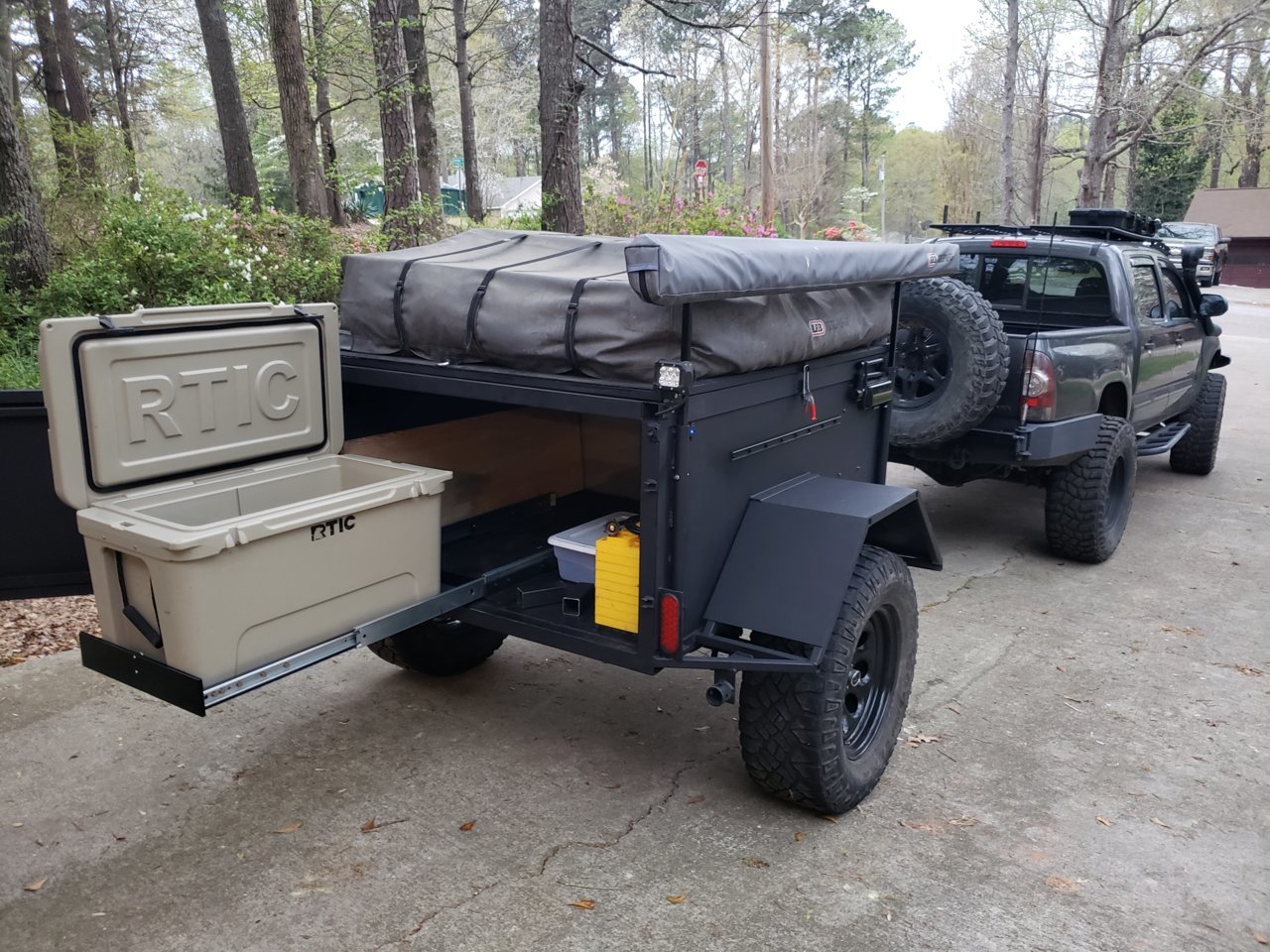

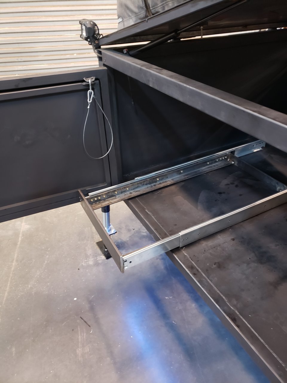

    Drawer is almost done
    And some glam

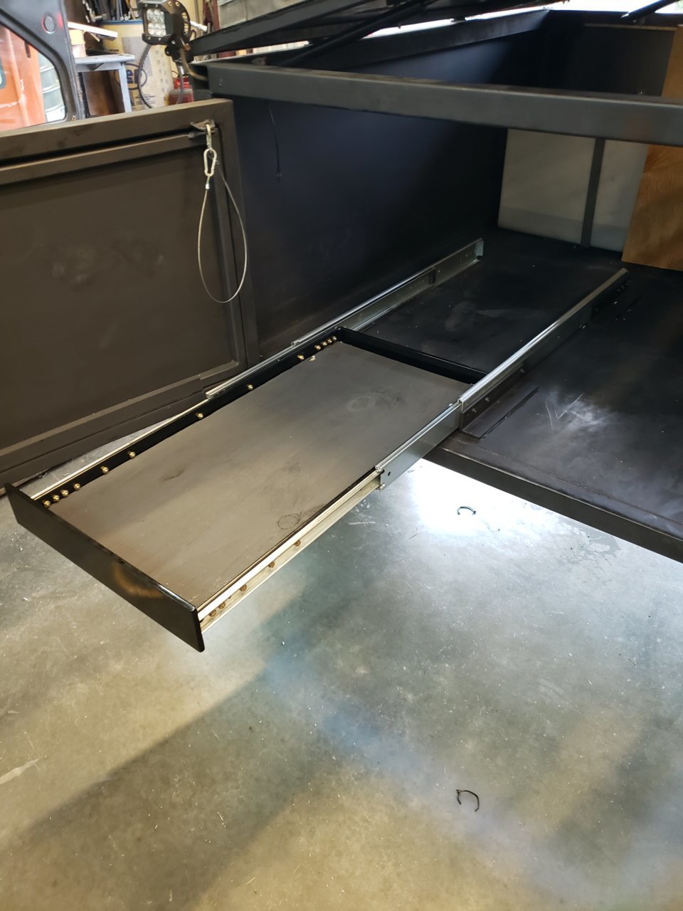

    Drawer is in and works great.
    Gonna add tie downs and a rubber stopper tomorrow.

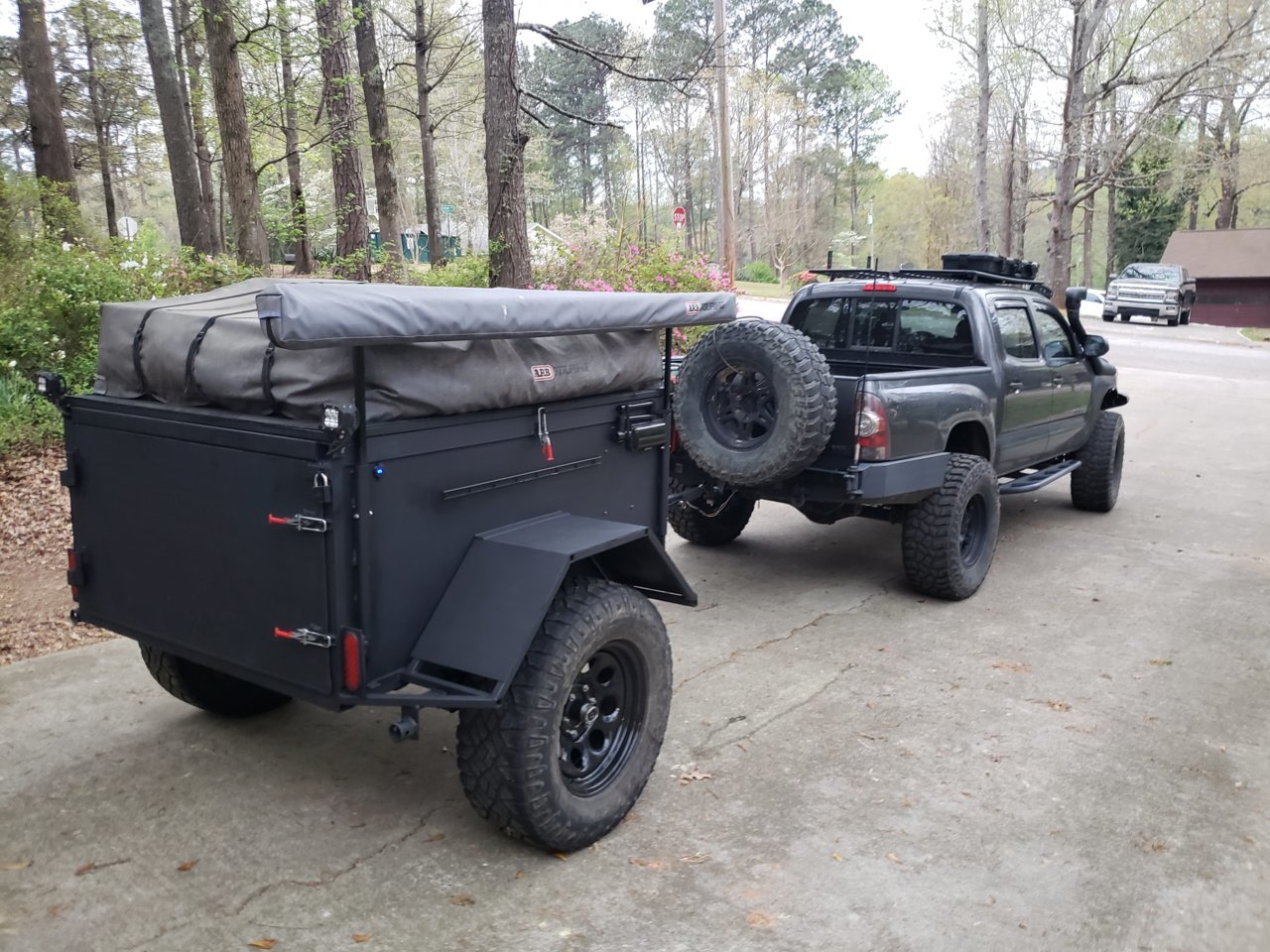

    Pulled like a champ.
    Here's to a good weekend
