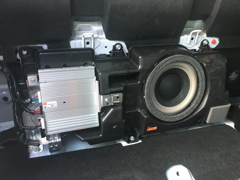

    Great thread. I replaced the deck in my 2011 double cab (w/JBL) with a Pioneer 4200 NEX. Now I've gone down the rabbit hole of looking to upgrade speakers. First, I thought I'd just upgrade the speakers and leave the JBL amp and sub alone. Nope. From what I understand replacing those two ohm JBLs in the front doors with 4 ohm will lose volume... plus that amp isn't really much of an amp anyways. 20 RMS-ish worth of power to the front and back speakers (back are 4 ohm, incidentally).
    So, that means upgrade the amp if I'm going that route. Here's my question... has anyone replaced the JBL amp with another, mounted it at that same location, and just cut the wiring harness and spliced in to existing 12 volt power and speaker leads?

    You have a lot more going into the factory amp than power and speakers. See pic

    Right, thanks. But if I knew which wire was which... I could make use of the 12 volt line, and each speaker wire out. Right? Only downside I can think of would be at some point I'd want to use better speaker wire.
    Prob couldn't make use of the existing pre-amp line in. I know the JBL does some funky things with that because it uses a single right/left channel for both front and rear and then has a different way of managing the fade adjustments. I'd want to run true front/rear feeds from my deck.
    Replacing the factory speakers is easy if I'm not running new speaker wire. But to keep that amp means you I wouldn't t get better sound by just replacing speakers... so why bother. So I thought, well, is there an easy way to swap that amp for one that would work? Can I spent a moderate amount of money for new speakers, an amp, and get a bit of improvement on my sound quality without rewiring everything? Maybe. Not sure.
    Def plenty of arguments though for not reusing existing wires. Just wondered if anyone had done that.

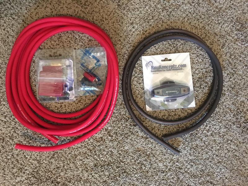

    Just received a care package from KnuKoncepts today. This is about 99% of whats left to complete the wiring for my audio build. For under $50 I got 17' of power cable, 4' of ground cable (both 4 ga), fuse holder with 150A fuse, battery post adapter and terminal, and 2 wire terminals. Last on the list is RCA cables. Anyone have recommendations? P.S. I need them to be 3' or shorter in length
