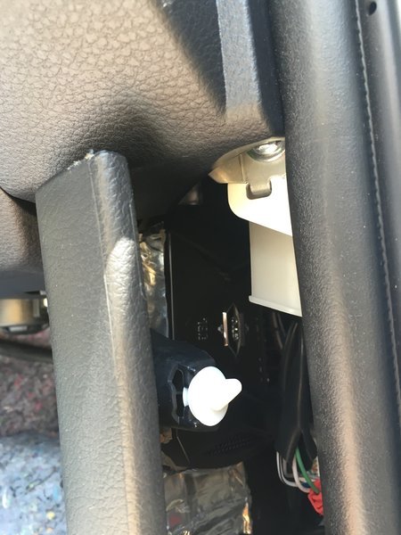

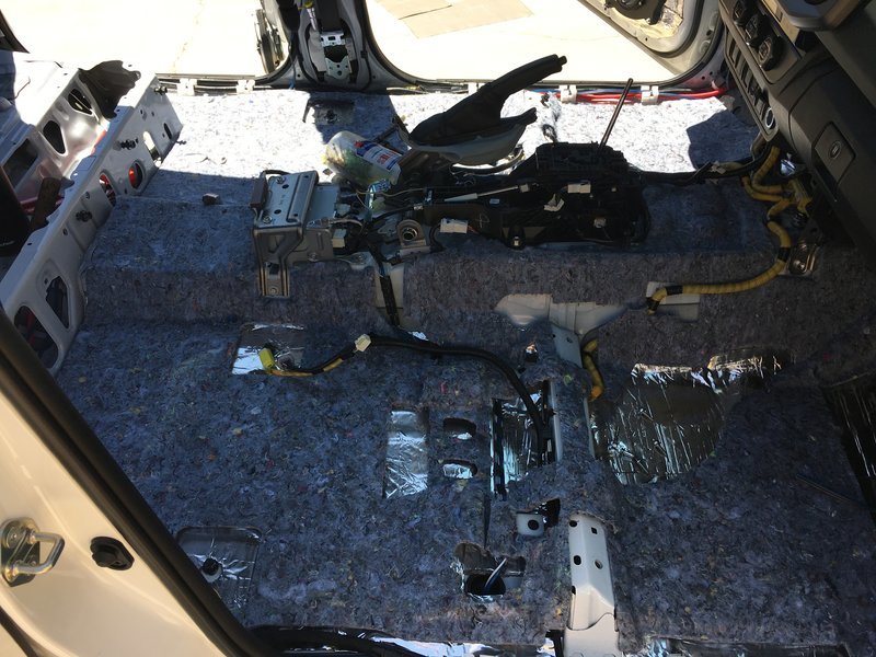

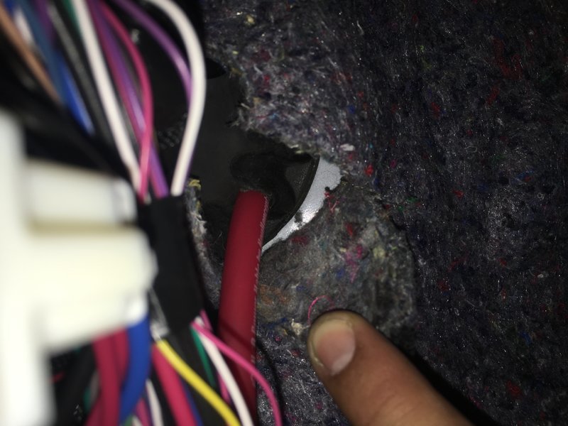

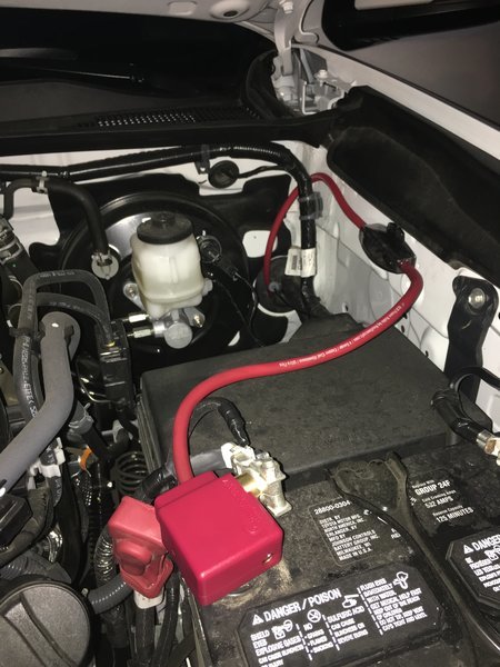

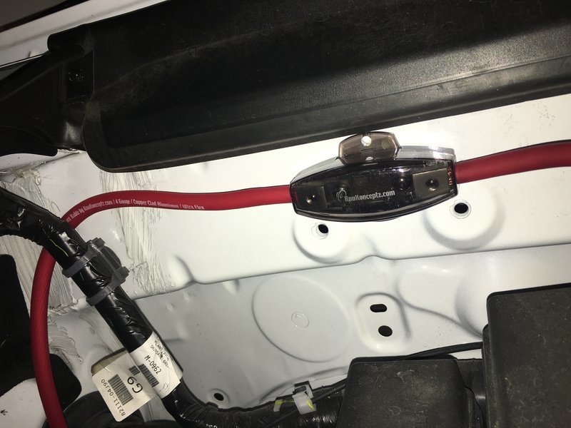

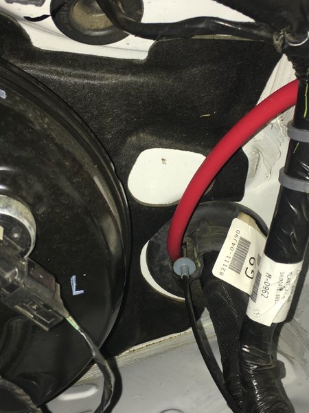

    So this is all that I tackled yesterday. Final stage of my complete stereo upgrade. I started from the front and worked my way to the back. First I ran my 4ga power wire through the driver side grommet and pulled the excess into the cab. I added the fuse holder and used 3m double sided tape to hold it on the inside of the fender. The power cable is then ran to the KnuKoncepts Ultimate Battery Post.

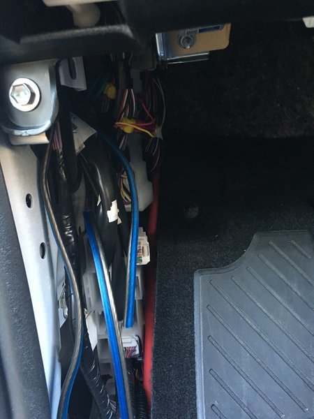

    Inside the cab I started to remove the whole interior and I do mean whole. The center console was easy. 2 bolts inside the storage bin unscrew and you can lift it up after you remove the shift knob. Then you unplug the 12v power accessory wire and I want to say the gear selector light plug? as well. It all lifts up then the 2nd part has 3 screws holding that in. Seats are self explanatory, front seats have 3 plugs to disconnect on each. Rear seats come out next then storage bin under the bench.
    Finally the storage bins behind the seat are removed to expose the stock JBL amp and sub. Disconnect 4 plugs and unscrew the box and it's out.

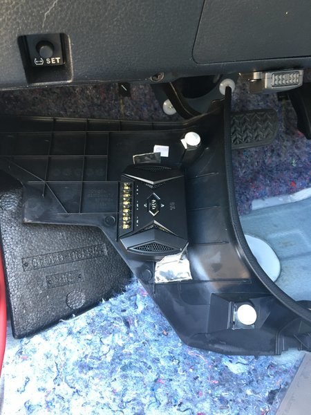

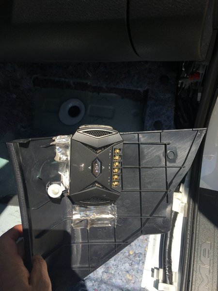

    I looked for a space to mount my JBL crossovers. Being that they are quite large I couldn't fit them under the center console. I've read that you want to keep them as close to the component speakers as possible so this was my solution: the front kick panels. I had to make sure they fit with all the other wires going on in there and it worked. One side is mounted higher than the other for clearance issues. I used double sided tape and RAAMmat to secure them.
