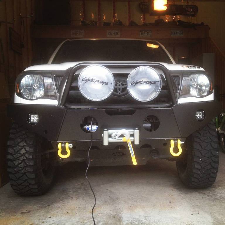

    Installed a superwinch lp10000

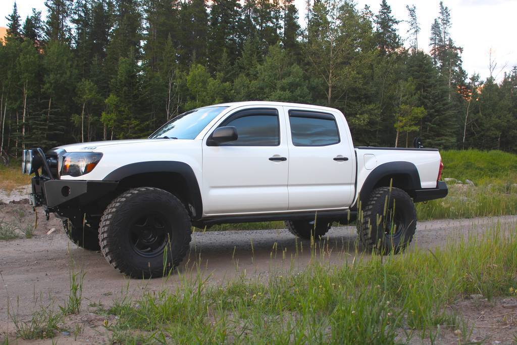

    Aside from the cab mount chop and the fender flare trimming, what else did you need to do to clear 35's?
    Loving this pic! Pretty much my inspiration, stance-wise!
  18. Feb 4, 2015 at 6:06 PM
    #58
    snorola
    snorola [OP] Well-Known Member
    Jul 28, 2009
    #20292
    566
    Brett
    Canmore Alberta
    06 4x4 Dbl Cab
    SAW 2.0 Coilovers Eibach 14" 650lb springs Camburg UCA's All pro expo springs OME rear shocks All pro front bumper All pro IFS skid All pro sliders SCS f5 matt black rims Lightforce blitz 240's
    Thanks!
    The rear seems to be fine, wheels have 4.5" backspace and just tuck
    The front cut cab mount a lot, there isn't much left!
    Beat pinch weld flat (had to seal it up as it started leaking)
    Beat firewall back
    1" wheel spacers
    Cut metal fenders (2.5") and plastic fender flares (2")
    Made some new wheel well liners
    Got an alignment to push my wheels forward
    Still rubs a tiny amount every now and then so could probably use so more sledge hammer in there but it doesn't bother me too much.
