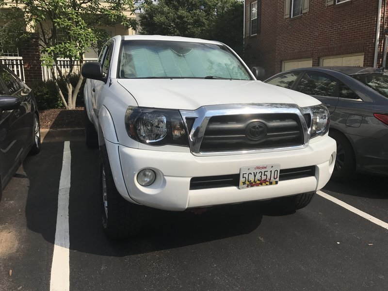

    Those headlights turned out good

    Thanks man! He's coming along.

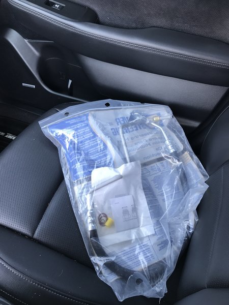

    Alright, finally got everything done (for today). This morning I replaced the high pressure hose for the power steering, replaced the front diff oil, and greased all the U joints. There was a lot of gunk on the diff drain plug! Also replaced the antenna with a cheap short one on Amazon. I'm not worried about reception with it.

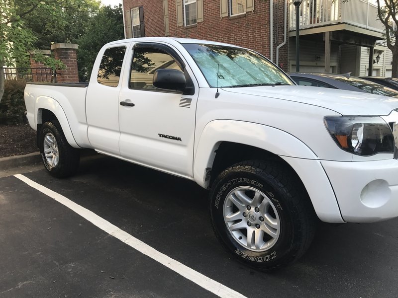

    Got a surprise in the mail! Added these little flags and threw some tire dressing on there.

    Damn she looks so clean. Great looking truck. You will have her running like a top in no time
