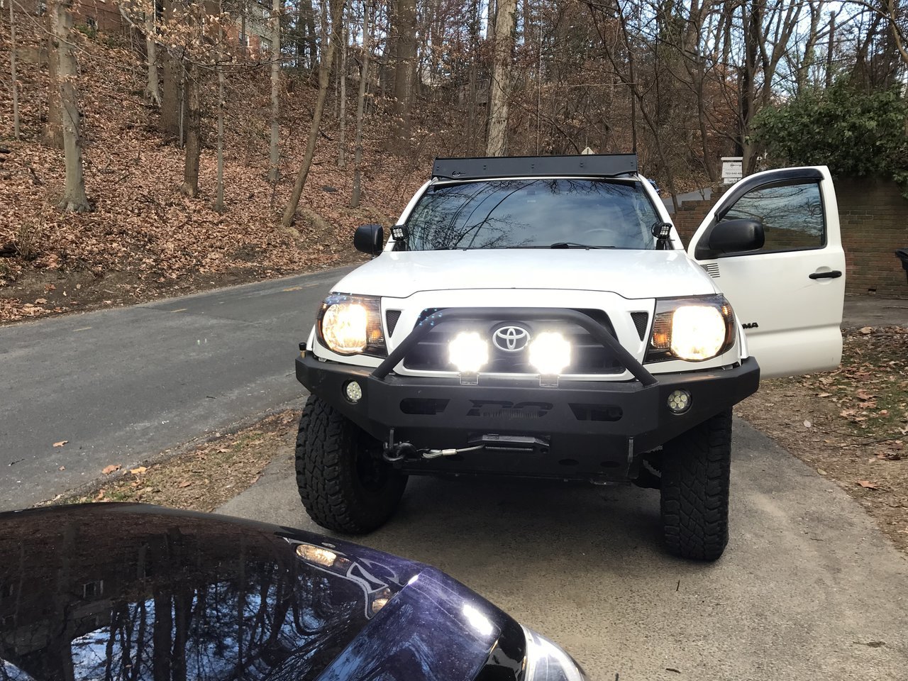

    Nice job with the wiring! How'd you do that?

    I had a wiring harness left over from something else, so I chopped it up to work for what I wanted.
    The way I have it come on with my high beams is with an add a circuit tapped into the high beam fuse under the hood. That triggers pin 86 on the relay to tell it to close and turn the lights on.

    Got damn these lights are bright! They’re more of a flood pattern, so I’m going to angle them outwards a little bit to help light up everything better. They’re perfect for any slow speed night wheeling I may do.
