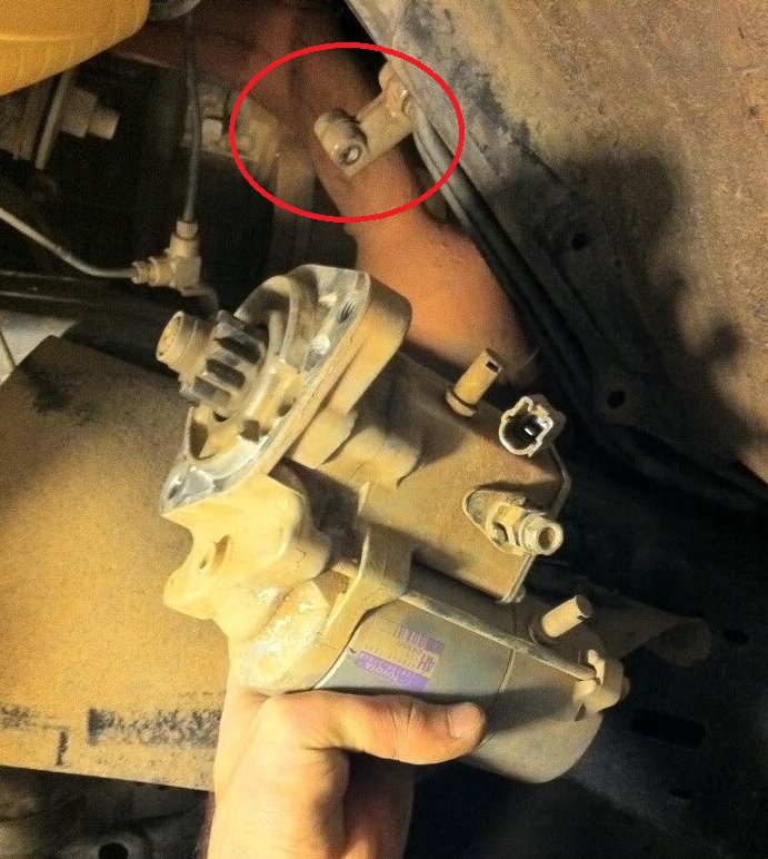

    Now that the weather is getting cold, my truck is deciding to show all the fun things that could use fixing. I went to start it after work the other morning (was about 5 degrees) and it sounded like the starter spun up, but the truck didn't crank. Did it again and it fired right up. Since then, it's done it a couple more times after it's been sitting a bit and is cold.
    After doing some digging, I learned that our starters have two stages. The starter first pushes it's gear onto the engine flywheel assembly and once it's engaged and the gear teeth mesh up, THEN the motor starts to turn. My starter has been pushing the little gear out, but not cranking the engine over on the first try. Maybe some water got in and it's freezing? Anyways, when I get a warm day I plan on pulling the starter, disassembling it and cleaning out the contacts to ensure a good connection.

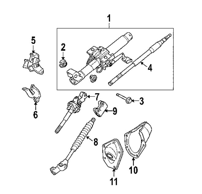

    While I'm at it I'll replace my intermediate shaft, since it will need to be removed to remove the starter. I can move my steering wheel back and forth 2" on the highway without it engaging, and this should fix that slop. It's #8 on this diagram.

    You have to remove the steering shaft to get the starter out? Crossing my fingers that I get a few more years out of my starter...lol

    I don't think you HAVE to, but it will make it a lot easier if you're trying to get it out through the drivers side wheel well. I think you can drop the skid and take it down that way, but I'm not sure! Either way, removing the steering shaft isn't hard. I had to remove it when I changed my rack and pinion.
    EDIT: JK I think you have to. You can see it out in this pic from that thread.

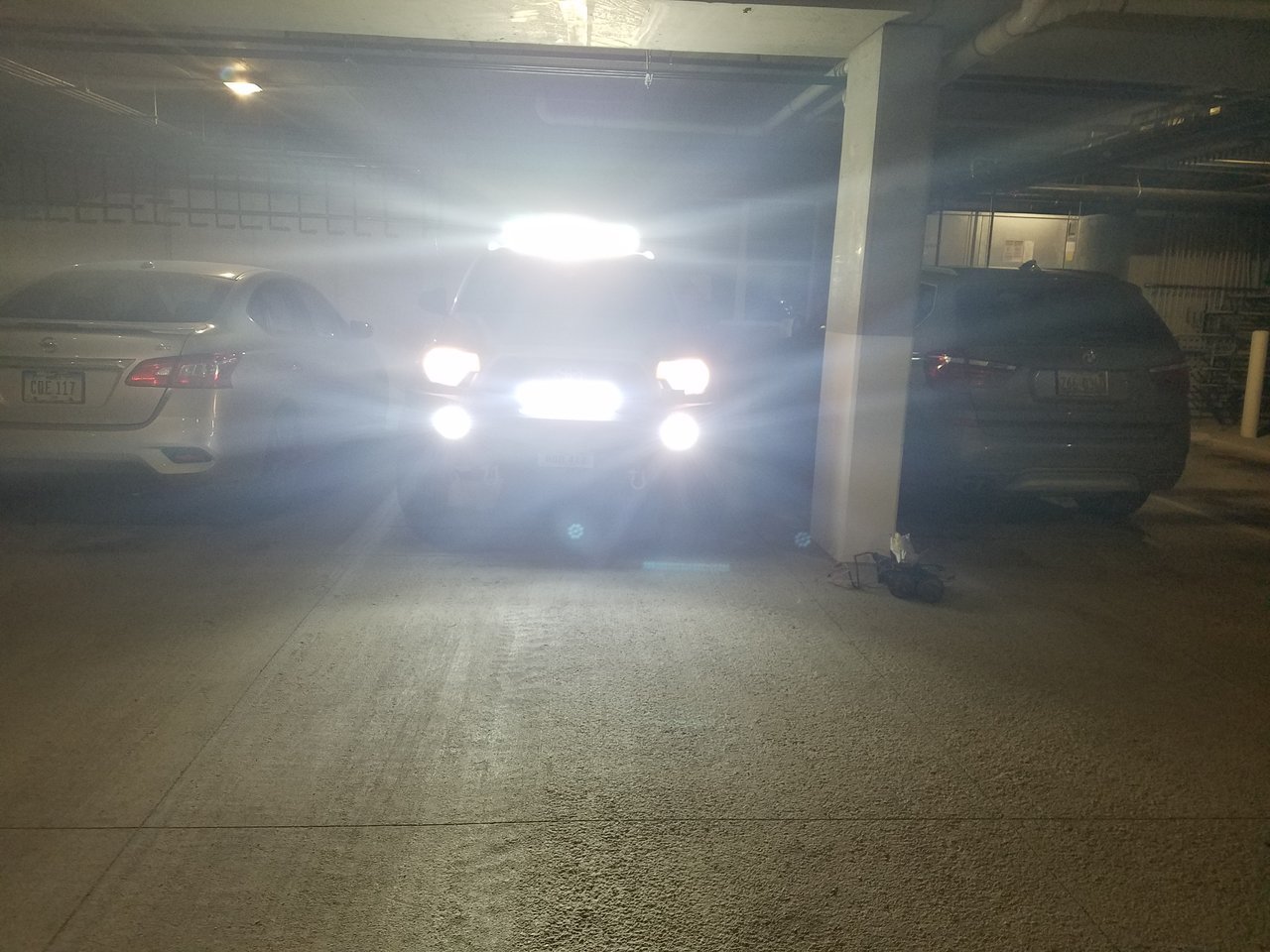

    If it is the other drivers paint you can probably remove it with some mineral spirits on a micro fiber. Then just throw some wax on it.

    I still see shadow. Maybe some ditch lights will fill that in.

    I'm waiting on some ditch lights.... @Justanotherhemi :boink:

    Looking good CoCo! You do have a gap between the roof light bar and the bumper. Those ditch lights should take care of the issue
