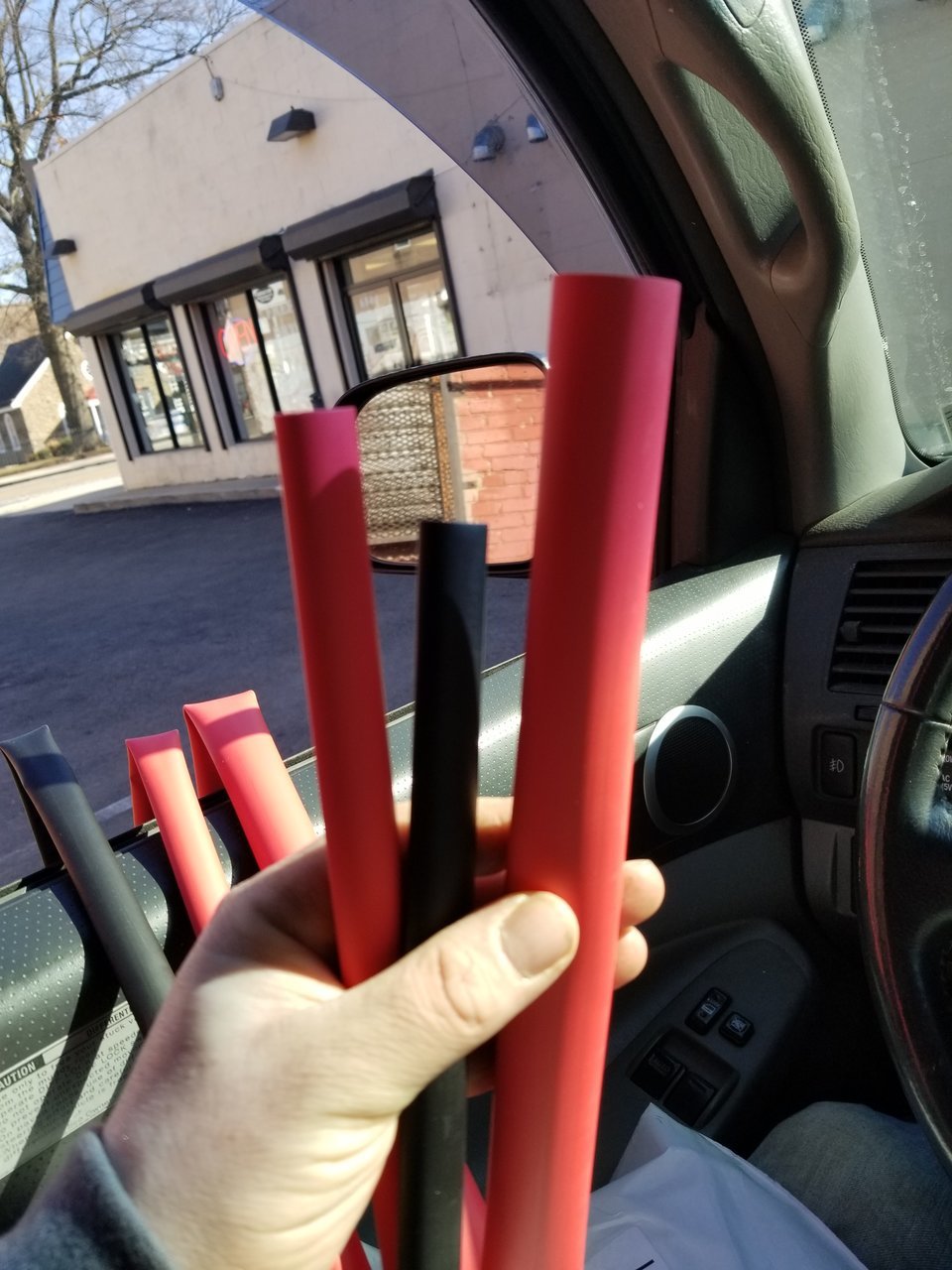

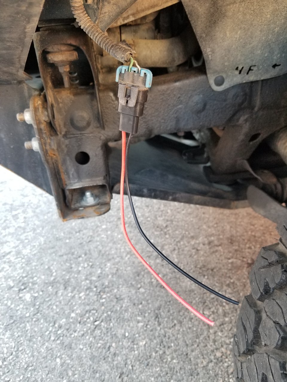

    Ready to make my soft shackles and winch extension out of my old winch line. Also, got those female foglight connectors. Seems I'm accumulating parts and will have a lot to do when the weather changes a bit. Soon I'll have those coilovers and then just need to get UCAs, longer brake lines, and maybe do something for the rear suspension. Currently TSB leafs with AAL and 5100s

    What do you need longer brake lines for? They're not needed in the front with the OME set up.
    EDIT: also is that heat shrink? That looks oddly satisfying being that long

    Yeah the heat shrink is 3 feet long and is lined with adhesive. Not gonna lie, a smile creeped across my face when I pulled it out if the packaging.
