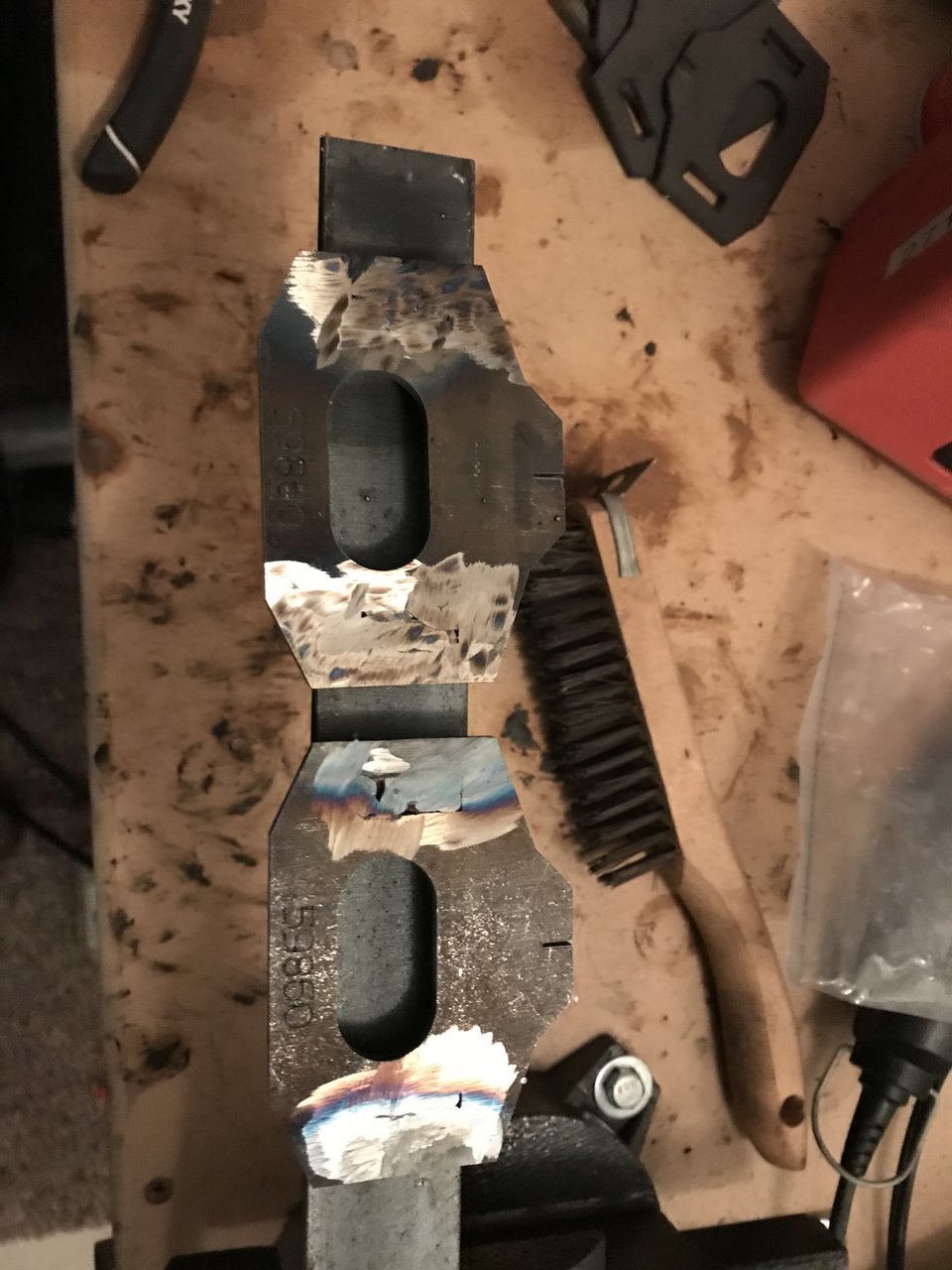

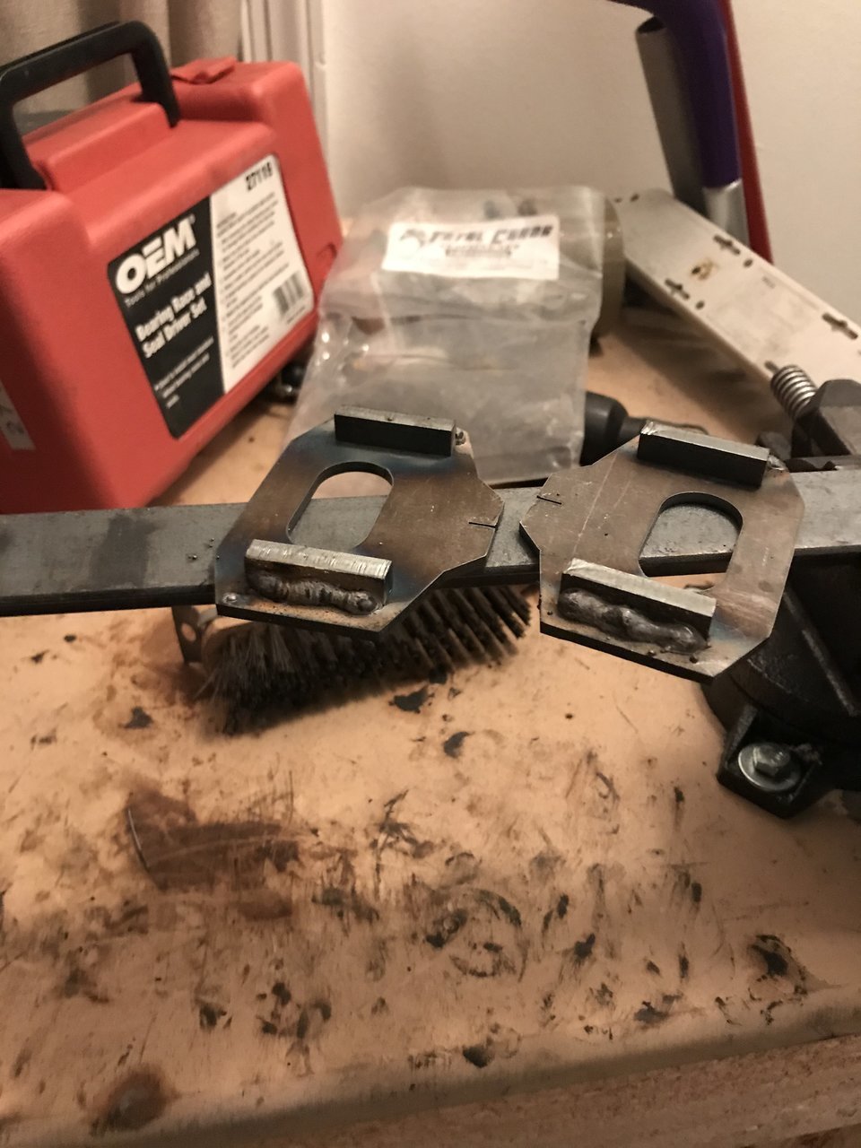

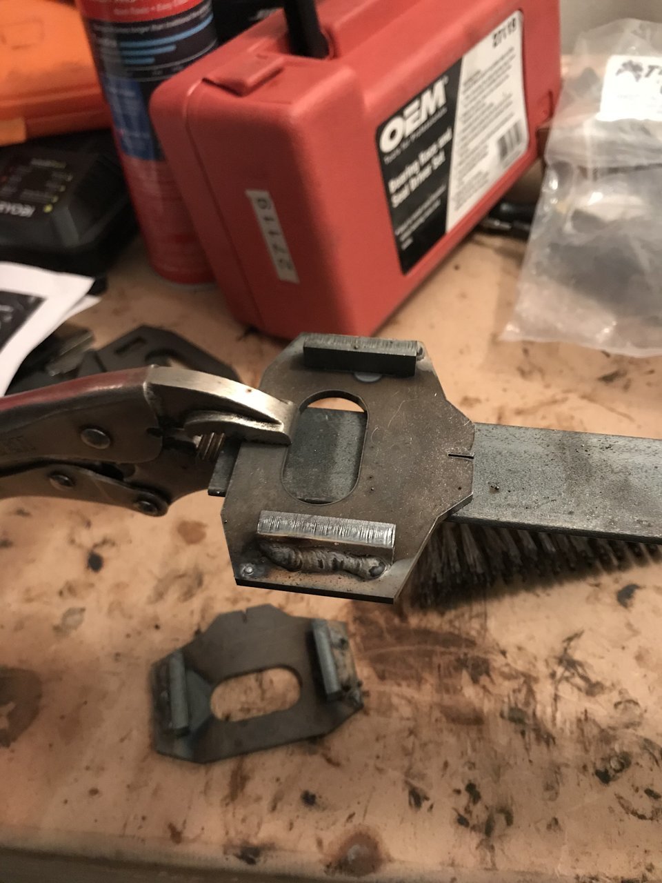

    Decided to practice welding tonight on my total chaos cam tab gussets. I was gonna have someone else do it, but then why the hell did I buy a welder anyways?! They’re not pretty but they seem strong enough. Two out of eight completed.

    Nothing better than fabbing our own! Your beads seems to be good! To be sure, you could get a hammer and hit the welded part. If it falls off, the weld is not good, if it bends, its good:rofl:Of course I am not a pro, but it may look like the bottom of your welds need more fusion. How thick is the steel? Maybe turn up the heat a little more?

    That’s what mobtown joe was saying! Clean the steel better, slower wire speed, higher amps and go slower. Only thing is I can’t really go higher amperage because I just checked and it’s only a 15 amp circuit.

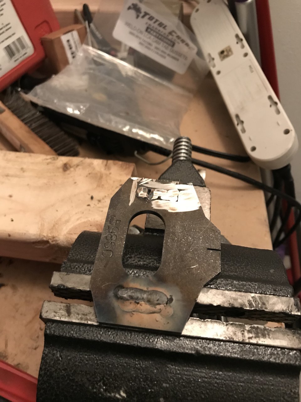

    It was on the table, of course. I walked back upstairs just to grab it! I’m not about to burn my house down. You can see it back here behind the red box.
