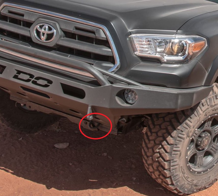

    I don’t know what a “soft shackle loop” looks like. If you’re welding anyway, why not just put D-Ring mounts on that work fine with soft shackles?

    i mount the soft shackle anywhere it is acceptable, i didnt know there were specific loop designs for armor?

    Think like this, but stronger. Just rounded edges to be less abrasive than traditional recovery points. I had this same question the other day.

    Looks like a solution to a problem that doesn’t exist to me :notsure:

    Yeah like a hoop type deal rather than a hole in a plate. The edges of a hole in a plate are more conducive to tearing into a soft shackle

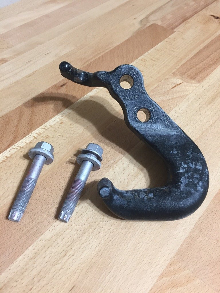

    oh, i attach mine to the oem offroad tow hook all the time or loop them through my rear d ring mounts, all of my soft shackles are in a sheath
