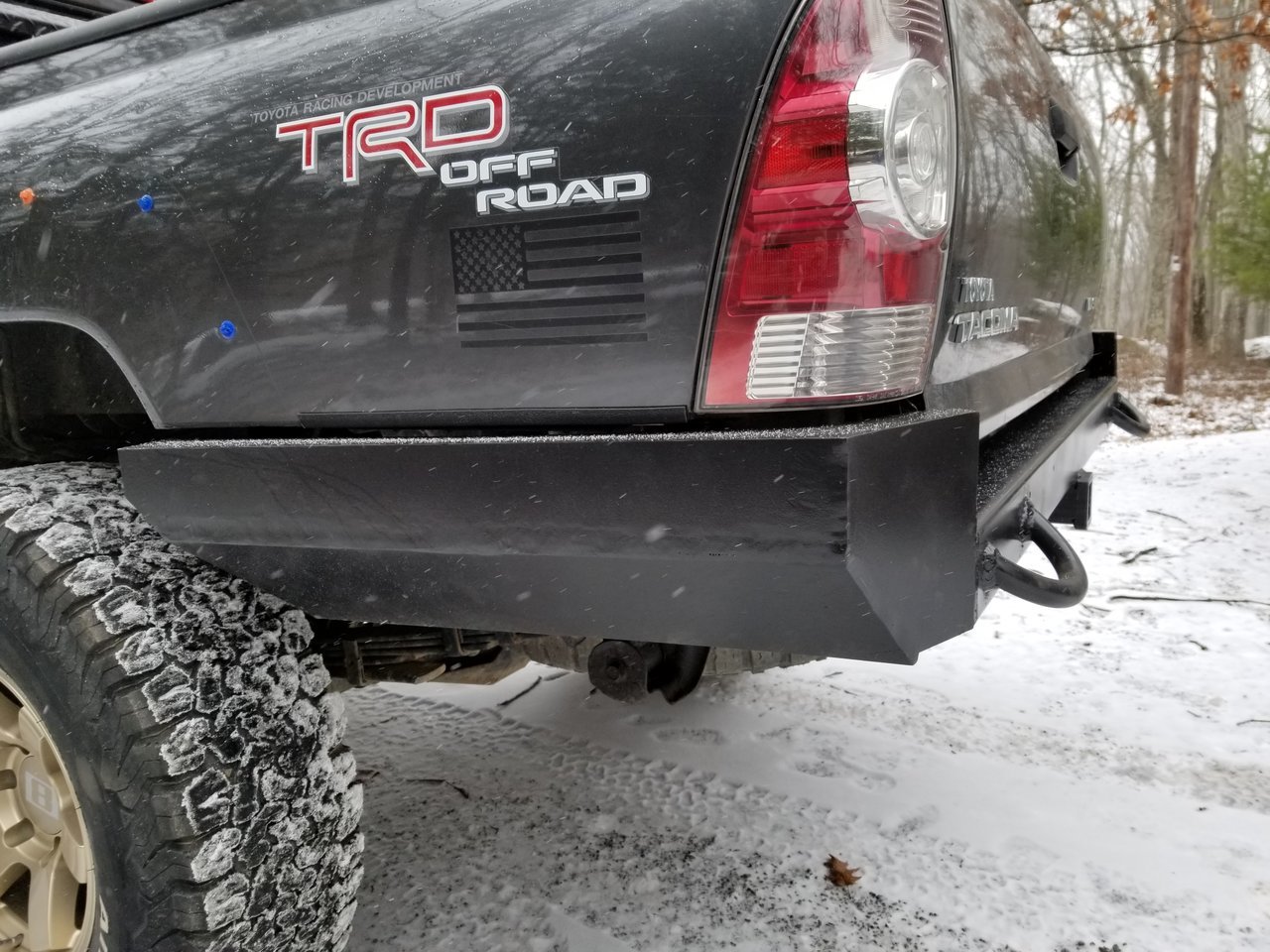

    Watch out for your fingers..

    That's the plan! I just ordered the edge trim. Found what looks like the same stuff as trail toys but bit cheaper. Gonna have it all ready to go so the bumper can be dropped right in.

    Lay a stright edge across the bed rails, measure down from that. Mine ended up being 17 1/2" down iirc.

    Since I'm about that cap life I'm gonna have to measure from the edge of the cap on down. That's what Joe and I were discussing today. I'd rather be a hair off than deal with taking the cap off.
    That's a great idea actually!

    I'm not sure where it ended up being. All i know is that its RIGHT at the bottom edge of the taillight.
    Edit, in that pic the edge trim hangs lower than the body edge

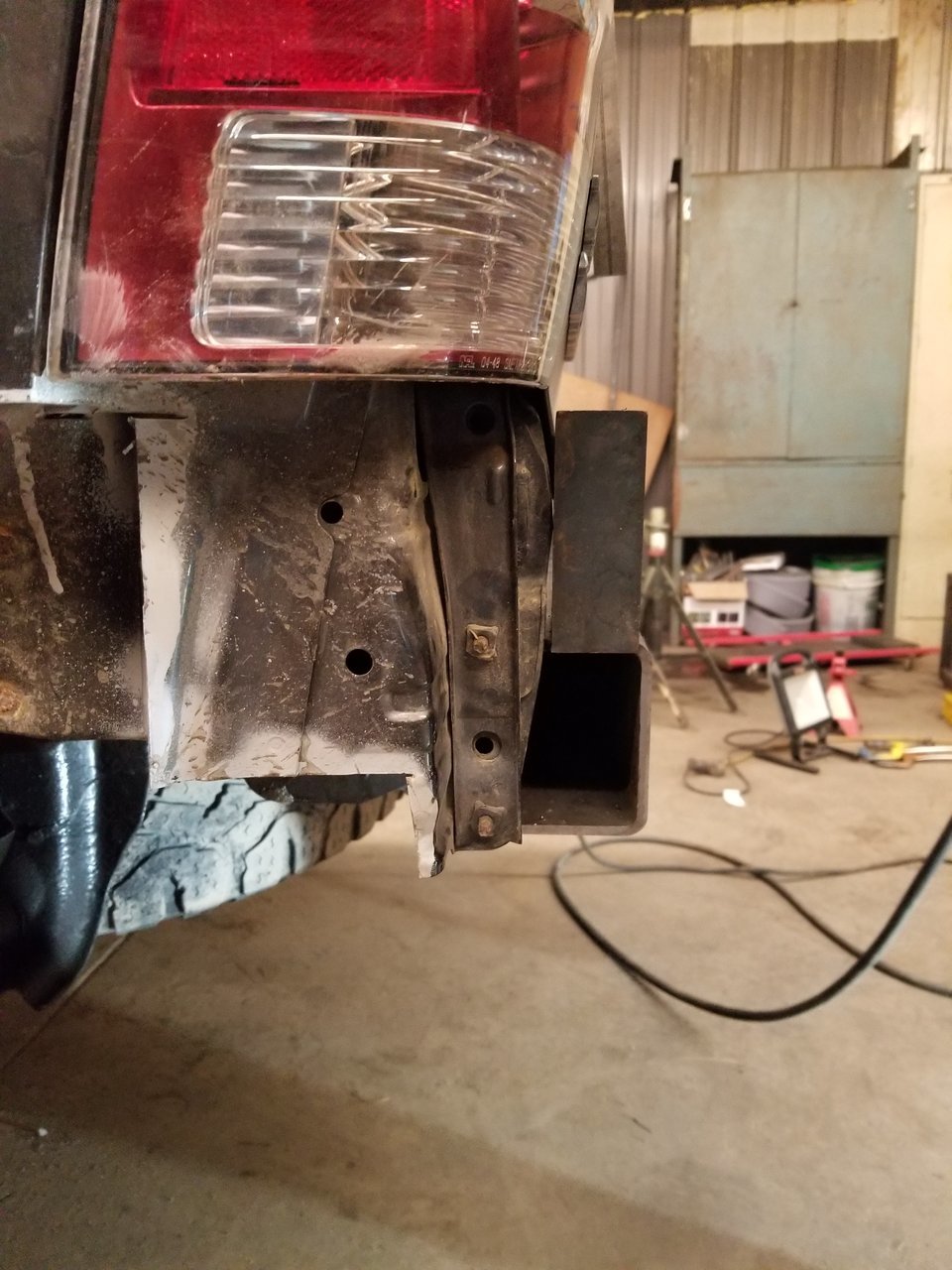

    You'll probably need to reference this picture too. It is what to cut under the OEM bumper and under the taillght. You can see the primered areas.
