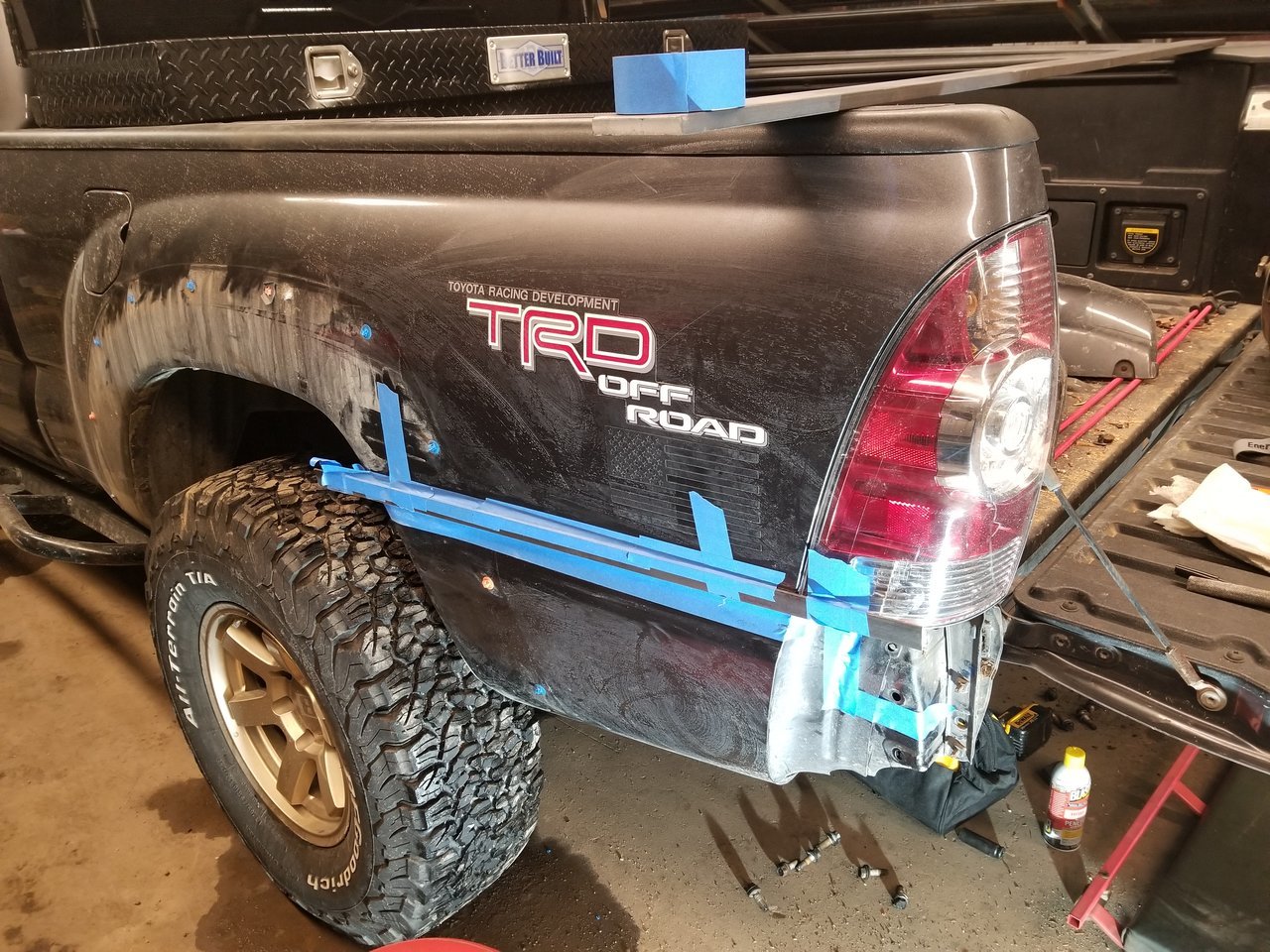

    I think the tape is there just for paint protection. I have a cut line marked inside of it.
    Remember, its been almost 2 years since I made the cut

    One thing I do wish, is that I left my flare on. Its difficult to get the same cut line if you take it off.
    The cut off disc is deep enough to do both. Or at lease to score the bed side where you already cut the flare

    :thumbsup: Did you coat the exposed panel with anything? Por15 bedliner ect to prevent rust?

    Didn't want to fuck up a ruler with the grinder, so we used some scrap metal that was flexy. Obviously i took the flares off. They are still off :anonymous:

    Did the metal stay in place throughout the entire cut?

    It did. The grinder ran along the bottom edge of it. It was a pain to tape it in place though.
