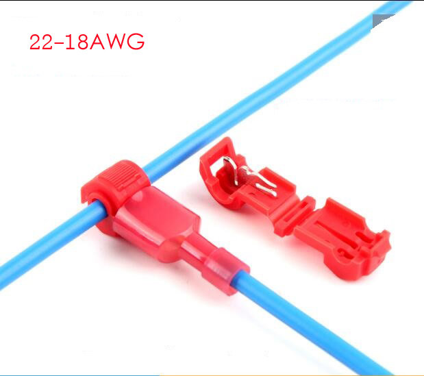

    I am going to the auto parts store to get new wipers for my Taco. I want to pick up the easy slice, female connector & wire for the FL anytime mod. What gauge wire do you recommend?

    I'd pick up small wire, like 18 or 20 gauge and get the appropriate fittings for that size (they're generally the red ones). So far this is my favorite wire tap of the various types

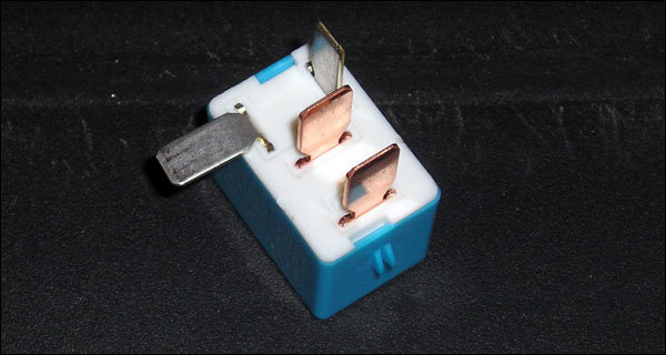

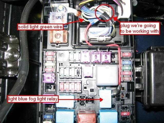

    How did you connect it to the relay? Is this what you meant by you just stuffed the wire and pressed the relay in?

    On mine I was lazy and didn't use a wire tap. I just shoved exposed wires into the green wire plug and taped it up. A wire tap is much better.
    Create a small wire, maybe 10" in length and put a female tip on each end. Connect one end to the bent relay, and the other to the wire tap (on the green wire).
