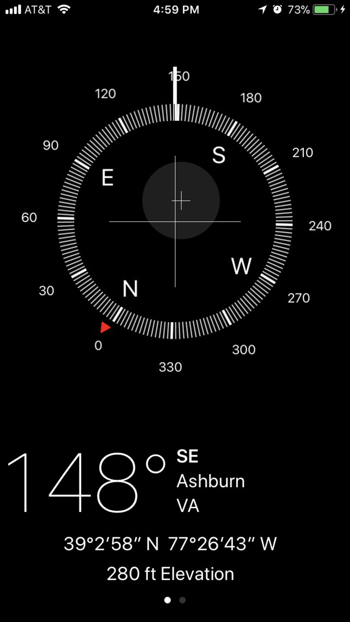

    Just notice my 6 does the same lol before the update I didn't had the coordinates

    cool! I didnt know it was on previous models. Maybe it is in the recent update

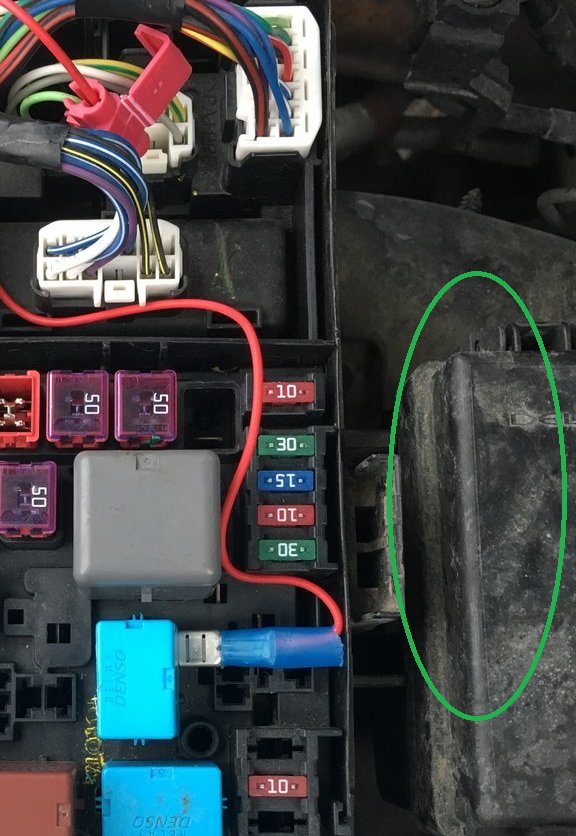

    @EatSleepTacos
    I just did this and not luck. Did i miss something?

    What's the point of it? Like, what does that extra wire on the bent relay tab supposed to do? You have a wiring diagram? Post one if you do, I'll see what I can see

    Double check you're tapping into the right relay. On Stewie it was in a different location, in that small black box to the right.
    EDIT: Also you have to squeeze the wire tap shut to make the final connection.

    The idea is to supply a regular switched 12v to pin 86 on the relay so you can turn the fogs on whenever.

    Why do the fogs go off when the parking lights or high beams are on?

    Yeah, the fogs will only come on with the headlights. And when the high beams come on, fogs go off.

    You were right on the money homie!

    So you got it working?!
