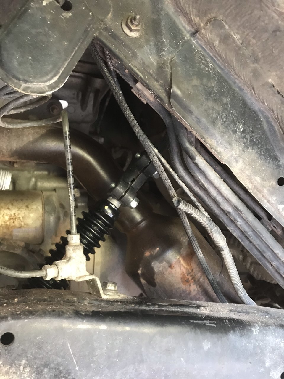

    Intermediate Steering Shaft Replacement

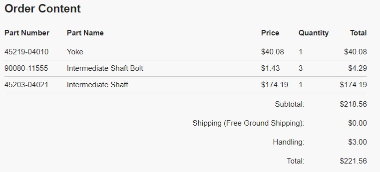

    Today I replaced my intermediate steering shaft and the yoke. The yoke would normally not need to be replaced, but I was concerned that I had messed up the threads on mine when changing my rack and pinion, so I ordered a new one. Turns out I didn't need one so I'm going to sell my OEM one for a few bucks.
    Anyways, here are the part numbers for everything, including the bolts.

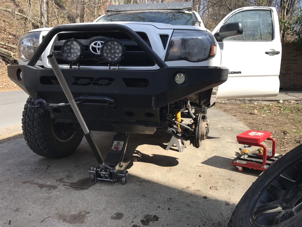

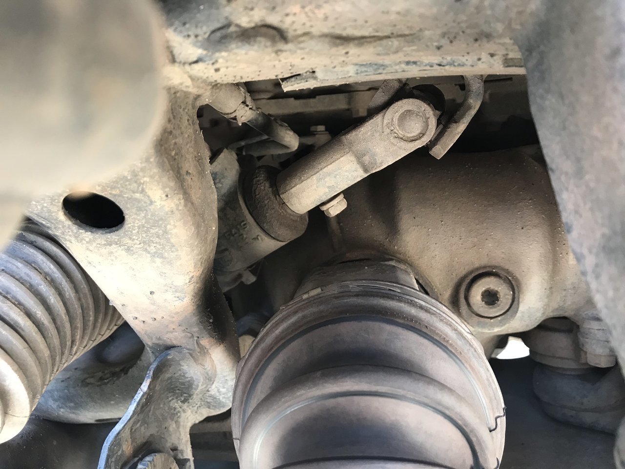

    The first step is to get the drivers side wheel off as well as the inner fender splash guard to expose the u joint. Place a jack stand under the drivers side frame, but leave the front of the truck jacked up. This will allow you to turn your steering wheel with no resistance since the weight of the truck is off the tires.

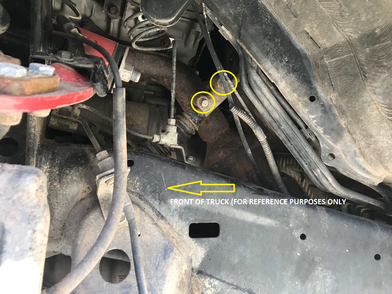

    Turn the steering wheel so that these two bolts are facing outwards. Use a 12mm ratchet or impact to break them free. My weapon of choice is my impact with my swiveling sockets. A normal socket won't work.
    Next turn the steering wheel so that the bottom bolt on the u joint is facing outwards, and completely remove the bolt.

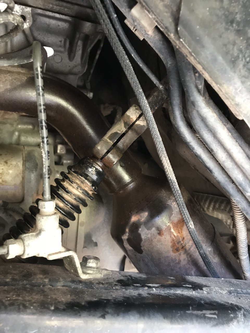

    Next turn the steering wheel back so that the gap on the yoke is facing you.

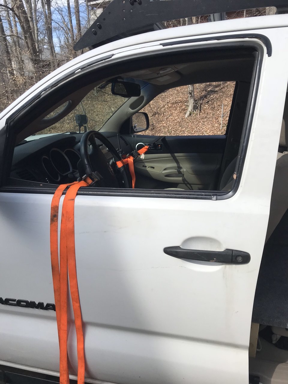

    Now we want to secure everything so that it doesn't move upon removal. This way when you put the new one in, your steering wheel will still be straight. Lower the truck so that the full weight is resting on the jack stand and passenger tire.
    Next use ratchet straps to secure your steering wheel. I tried a few different combinations, but I found going horizontally out kept it the most secure.

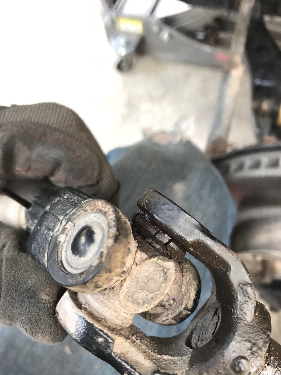

    Once you have that tightened down, grab a flat head screwdriver and a dead blow hammer. Work your way up and down the yoke by hammering the screwdriver in. This spreads it apart and makes removal possible.

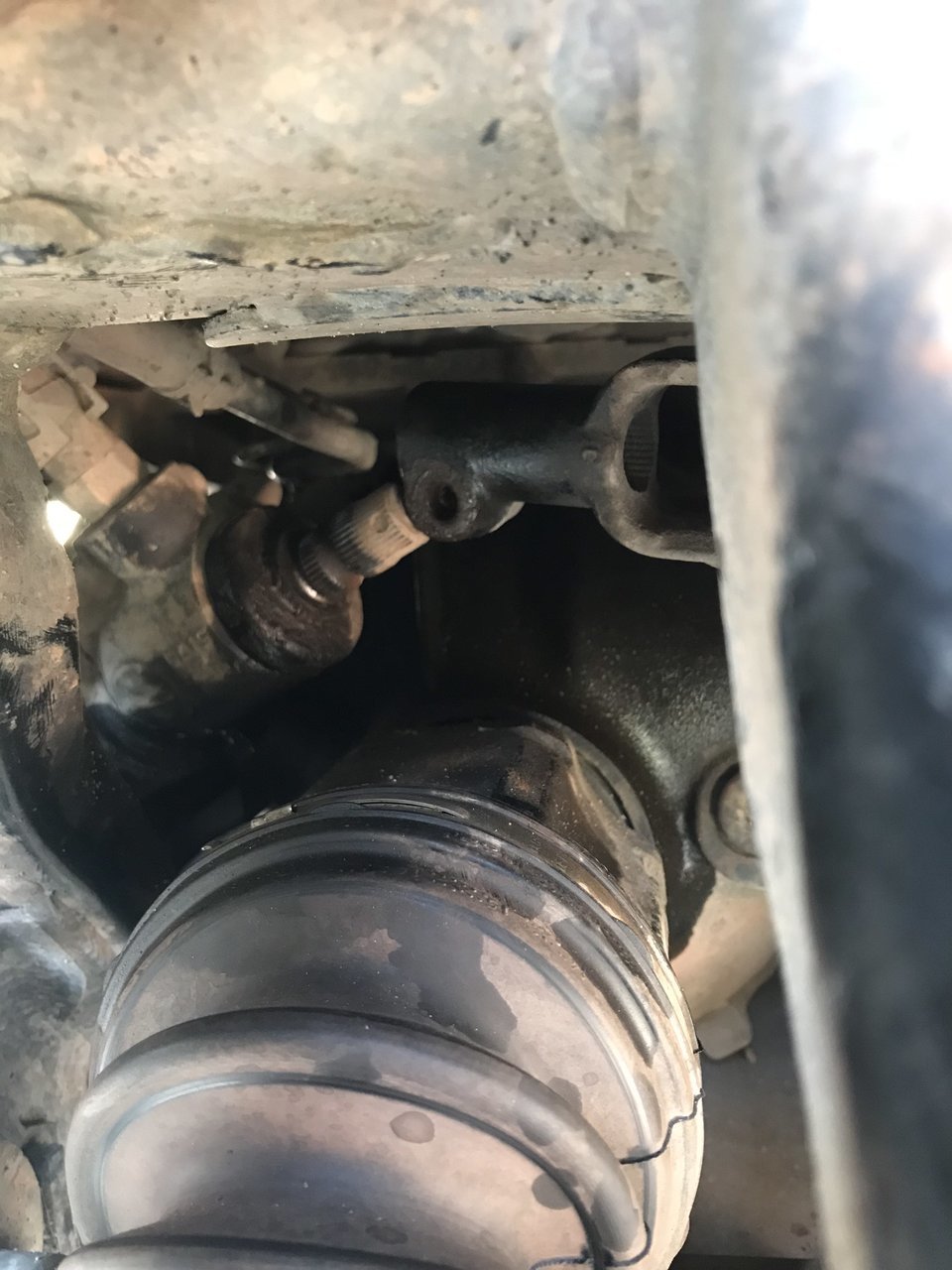

    Once you have that loosened up, use a prybar to remove the lower portion of the shaft that is attached to your rack and pinion.
    You can now wiggle out the old U joint, and put the new one on using a wrench to get them all moderately snug
    Once it's on, undo all your straps and jack up the front of the truck again. Turn the wheel until the bolt heads are facing you, and use a ratchet to tighten everything down. I tried finding a torque spec in the stickied thread, but of course that was the one diagram that was "broken". I just made them nice and tight.
    Old shaft.
    Even with all the precautions, my steering wheel is a hair off now, maybe one spline. It would be best to replace this before you are getting an alignment for something else, but IMO replacing this alone doesn't necessitate an alignment.

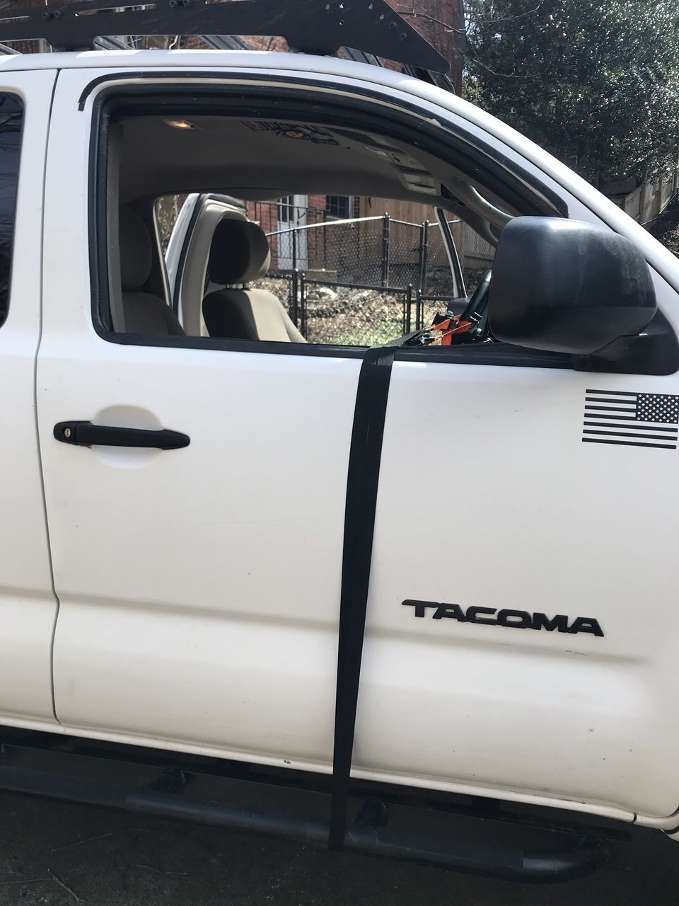

    Truck looks good in the rear now. One question, your wheel doesnt look centered when you strapped it. I m assuming the steering wheel isnt dead centered when you strap it down because of the turn to get to the bolts??

    Yeah, exactly. With it dead centered, I was unable to access any of the bolts. It doesn't need to be centered when taking it apart, so long as the tires and steering wheel don't turn when apart.
