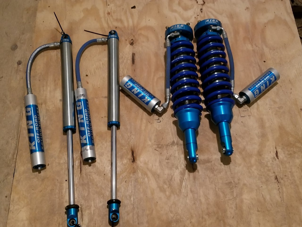

    mmmm, purdy. You ever figure out your leaf situation?

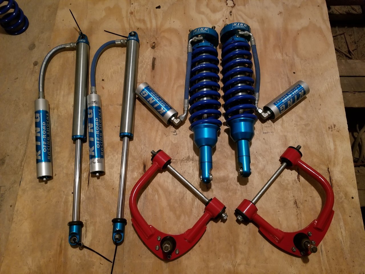

    You planning on cutting the old bolts out?

    Yeah. Got a custom made pack from @Blackout14 He's selling some sweet ones now on his website.

    Cutting the old bolts?

    For the UCA. You've got new bolts in the JBA right there

    Oh. Right.... duh. I guess so :notsure: we'll see how it goes? Lol. I have a 50/50 mixture of ATF and acetone. I'm giving a couple squirts here and there to loosen things up. I'll soak em the week before we do the swap. Is that why you asked about the bolts? Cuz they're gonna be rusty AF and tough to get out?

    No, because to get out the old bolts you have to bend the fender out of the way. Some people (including me) just cut out the old ones and reinstall the new ones "backwards" and just use loctite on it.

    Gotcha. Nah, I'll put the bolts back in the same way they come out. Head to the front, right?

    Yessir, that's the way

    I cut mine out to but I always wanted to try the fender bender way. They make it look so easy on the total chaos Utube video.
