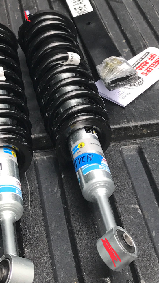

    Well didn't see this till I was done.... I have too many suspension parts. In the 2nd pic, I'm trying to show the lower mount and top stud. Lines up how? Shock mount hole to stud or side of shock mount to stud? Left one looks ok, right one might need tweaking.

    Sorry, that was kinda vague. The two red parts in this pic should line up. Doesn’t matter which stud it lines up with, as long as it’s one of them.

    No worries on vague. And F you because now I have to spin BOTH instead of one. Lol. Also thank you because I didn't even know that.

    Haha no worries. It’ll save your buyer a shit load of headache trying to get that sorted out. It took us a couple hours and a few trips to the auto parts store to fix it. Finally had to rent a sketchy spring compressor.

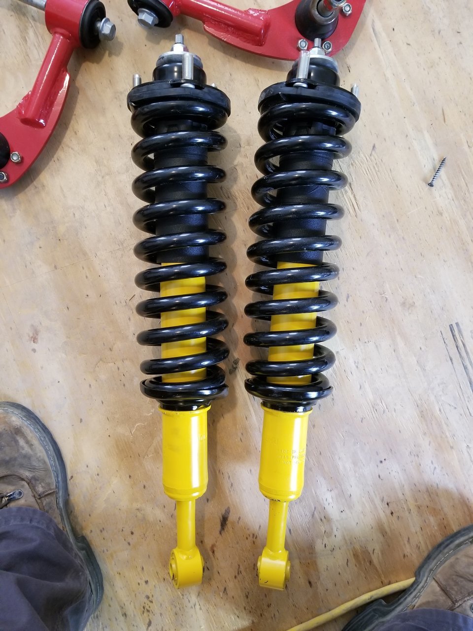

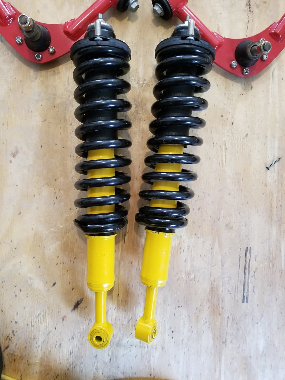

    Soooo selling a set of OME fronts! Comprised of 90000 shocks and 886 coils with brand new top hats. Also included is an aluminum taco lean spacer made by @Skell
    Everything is brand new except for the coils which have about 3k miles.
    Fully assembled! Just jack up your truck, unbolt the old ones and install these bad boys!
