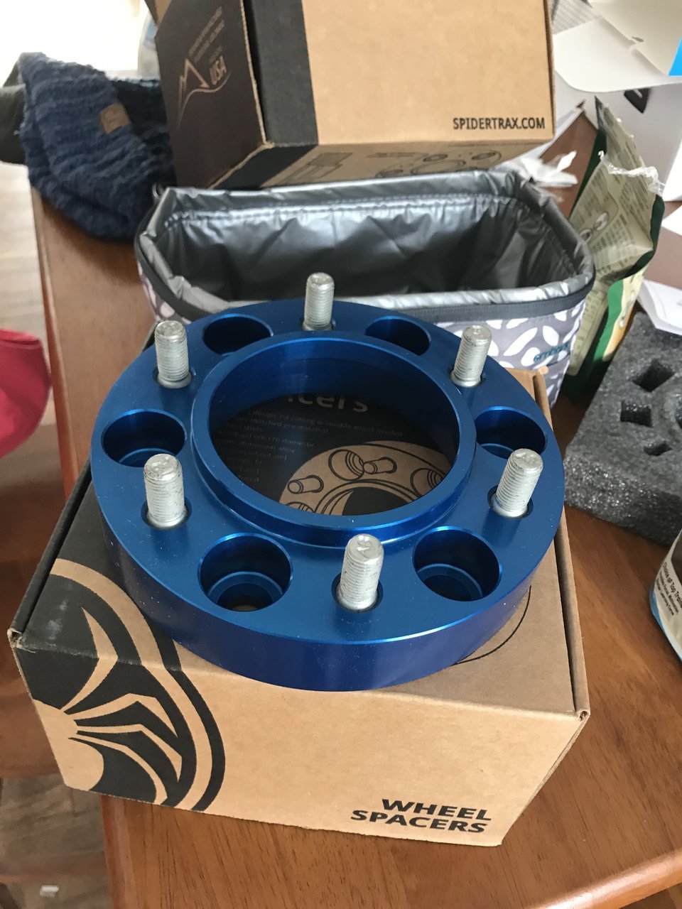

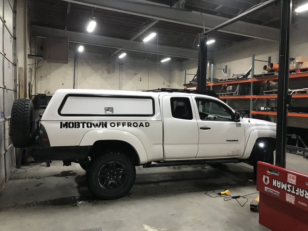

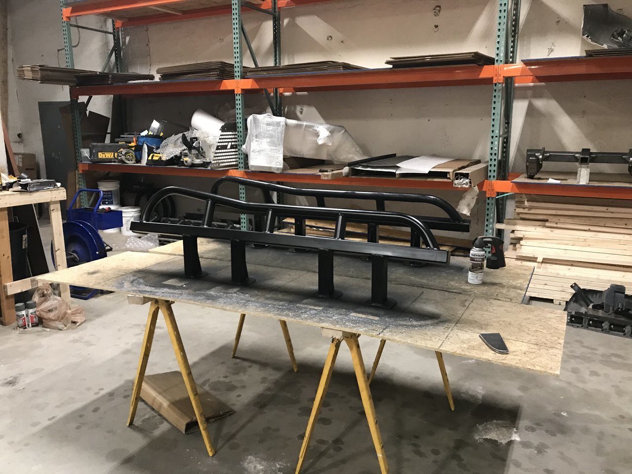

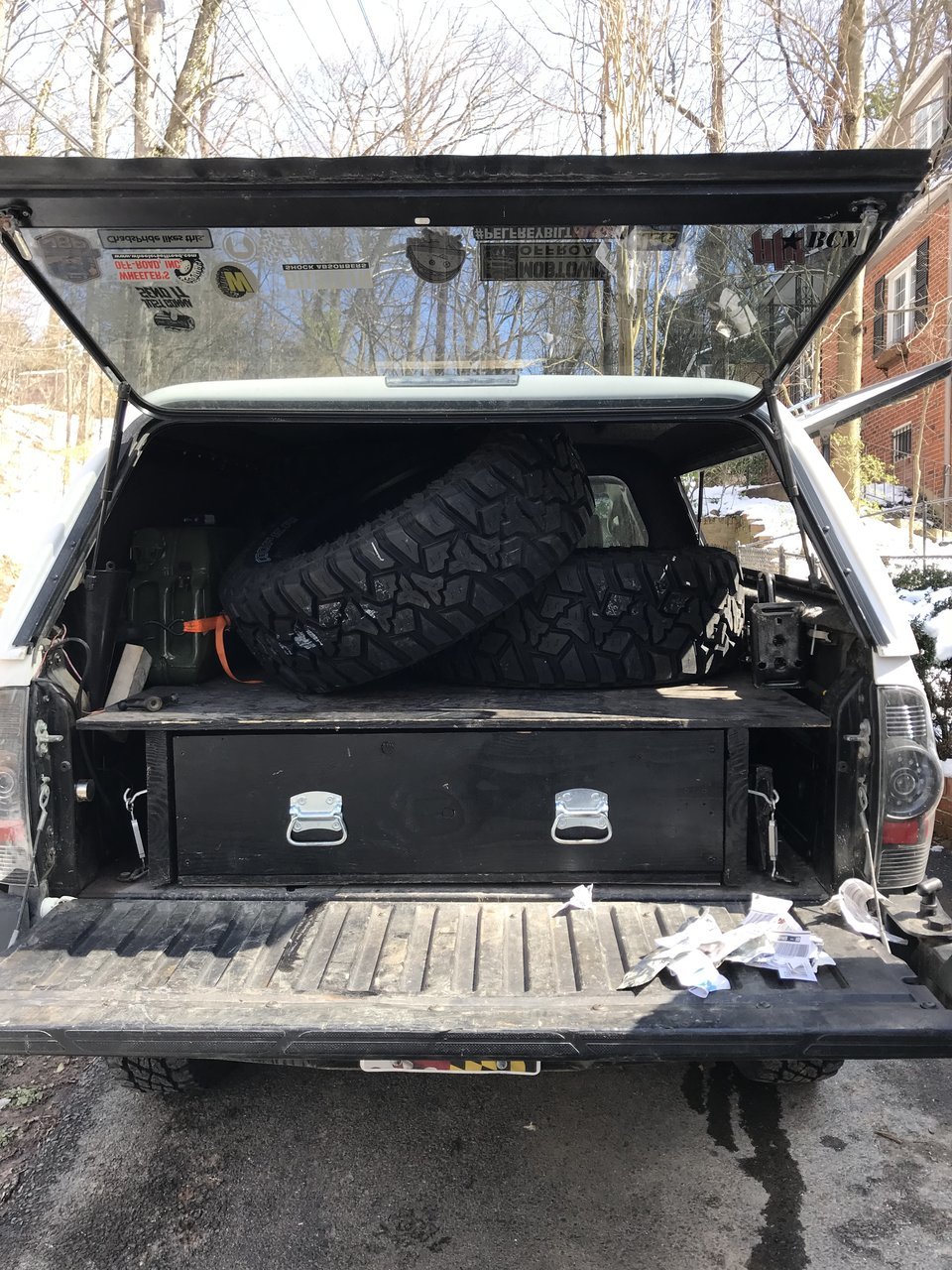

    Went to mobtown today to help @twheat40 paint his sliders, and picked up some cmc plates and molded my fender liners back a little.
    Also my spacers and 4 tires got delivered! 5th one is local and will probably get here tomorrow. I didn’t realize these tires have white letter on one side, so I’m totally doing white lettering out.

    hay I'm sorta new to this stuff got a question .....
    why the spacers ?

    My current wheels don’t stick out very far, so if I were to put these wider tires on, then they would rub my upper control arms. These will poke it out far enough to clear all of that. As a result I’ll rub more on the truck, but I’ve already cut a bunch of stuff out of the way in preparation.

    got cha, its like increasing the wheel back spacing?
    thanks

    Exactly! Old backspace was around 4.85”. With the new spacers, it’ll drop it to around 3.60”

    What size did you go with? A full 35/12.50 ?

    To avoid regearing I went with 295/70r17. The cooper MTPs are 33.5"x11.8". So not only about .5" taller than my 255s but 1.5" wider!
