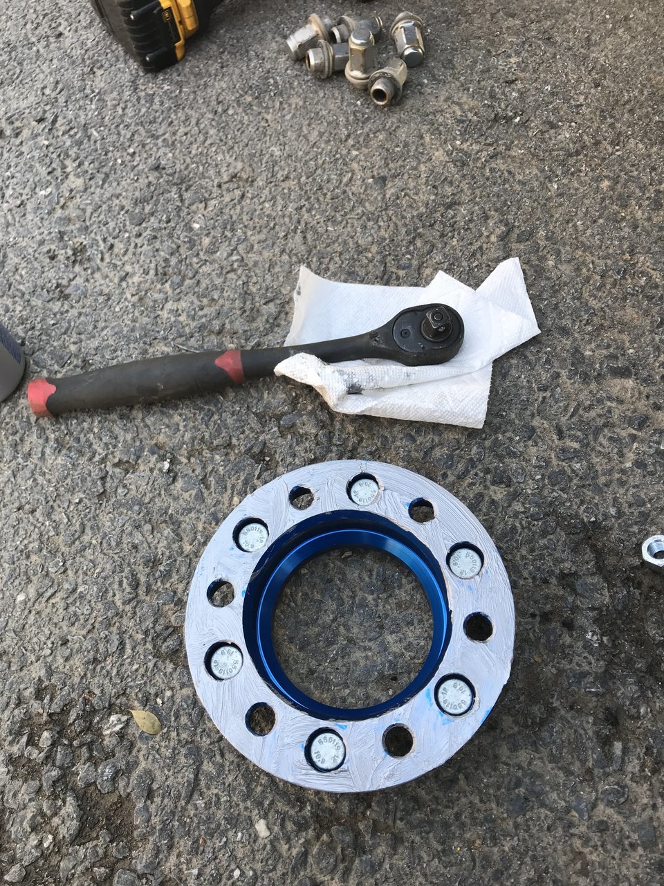

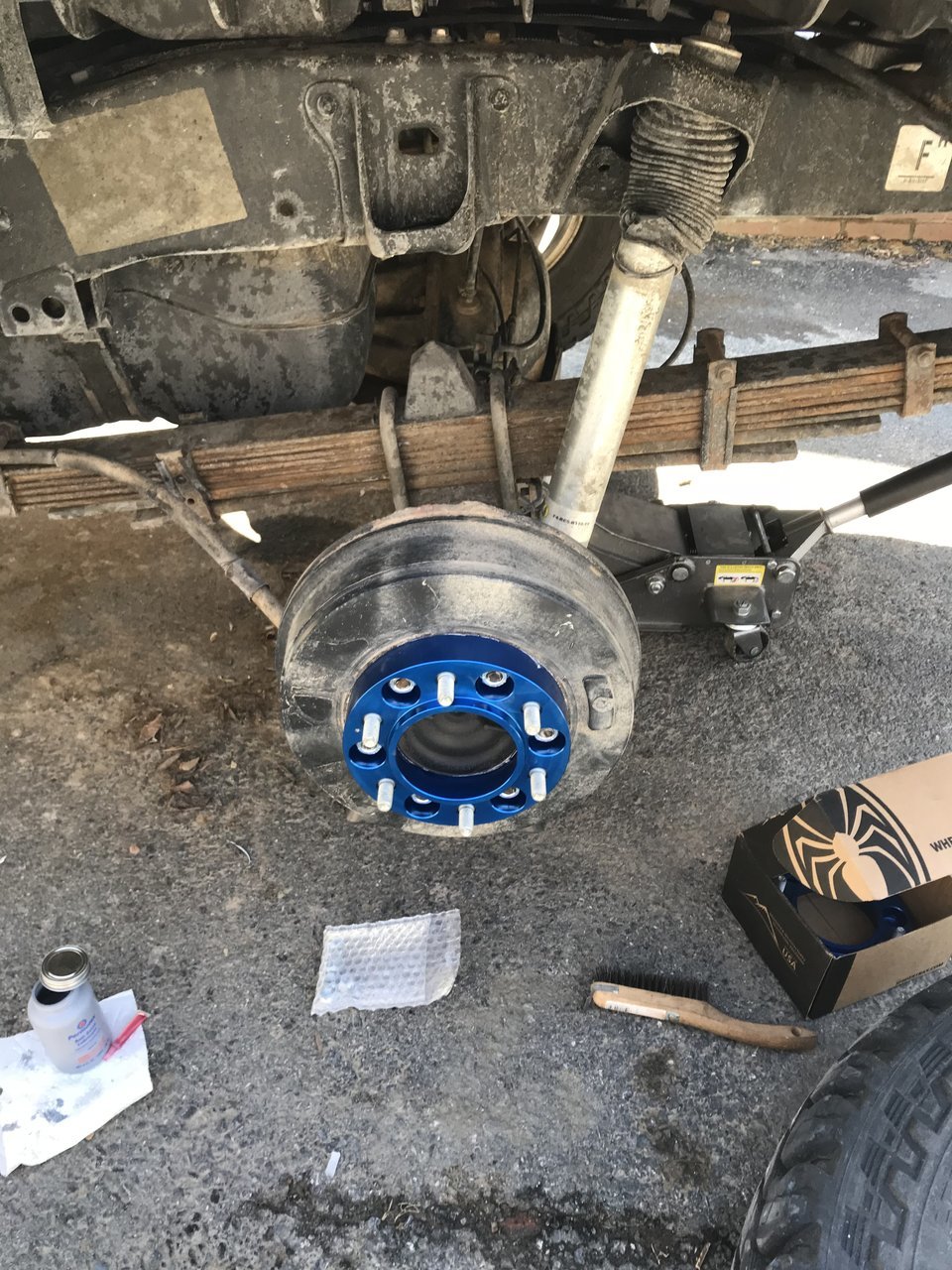

    You’re telling me! I did get the spacers on. These things are really nice quality.

    A put a little blue loctite on the factory studs just to have some extra assurance the lugs for the spacer won't come loose, and blue isn't permanent like red is.

    I did red, because I don’t foresee me taking these off anytime soon. I also used a wire brush to clean up the studs and drums/rotors, then applied anti seize to the back of the spacer. Then torqued it all down. Did it by the book!
