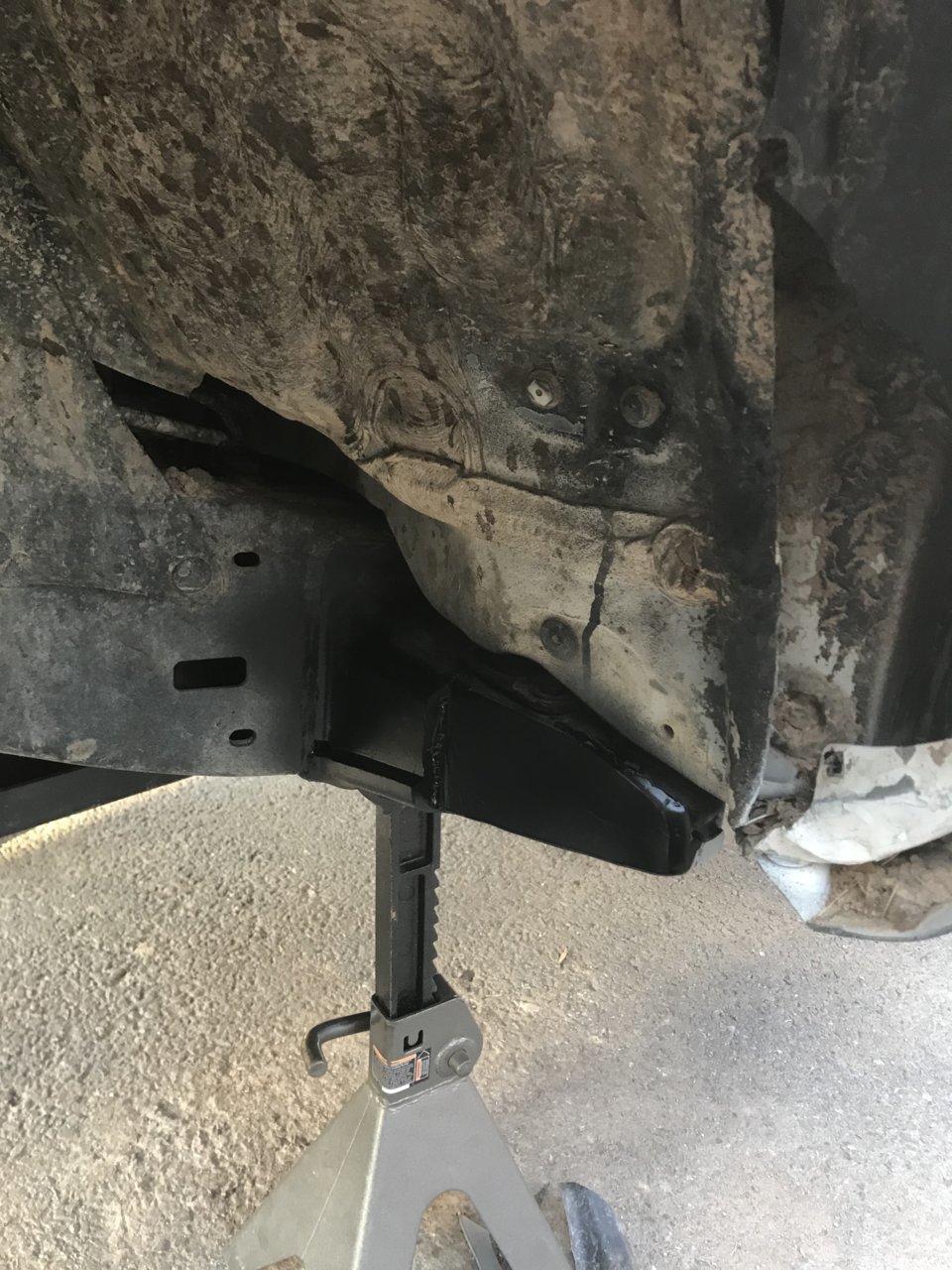

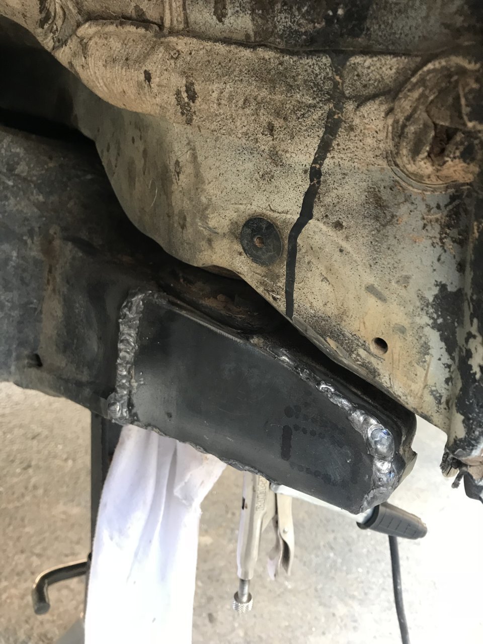

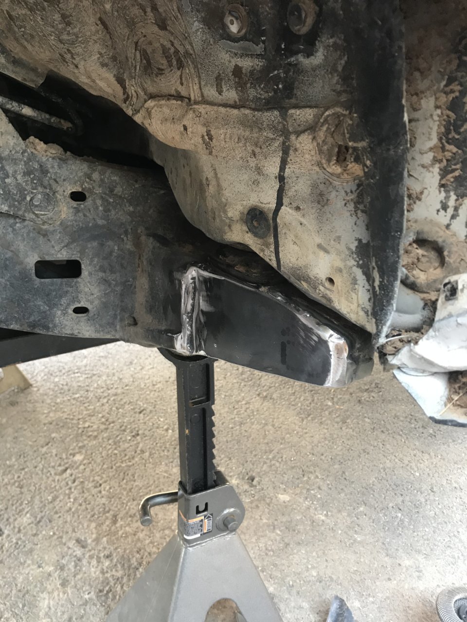

    Thanks rob, I really appreciate that! I try to put it the work once to get it done and not have to worry about it. Plus I enjoy it. Welded my own cmc which was a freaking blast and so satisfying.

    Wow dude! Those beads aren’t terrible at all! You’ve been practicing a bunch or what? Looks pro Bro

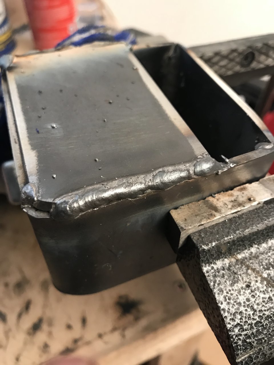

    Thanks, a little bit! Here’s probably my best bead to date.

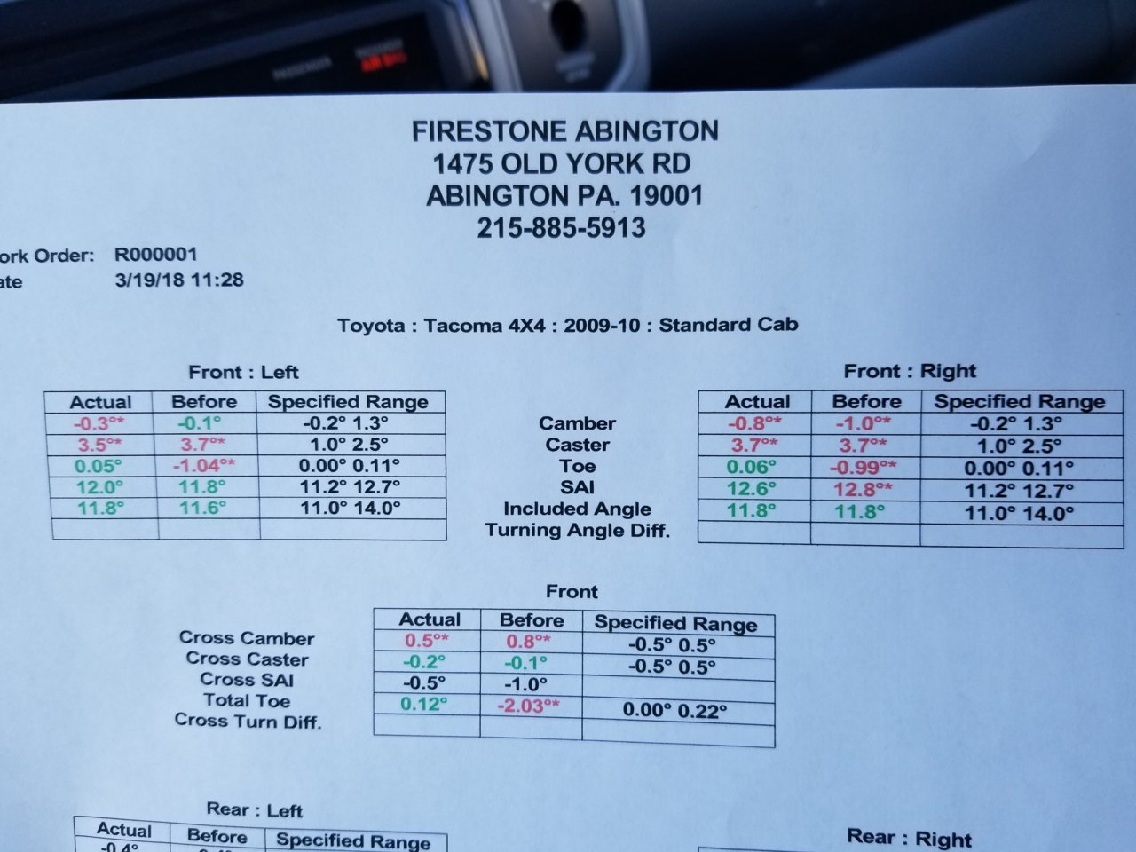

    I rub going over a 3 inch curb by my house. I rub bad in reverse. Definitely hitting the cab mount. I never hit it before, but now it's bad. These are my latest numbers.

    That’s awesome! So you just made a little template after you cut your mount huh. Jig saw to cut your plate?

    Shit man. I don’t know those numbers are good. my CMC is just kind of meh and don’t rub. EST liked it because it almost looked stock. But I’ll need to cut it and weld in a plate.

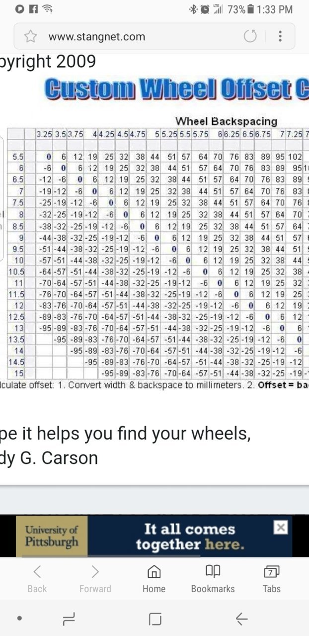

    Mine are -10 offset. I forget what that equates to in BS...
    What's your thoughts on my scenario?
    Yeah I need to chop off my cmc and redo I think.

    That was a different little project. For my cmc plates I just grabbed some from mobtown. I was there anyways so he cut me some with the plasma.
