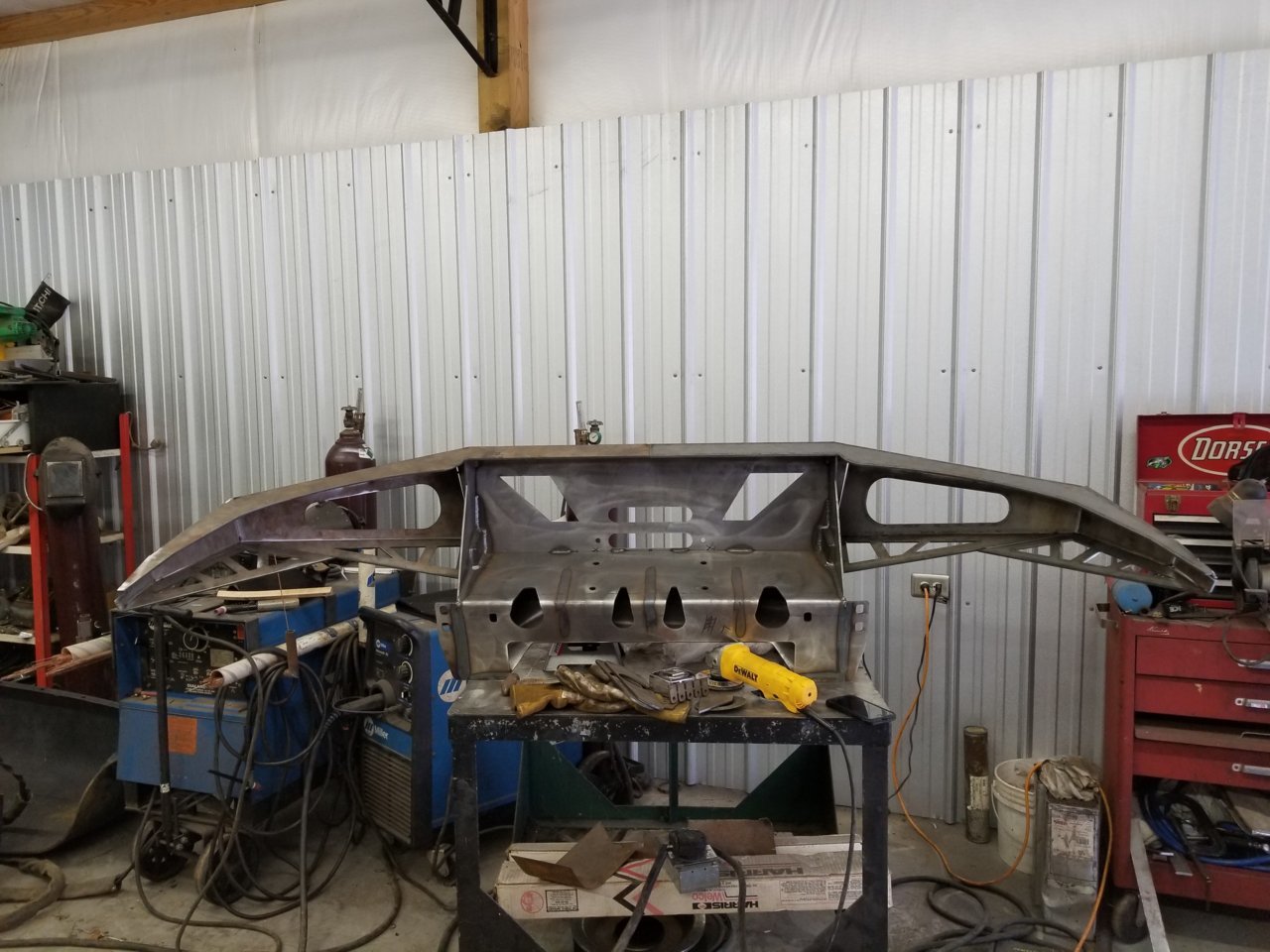

    In case that version is too much, here it is for 50% less.
    https://www.ebay.com/ulk/itm/142674268227
    Honestly though, this is is bad ass! :thumbsup:

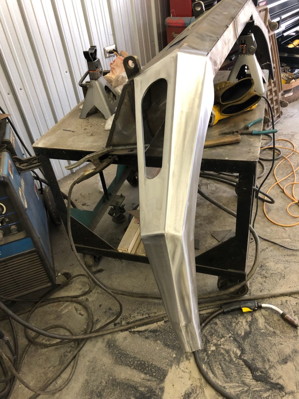

    WTF IS THAT!? :eek::bowdown:
    Shit man, that's bad Fn ass! I can't wait to see that finished and installed. Mad skills makin' me :jellydance:

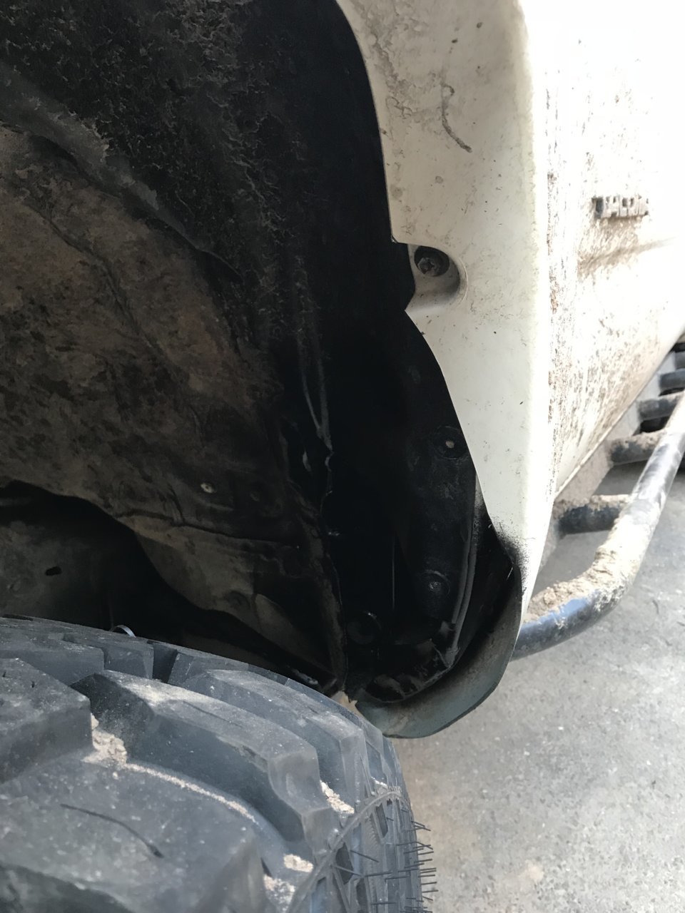

    What tires are you running exactly, I also did the body mount Chop and trimmed the bottom off the plastic off the fenders. I have BFG KO2 305/65/R17 and I had copper 33x12x17 mud tires but I’m looking to go bigger

    Did you use your jack to compress your tires to see how much room you had?

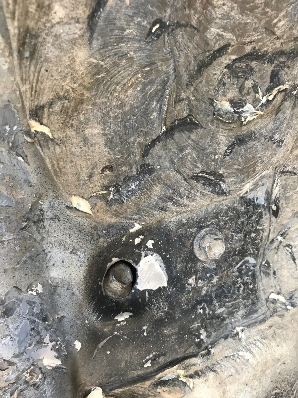

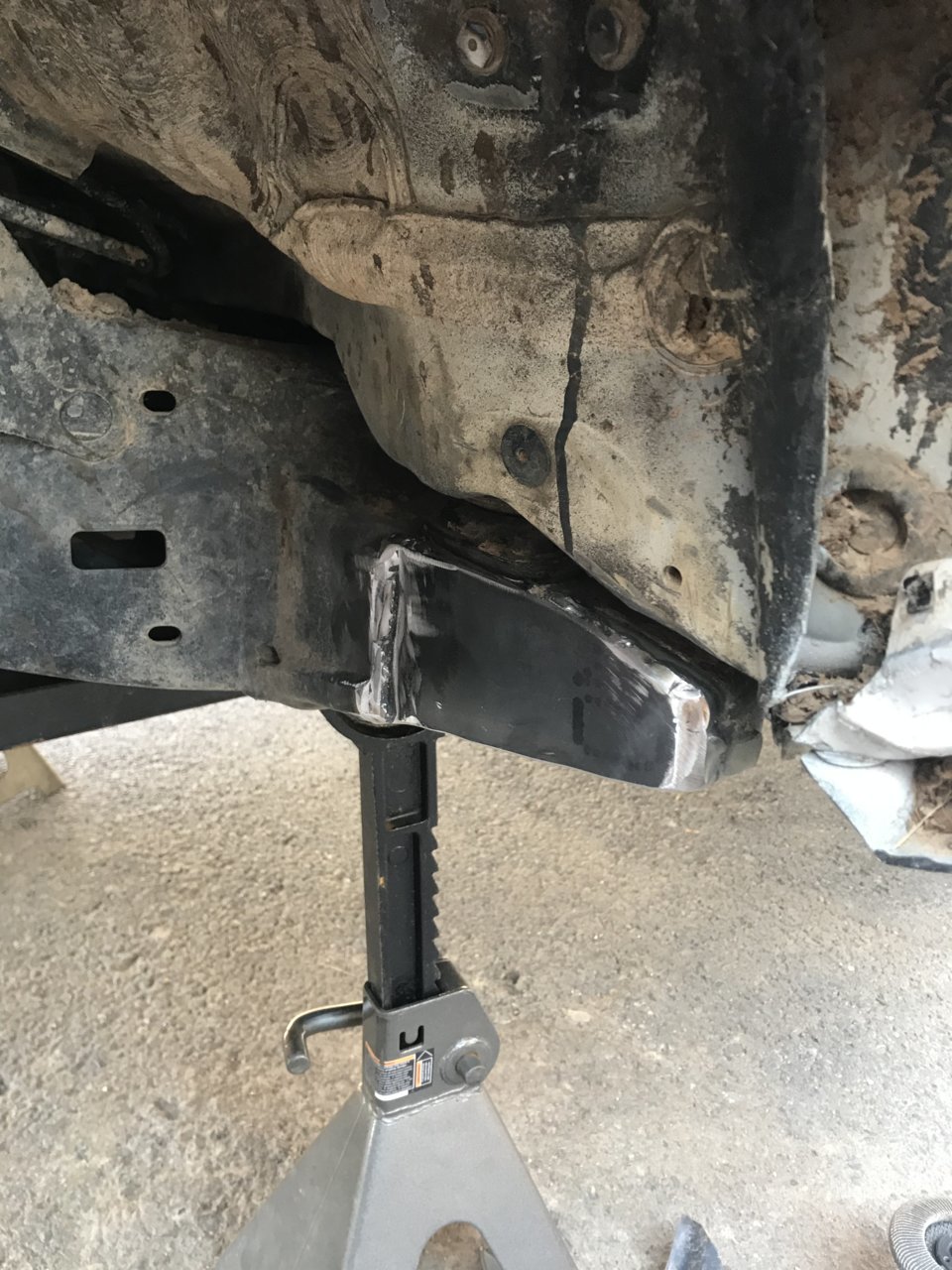

    They’re 295/70r17, or 33.5”x11.6” cooper mtp. To clearance them, I removed my coilover, and used the jack under the LCA to move the tire upwards into the wheel well, and turned it side to side. This way I could cut and hammer anything in the way.
