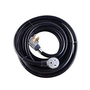

    what do you mean you don't like the plug on the 8 gauge one? Electrical plugs are designed differently for each Amperage they can handle. The first one that @EatSleepTacos linked to, the yellow cord, is only rated for 15amps because thats the type of male and female end that are on it. the wire itself is rated for 30amps. Randy could have gotten his in a 50 foot cord and be ok. It's just that the limiting factor is the household wiring. I believe in his case it's still only 15 amps.

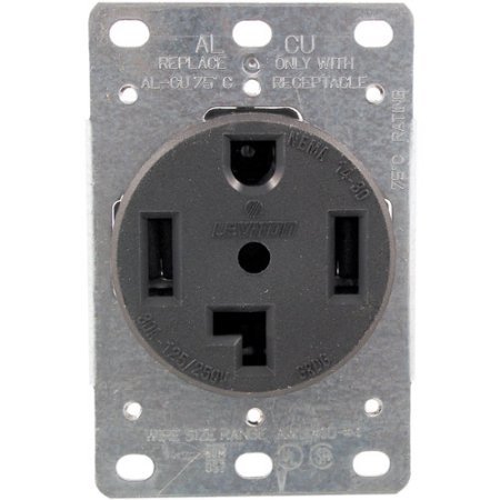

    USUALLY every plug has some stamping on it to tell you what its rated for, you can see in this picture that it says 30A - 125/250V
    this is a 30 amp, 4 wire dryer receptacle. the 4 wires are ground (the round-ish hole), the neutral (the dog leg hole), and 2 hots (the side holes)

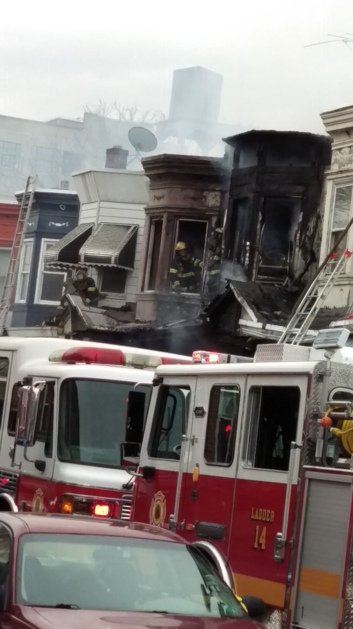

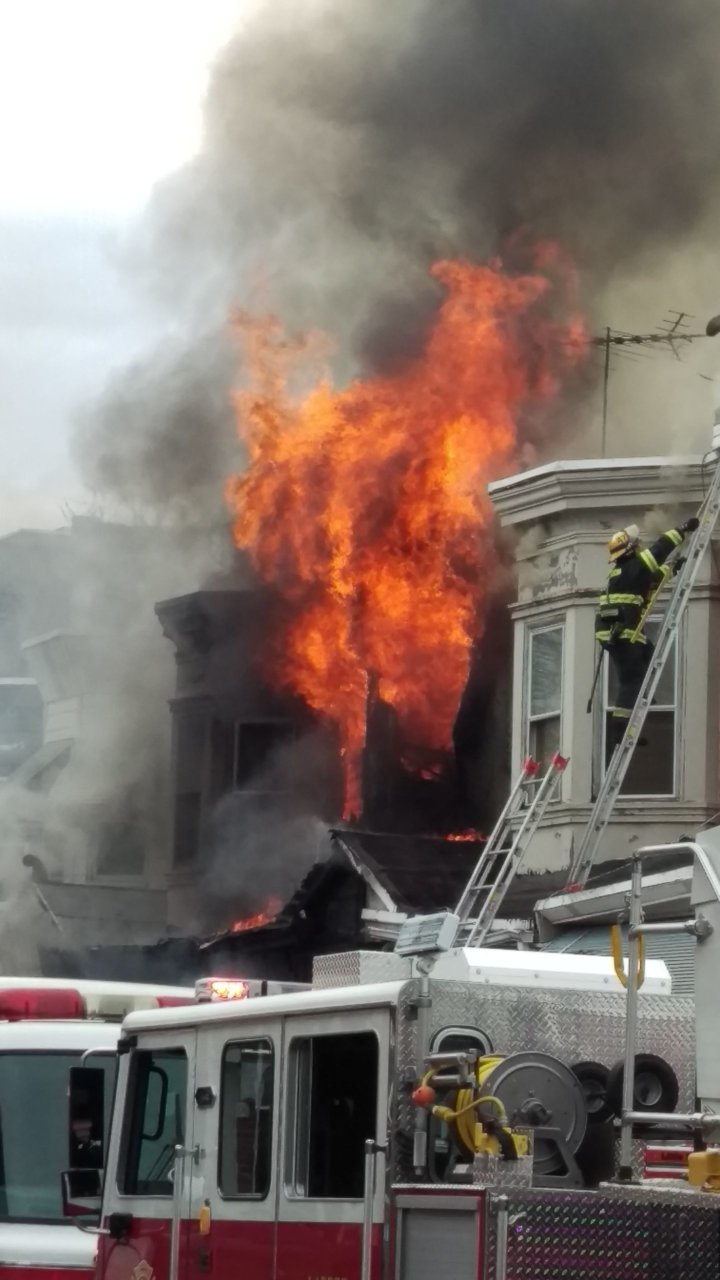

    @EatSleepTacos here is a house fire. this happened the block behind my last flip. I know they're rowhomes. I know they're attached. But fire will jump. In this case, the center house had an electrical fire. I doubt they were welding, probably just a lamp cord extension cord under a rug that wore out over time. my point is that the fire spread to the neighbor houses and fucked them up too. Don't take chances you're not willing to pay for later.

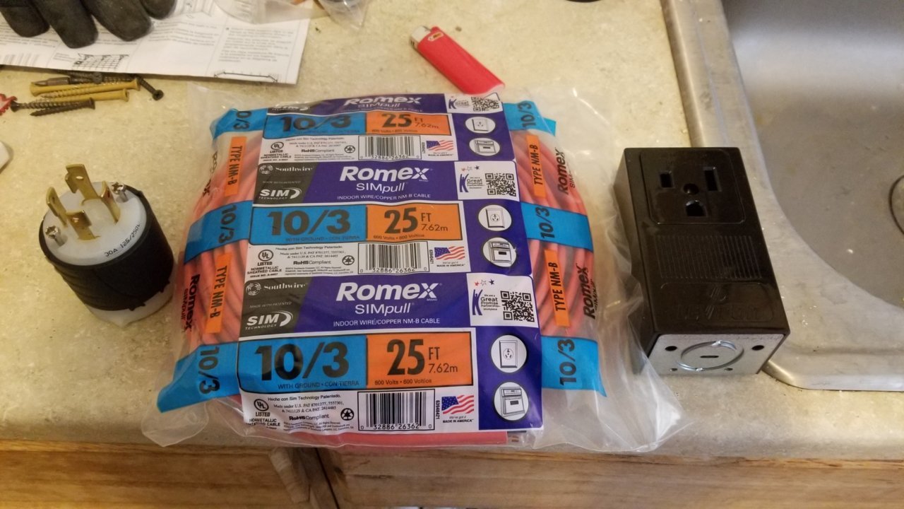

    We are doing my rear suspension on sunday. this is the extension cord I am temporarily making for a welder. its going from a generator which has a 30amp twist lock style plug to a welder with a 50 amp plug on it. Even though the welder plug is 50amps, I feel ok using thr 10 gauge wire. I read over the cut sheet (the specs) for the welder and it never goes above 30amp. IIRC, normal operating was somewhere in the low 20amp range.
    I'm not making it 25 feet... I'm using that wire for my dryer in my apartment, then whatever's left will be the cord. we're using a generator so its movable...

    so the wire is great, but the plug you dont like? why dont you like the plug? it matches your welder, correct?
