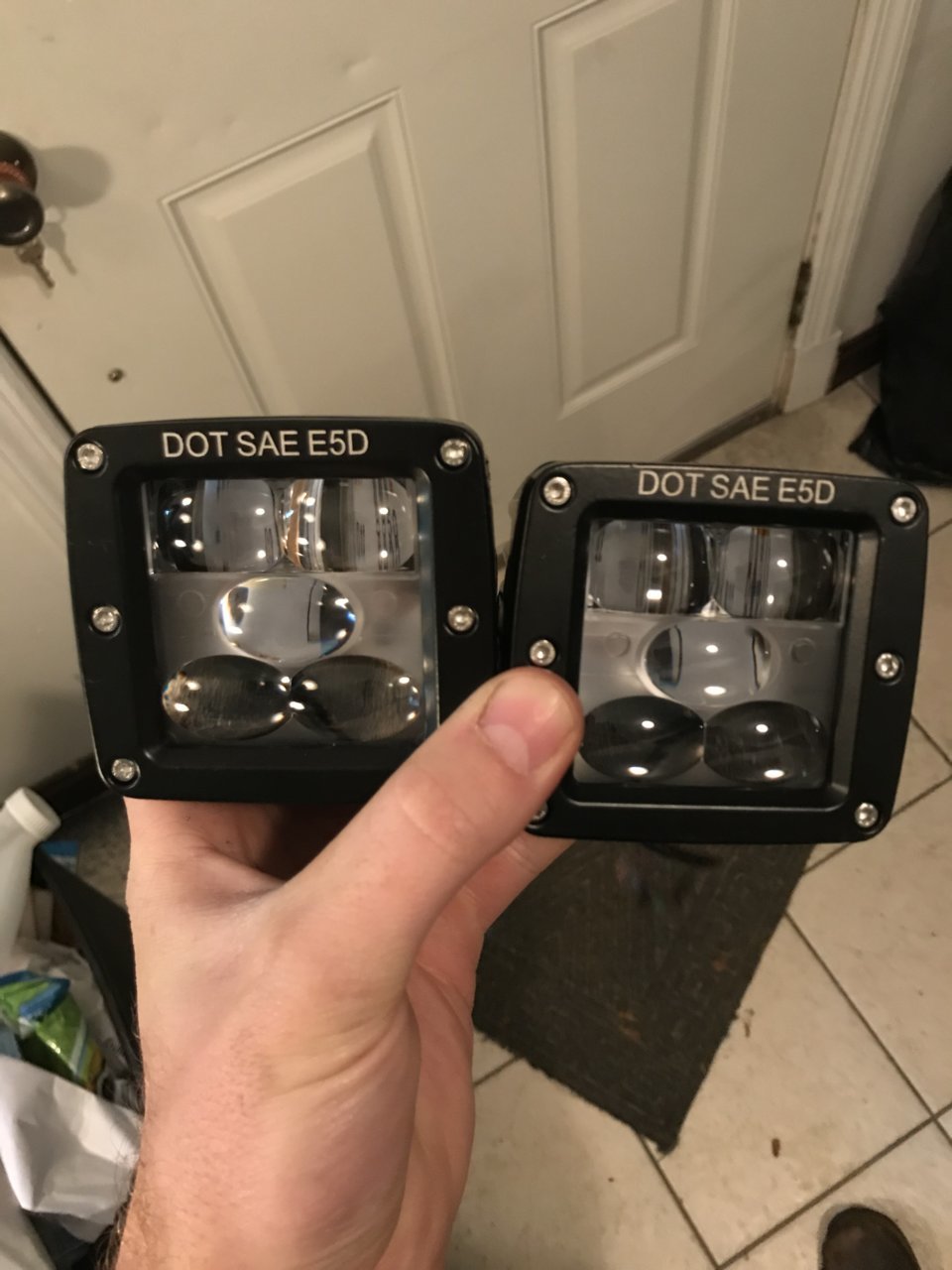

    So earlier I installed my new DOT/SAE compliant fogs. What an adventure! First off, I had to shorten the legs by about 1/2" so they'd fit a little better in the bumper. Went to turn them on and no dice.
    I did A LOT of trouble shooting, with no success. Tested fuse, relay, fog light anytime mod, switch, etc and everything worked. Or so I thought.
    I saw this diagram, which enlightened me a little. (thanks @Crom ) The fog relay gets a constant +12v, but the ground is what's switched. I didn't know that. So to do some trouble shooting, I just hooked the relay straight to a ground to bypass the switch all together. It worked! This leads me to believe it's the switch itself. I'm going to swap Davids switch in next time I see him to see if his works. In the meantime, I left my ghetto wire jumper in. So now my fogs will turn on/off with my truck but I have no way of turning them off while I'm driving. This is a temporary thing.

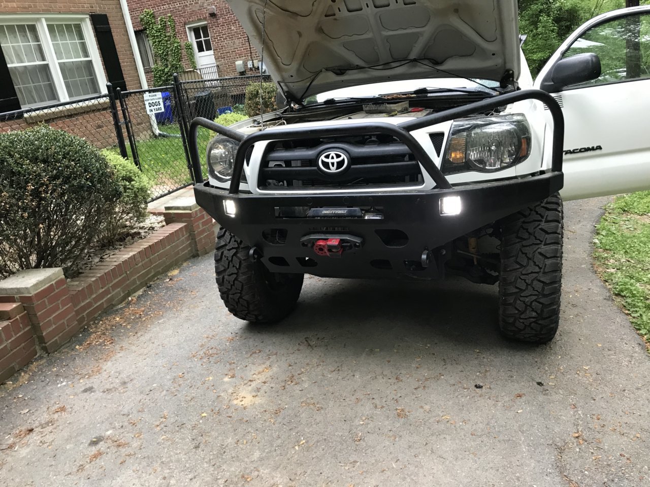

  14. May 6, 2018 at 5:18 PM
    Kemosabe
    Kemosabe Little bitty life
    Apr 2, 2015
    #152362
    6,198
    Louis
    Western Quebec, Canada
    2010, 2.7l, 4x4, M/T
    URD STS, Spidertrax spacers, AFE Pro dry
    Those lens tho! Will you take a night shot for us ?
