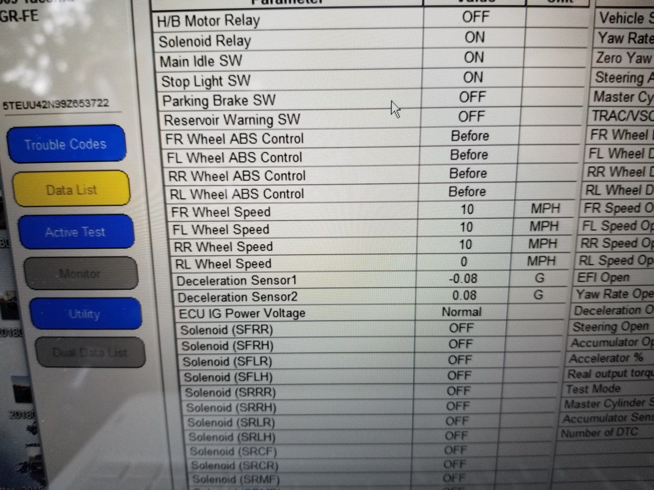

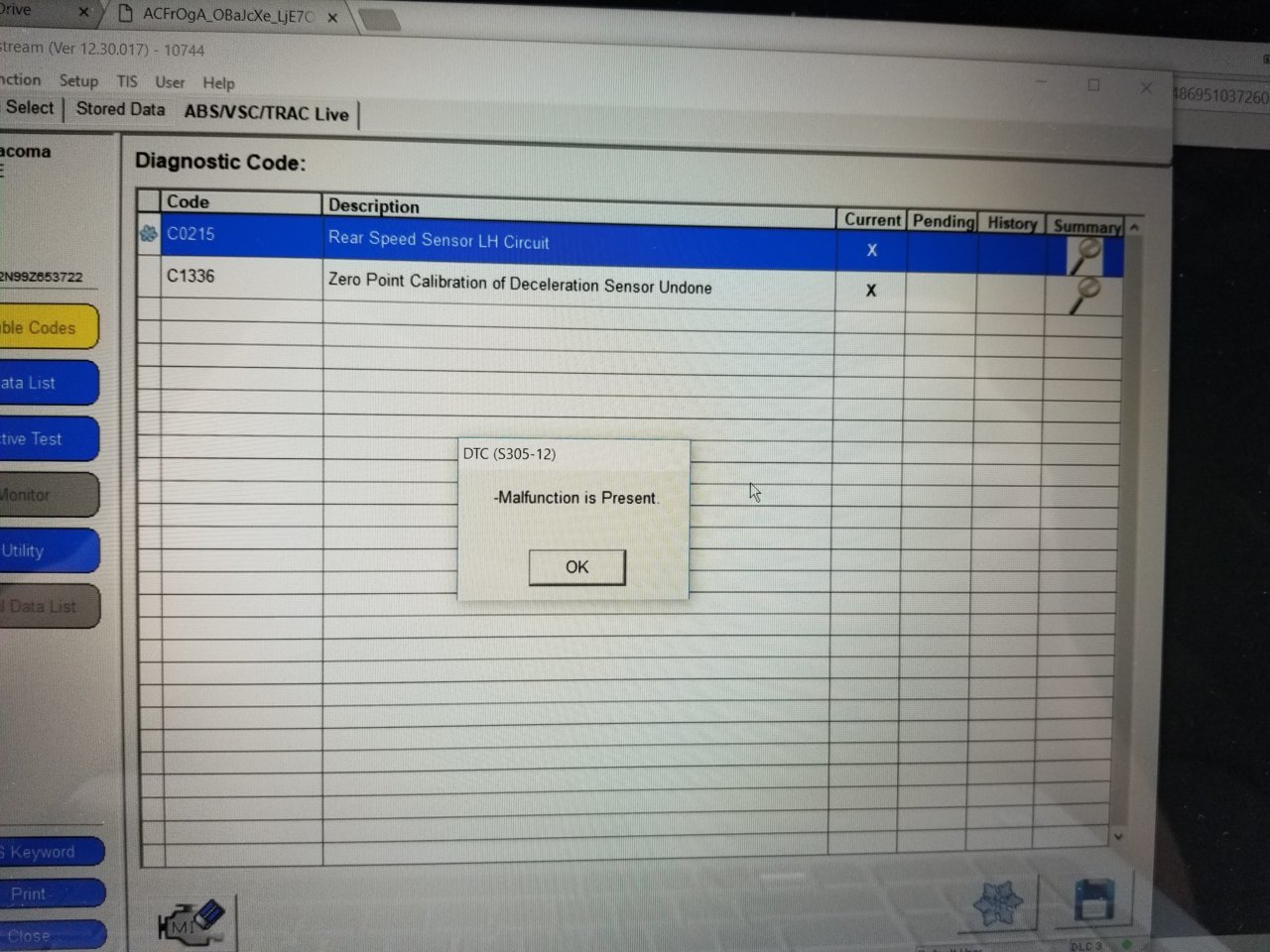

    So does that mean that your rear LH sensor is FUBAR'd?

    Yea LH rear sensor fooked. I had a feeling it was that one. There's factory zip tie points on the axle, when I snagged the harness, it pulled the cable against that zip tie.

    I've only begun to dive into this thing. This section is kinda neat too. I kinda want to drive around to see these values change.

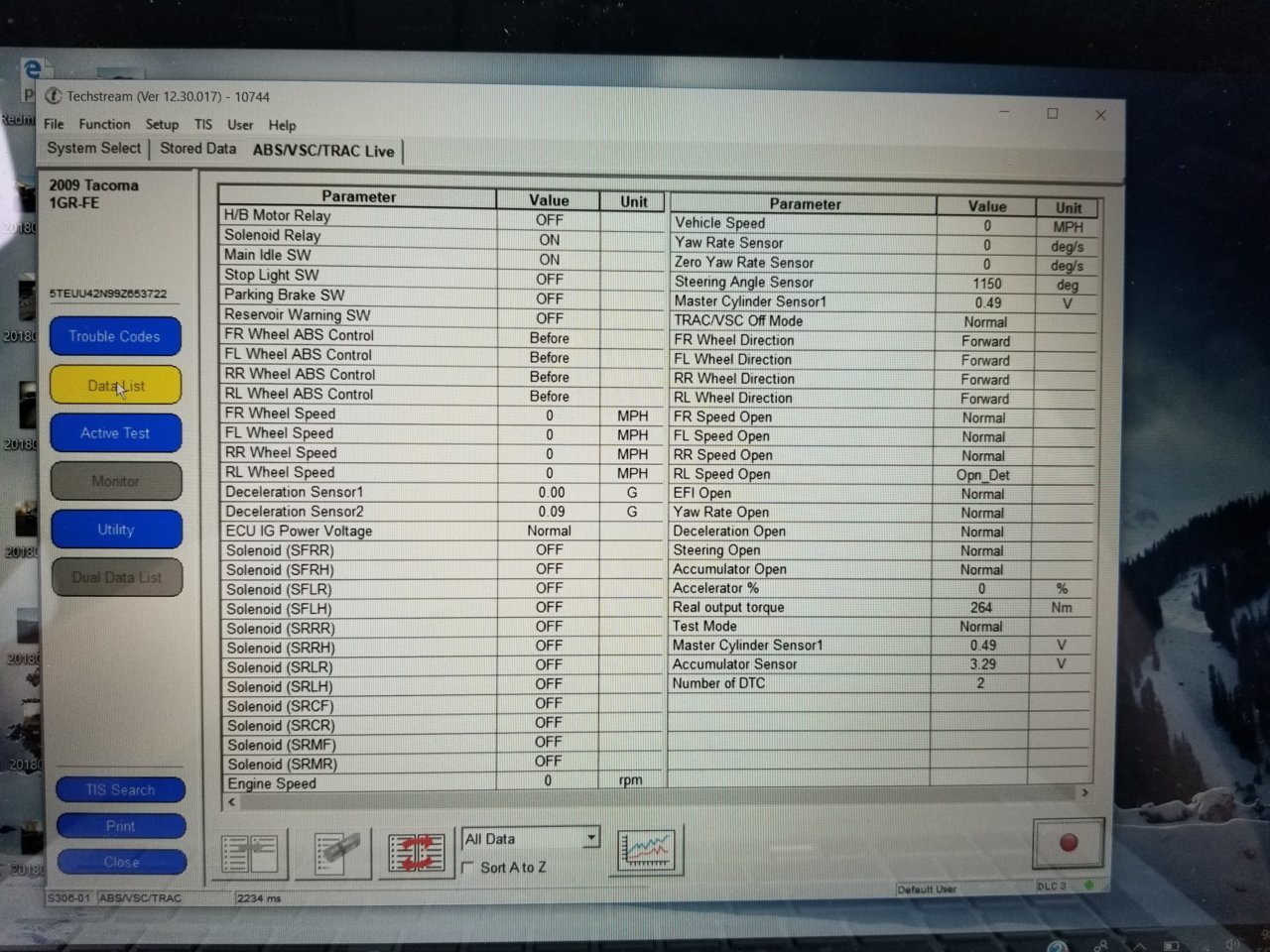

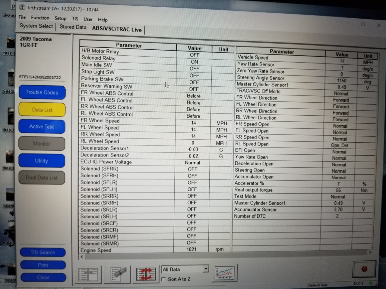

    Confirmed. Rear LH sensor not working.

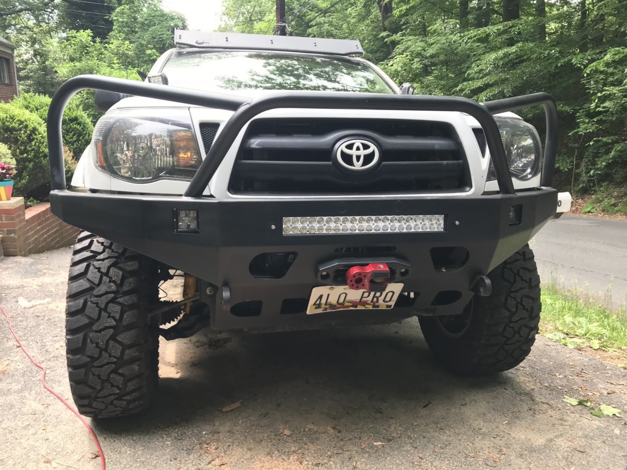

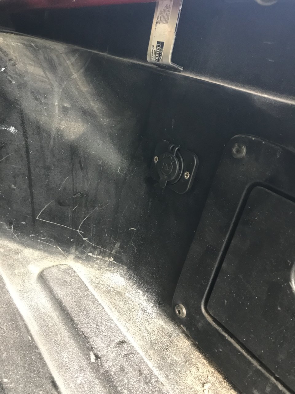

    Wired in a constant hot 12v socket for my fridge, and also finally installed my light bar. Thanks to @08comatose for suggesting I just remove my grille and support rather than dropping the whole bumper.
    20C5CD26-B969-48E5-8A9E-55FB003B70B8.jpg 13F481A1-A8D0-48ED-95B4-C99C3D42CDAF.jpg

    How do people navigate this build
    PyritePirateBill, bski22 and RobP62 like this.
  15. May 29, 2018 at 1:33 PM
    EatSleepTacos
    EatSleepTacos [OP] Well-Known Member
    Mar 24, 2015
    #151688
    59,845
    Randy
    West Valley, AZ
    2017 4Runner
    Spend every waking moment here, or just ask me for a link to something I did and I’ll provide it.

    What did you use to mount it? The best idea I could come up with is stainless slotted angle brackets from the hardware store.
