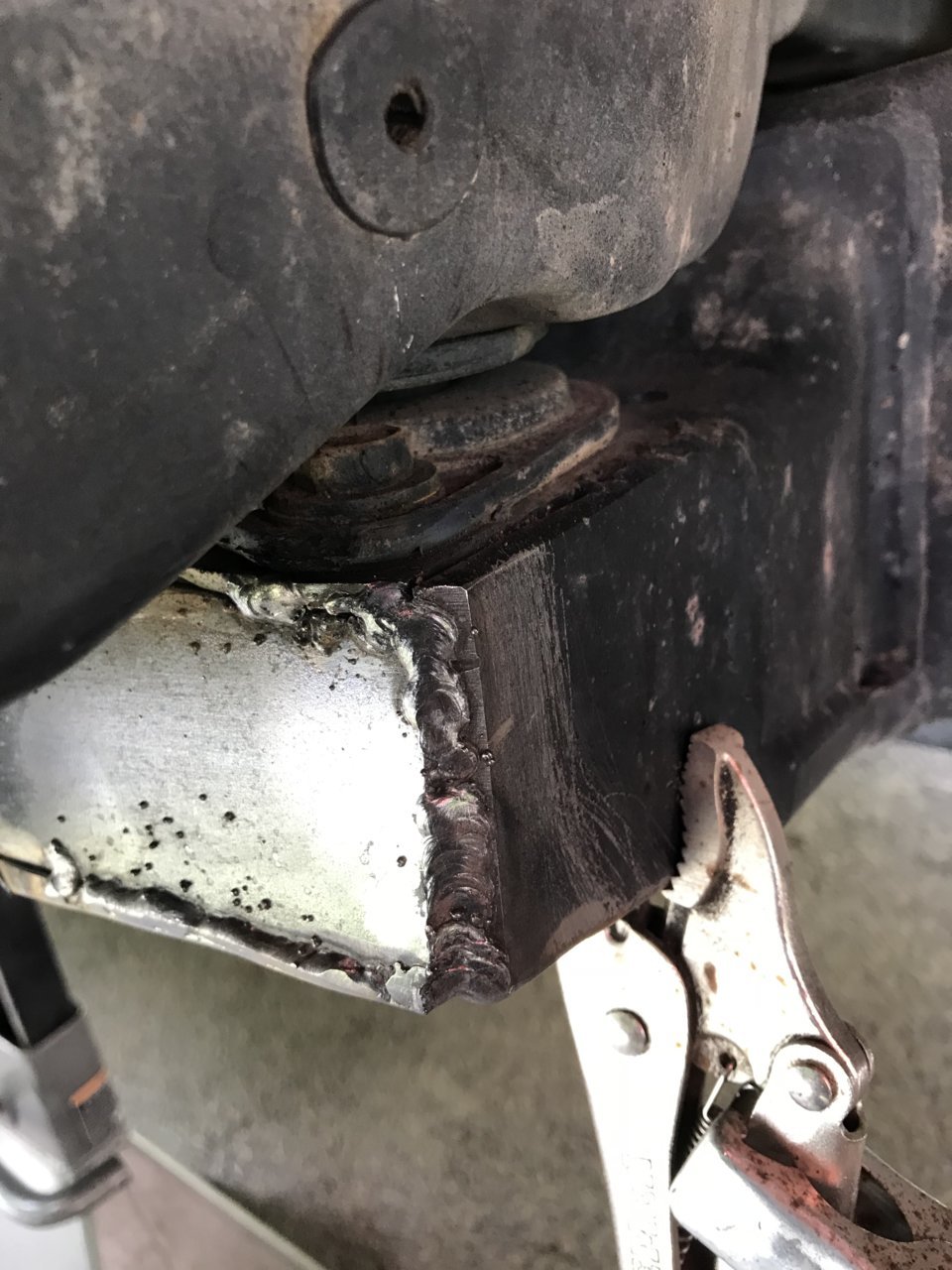

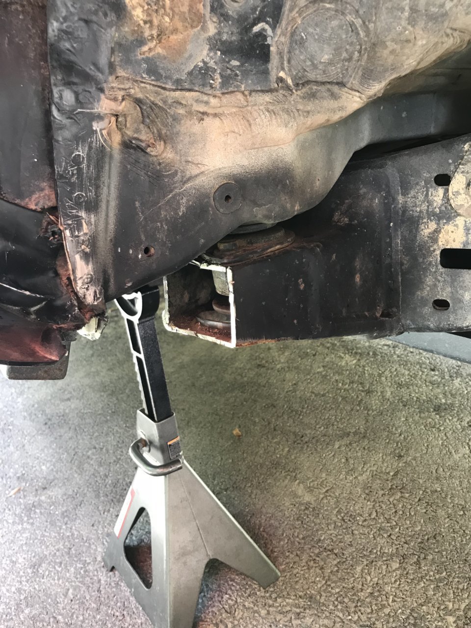

    What, the cutting up of the truck?

    Not so much that as how much you can cut off without changing the integrity of the support.

    Ah! Yeah as long as you weld something back on you’re good to go. Hell, the metal I’m welding on is thicker than the stuff I cut off.

    Yea, trust me, I am not questioning you, more so Toyota. Yea, you are not removing that much but you are still removing enough to make a difference.

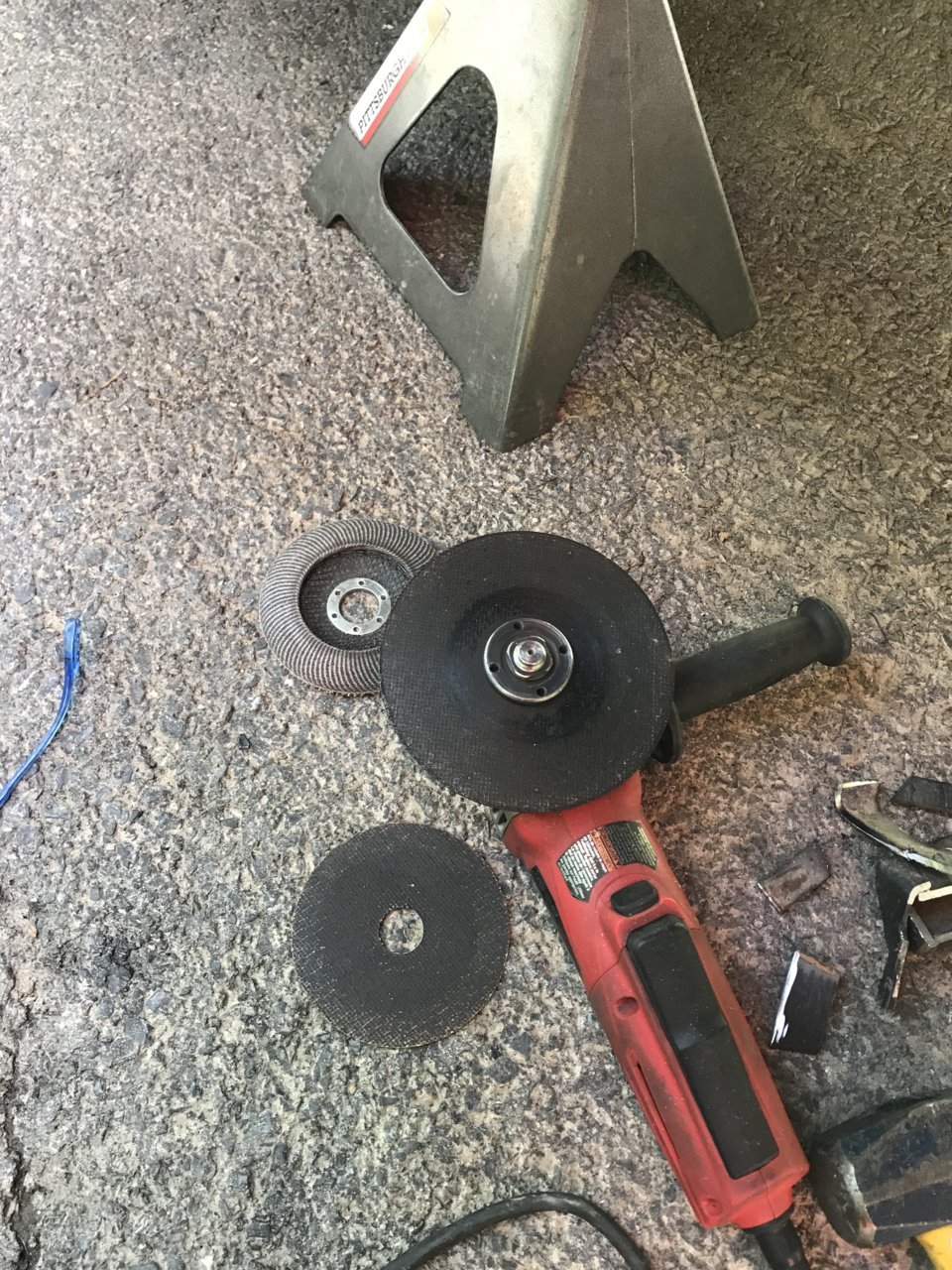

    Do you wear gloves when cutting? Ive heard you're not supposed to but I also feel like if a disc decided to go it wouldn't be pretty without a shield, and in some circumstances you can't use a shield. I remember I got a disc pinched in a cut and it shredded apart and dug pieces into a 2x4 nearby

    Really? I’ve never heard that before. I almost always wear gloves, especially if I’m making big cuts like this. After seeing what happened to @Redmann hand, I’m extra cautious of cutting without a guard.
    Today I was wearing boots, jeans, thick carhartt jacket, leather work gloves, hearing protection and double eye protection (glasses as well as a full face shield). I don’t want that disc breaking and sending shards into my bare arm.

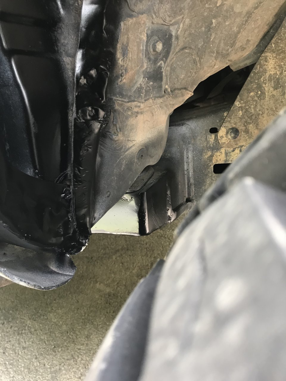

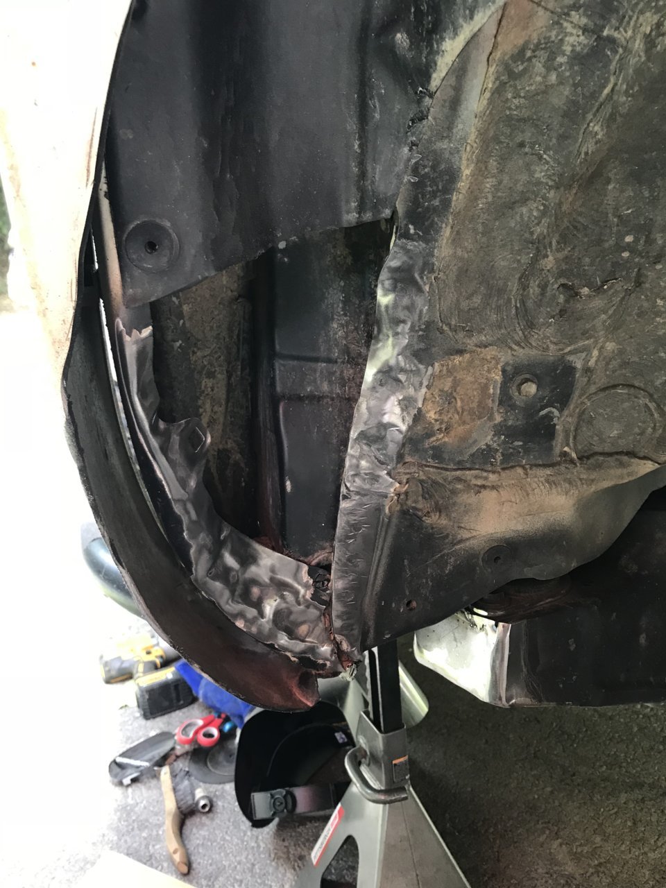

    All finished. I also hammered back the pinch weld a little more, wire wheeled it, and repainted it all.

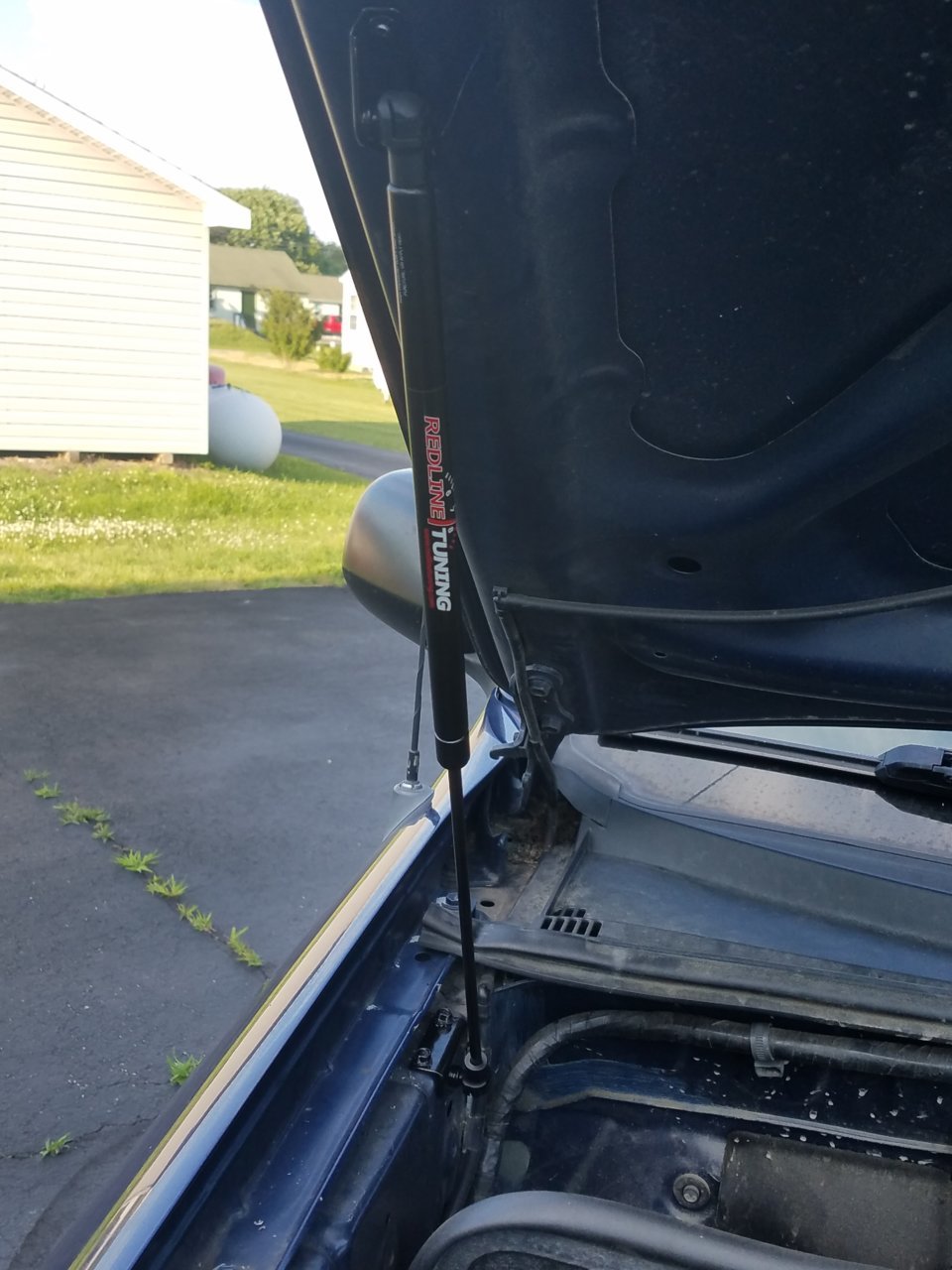

    Got the redlines on today. Their install instructions blow.
