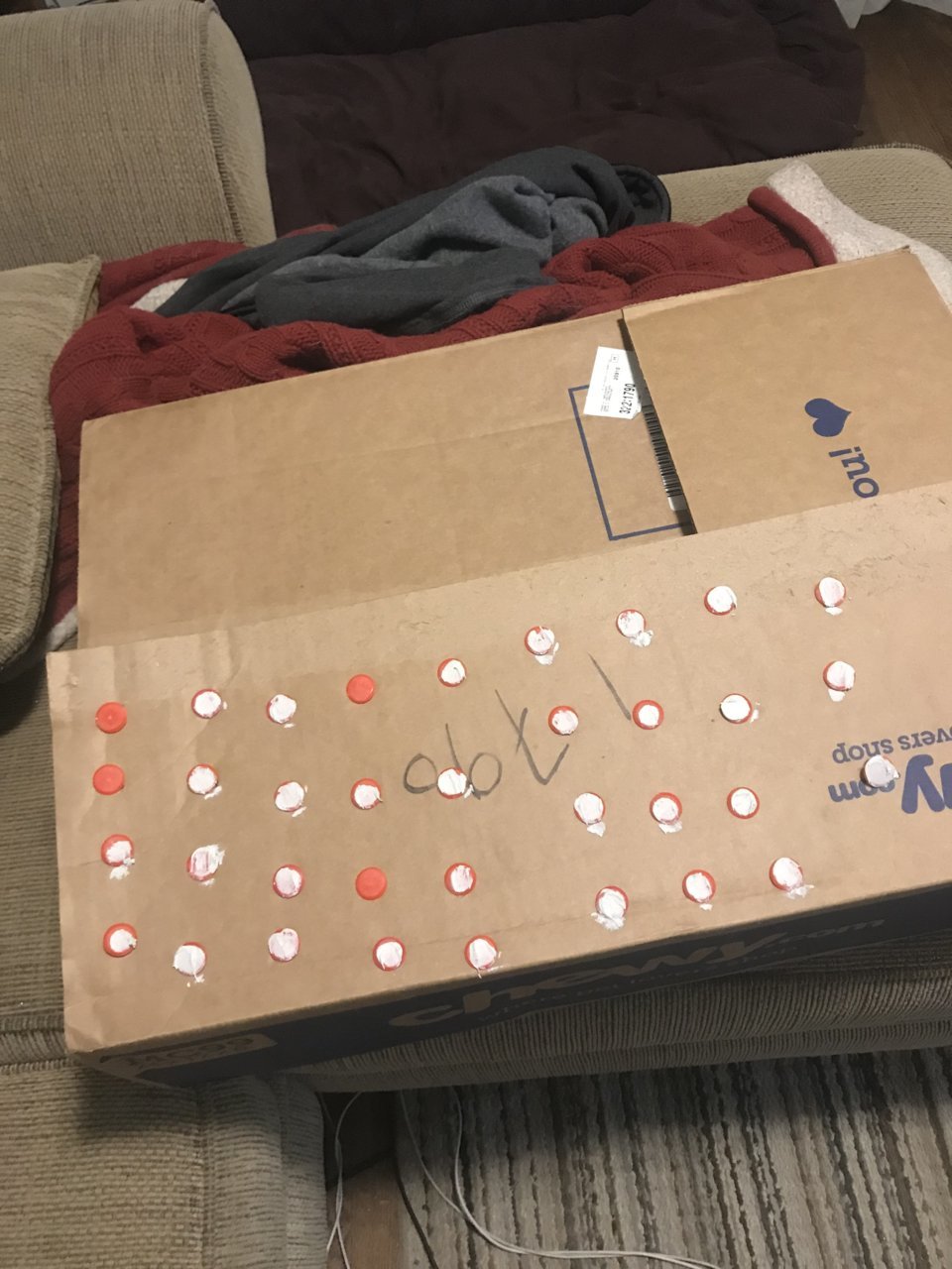

    Making good progress on these plugs! All that’s left is to sand the bondo and paint them. Paint will get here tomorrow.

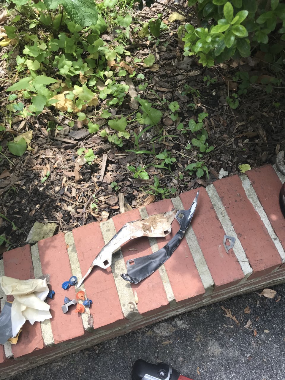

    Took of my fender flares and making color matched plugs! I have to sand down fender clips, bondo and sand, and then paint.

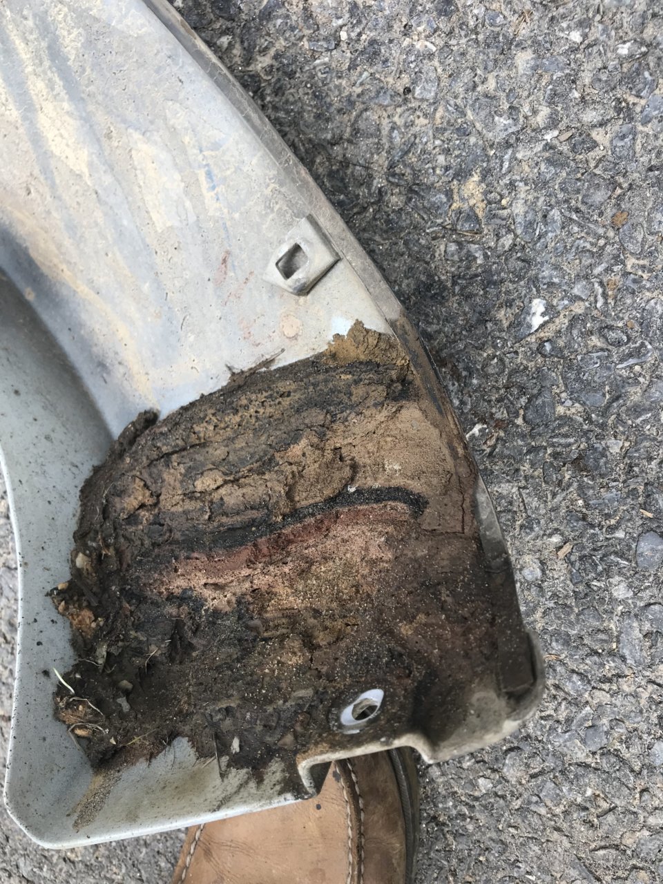

    :rofl: No not quite. Had to remove the front flares to trim the fender, and figured what the hell. I had hammered my fender back, but it looked like hell so I wanted to clean it up.
    I found like 2 pounds of mud in each rear flare, so I’m glad I did it. That’s how sheet metal rusts!!

    Well I just finished prepping 35 clips for paint. Cut, sanded, filled with bondo and sanded again only took 3.5 hours :eek: Paint arrives tomorrow!

    Yes, yes I am. I'm sanding them with 120, 400, 600, 1200, and 1500. This is why it's taking FOREVER but came out great.
