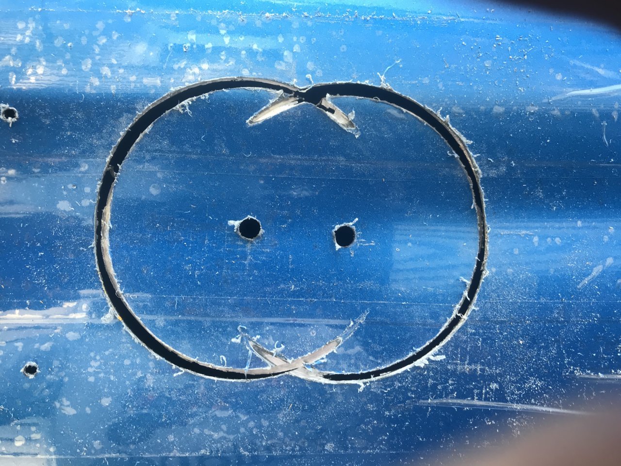

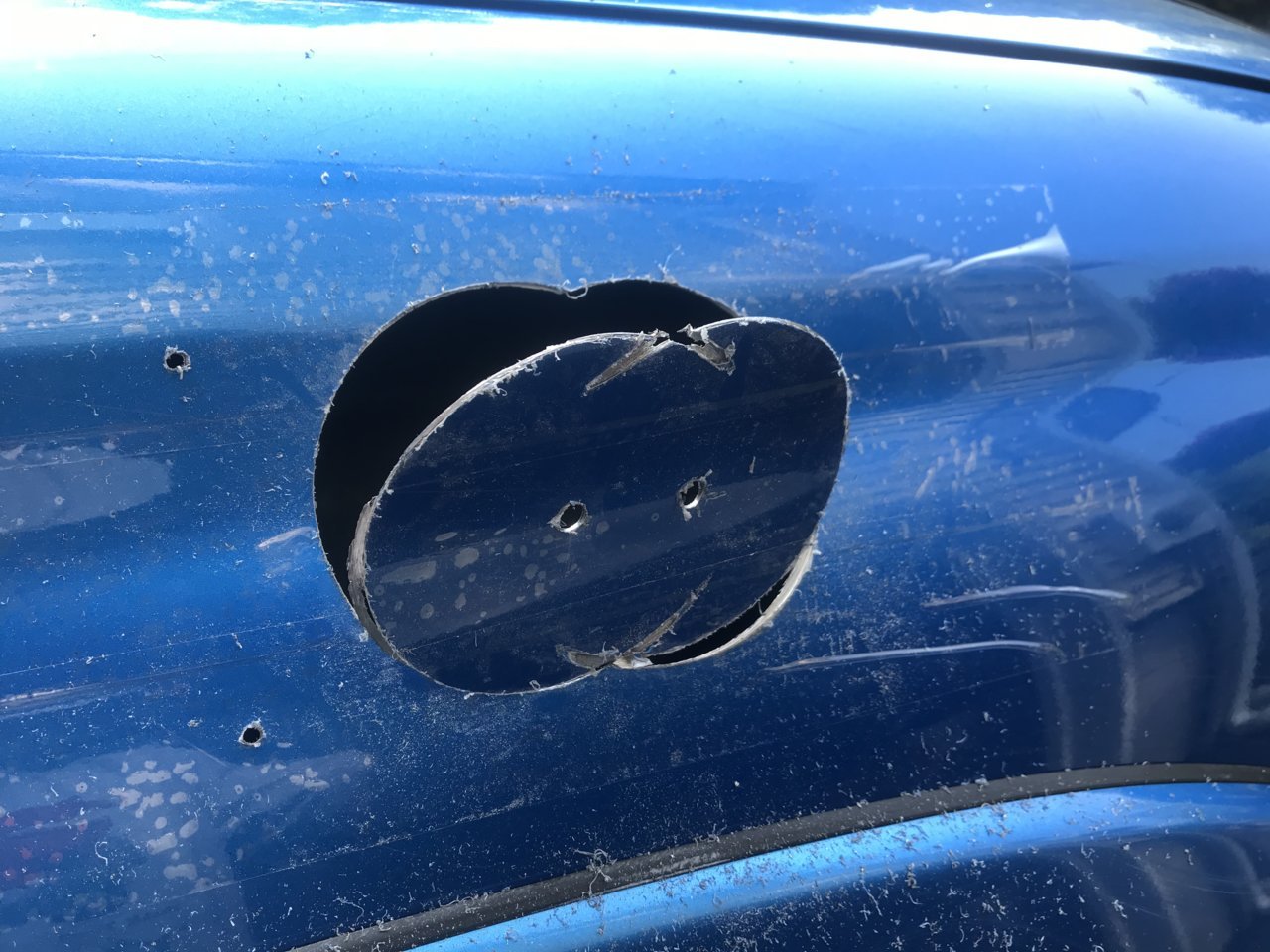

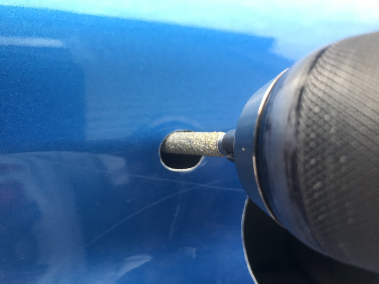

    The key is drilling the “two” holes with the 3.5” holesaw to make a nice clean oval hole. You gotta drill a little on both holes and then clean out the oval with an abrasive wheel. I also needed to ovalize the 5/8” stud holes since the snorkel inserts into the large hole at an angle and the studs also go into the fender at an angle. I had a diamond coated abrasive wheel (meant for ceramic tile actually) handy which cleans up the holes quickly AND cleanly.

    Tip: when using a hole saw on sheet metal, you actually have to go at a relatively high speed to avoid catching/grabbing/ripping of the sheet metal. And make sure you have the clutch on your drill set correctly. Do NOT use the “locked” drill mode, because if the aggressive teeth of the hole saw does catch the sheet metal abruptly, then you’ll fuck up your wrist. The clutch will help save your wrists.
