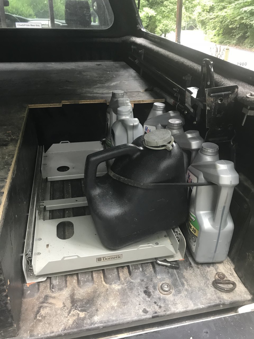

    I think I’m long over due to recycle this oil. I have about 8 gallons of it. Hopefully they’ll let me dump it all at once. I hate how there’s daily limits. So dumb.

    My local auto shop let's me dump all of mine, they have a shop heater that runs off oil.

    Hopefully this place is cool too!

    Workers gave zero shits that I had to make multiple trips! Good to know.

    That’s where I went but sometimes there’s a daily limit. At least there is at the local recycling place.
    They ended up taking it all, thank goodness

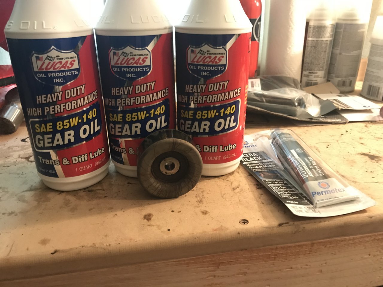

    Replaced one of the idler pulleys with the help of Tyler. Holy shit does my truck sound good! I had gotten so used to how bad it sounded before I forgot what a quiet truck is like. The pulley was so bad that it wouldn’t spin freely in my hand.
    Also replaced the air filter and got in my diff oil. I now have everything I need to install the locker.

    I'm not ballin like you :spending: was only $35 for the one pulley.

    I need to do this. What's the difficulty level on this one?

    Super easy. Use a 14mm to remove tension off the tensioner, and slip the belt off. Swap the idler (one 14mm bolt) and then put the belt back on.
