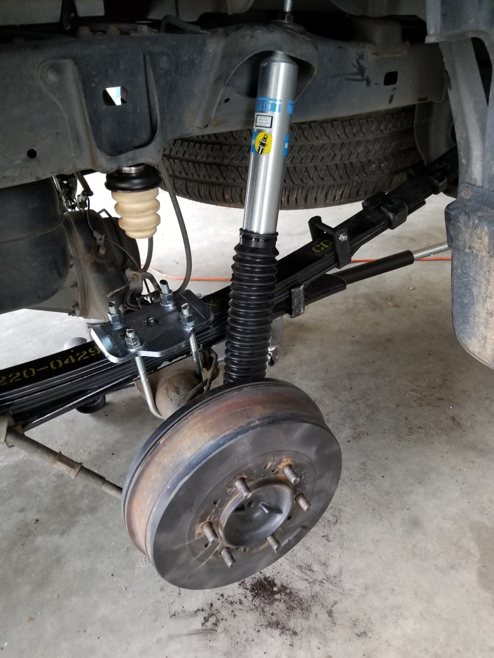

    Yea the idea is the bump stop to hit the frame prior to your shock violently compressing completely. It will for sure cause internal damage if not blow the seals.

    Yes exactly! Bump stops mount on the axle and come in contact with the frame. Their purpose is two fold. It’s to protect the shocks from bottoming out and also to absorb the force when there’s no upwards travel left. Like if you had a heavy load in the bed or hit a really big bump.
    14” is just the overall length of his shock when compressed. To determine if something is “good” (as far as travel goes) you look at the overall travel from compressed to extended. My shock has 11” of travel, and that’s pretty decent. Stock is maybe 7”? Once you get to 12” and 14” travel shocks, you’re talking a massive amount of droop and you also need to relocate where the shock mounts.

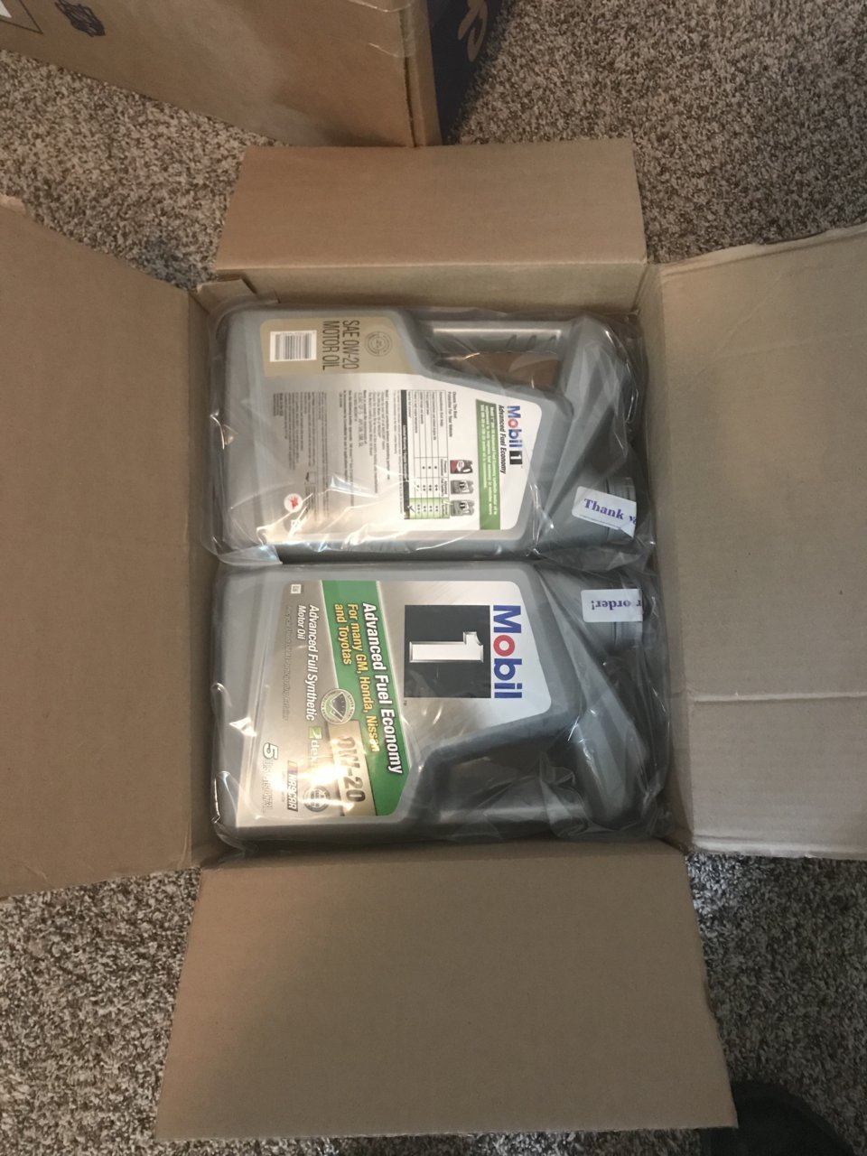

    Rather than taking the time to go to Walmart for their cheap oil (fuck that) I just bought two jugs and got free two day shipping. $24 a jug.

    I thought our trucks ran 0W-30?

    They run 5W-30 but this is for my subies! Going to do both the wifes and mine at once.
