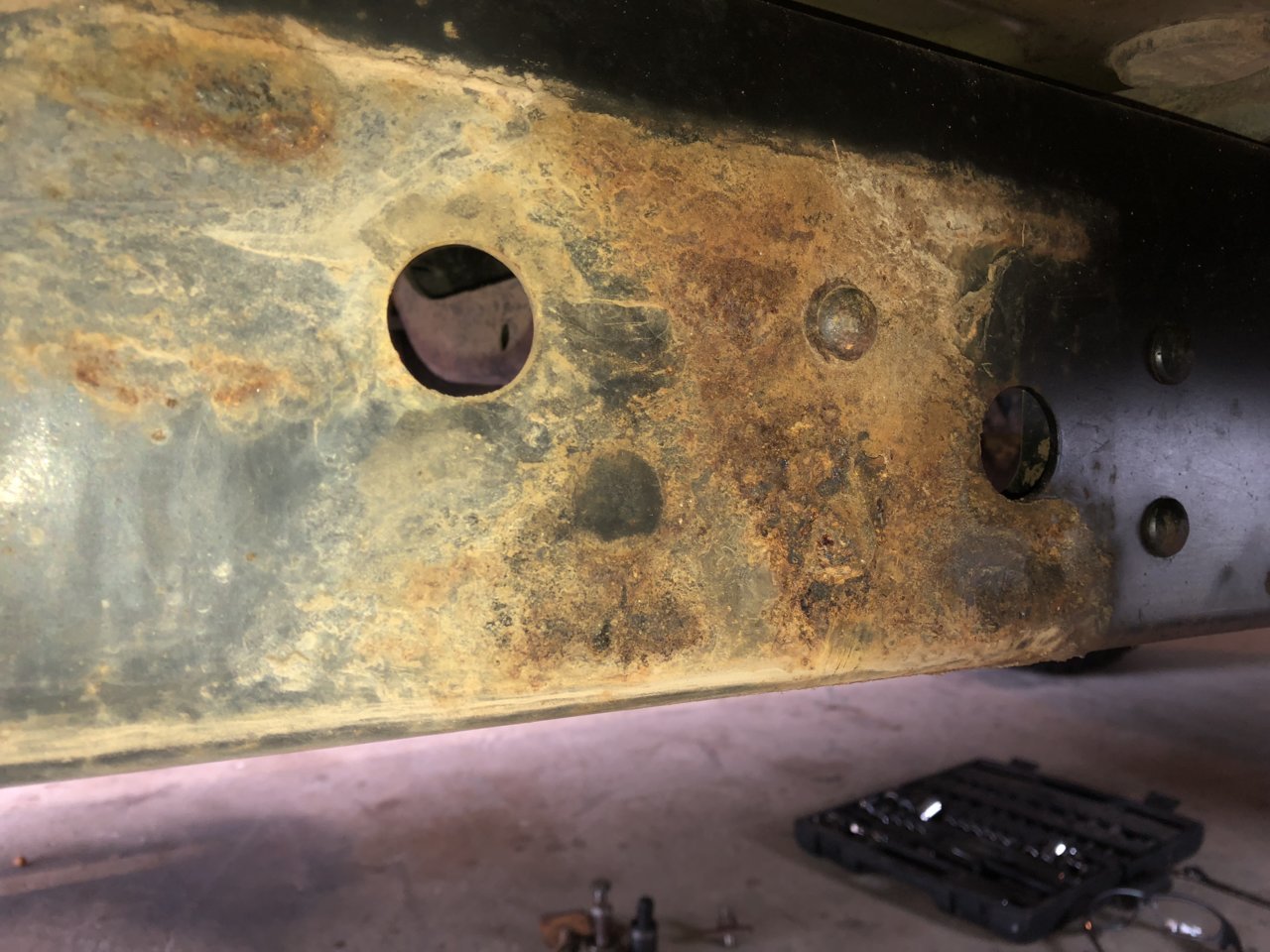

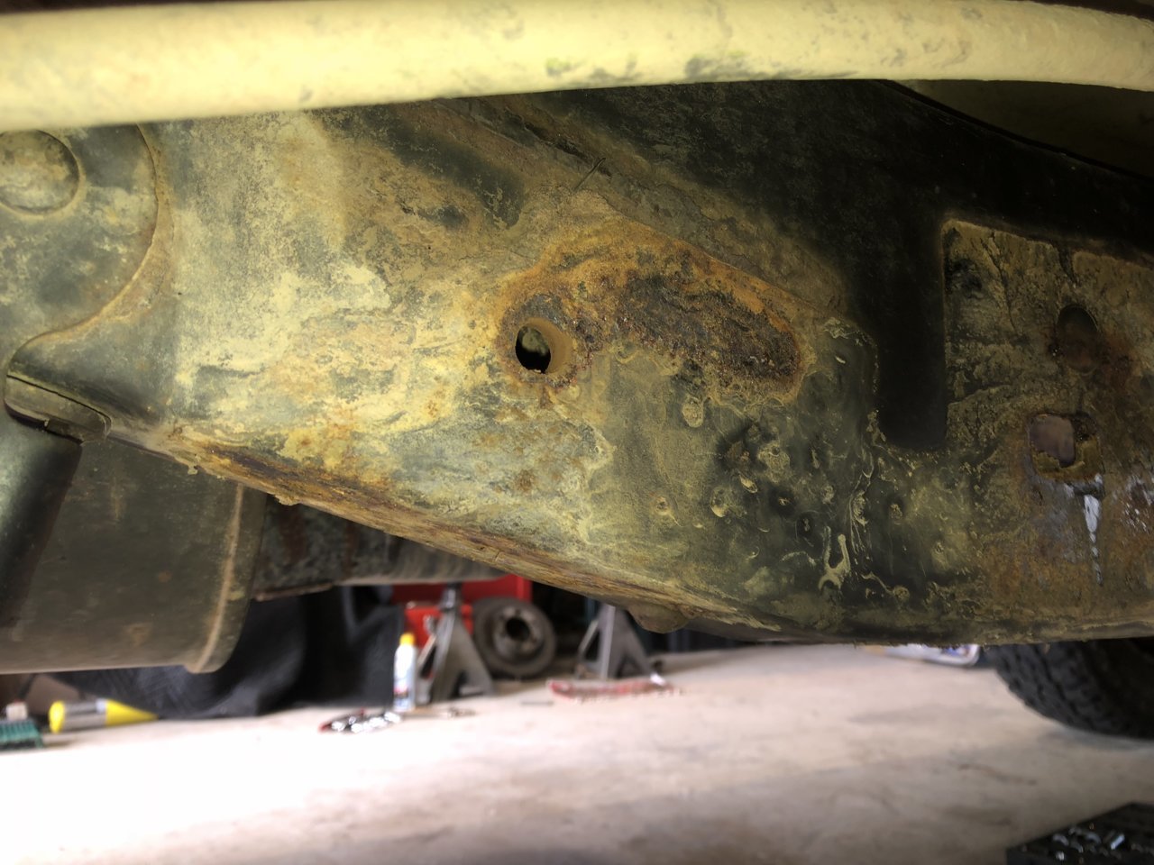

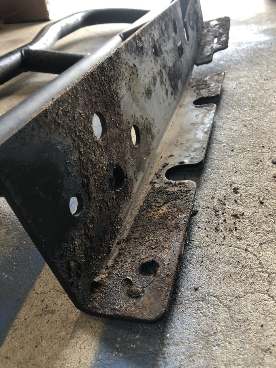

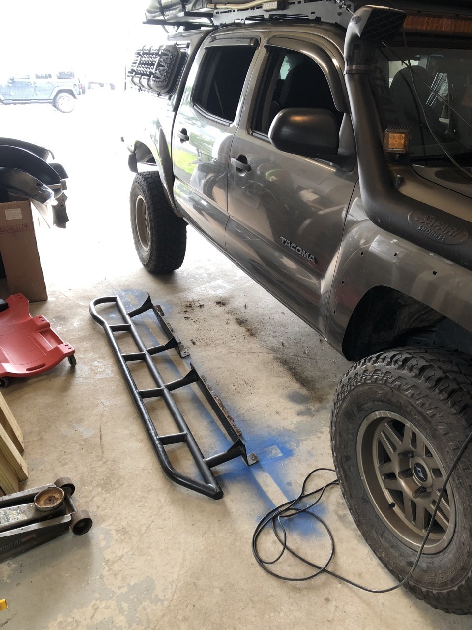

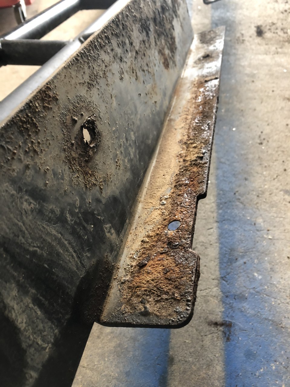

    Here’s a look at bolt on sliders removed 4 years after install. I’m removing to clean them up, skin the top like a step, and repaint, as well as coat the frame rail and plates with anti-seize like butter on toast. Not saying the corrosion is that bad but it’s there and if I let the sliders stay bolted on longer than it would most def manifest to frame rot. If I was to do it over again I’d do weld on sliders. And no I’m not gonna cut this set up and weld them on.. wanna see how all the anti-seize does. Possibly next go around I’ll weld them on if I get the same corrosion results.
