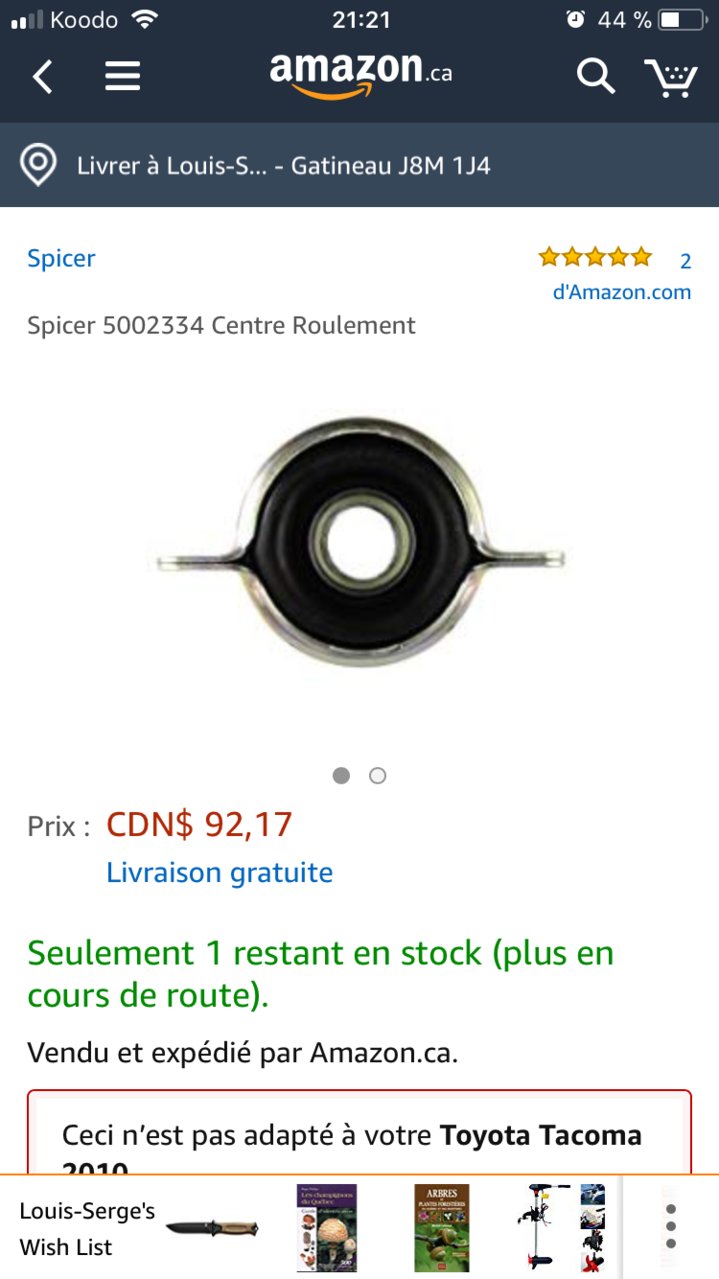

    Should do the trick. Will try to find the same on .ca

    I’m sure if you search the part number it’ll come up!

    Amazon says it wont fit my 2010 Tacoma, is that true ?

    Still wonderng why Amazon tells me it wont fit...o_O i know they aint no mechanic, and I trust you more than them, but still wondering lol

    I never trust Amazons fitment thing! I always just find the correct part number on another site and use amazon for purchasing only. The only possible thing I could think of is if 4cyl is different, but I don’t think that’s the case.
