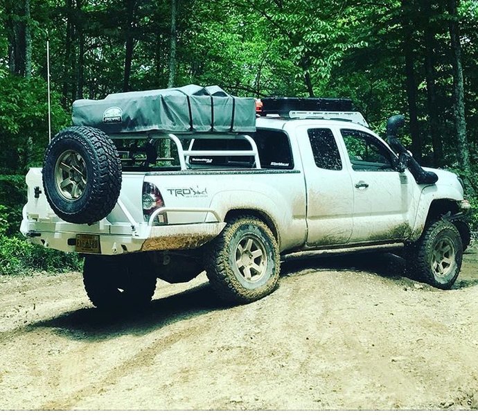

    this picture was about a year ago. Many changes since. A long long time ago, I started with 885s/OME Nitrochargers and Dakars.
    This is today:

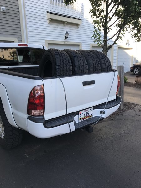

    Routed a lock cable down through the frame, and it's got a pretty stout lock on there. Fingers crossed no one steals them!! I have no more storage in my garage since some snow tires are taking up the only available space. Luckily they'll only be in the bed for a week until we move, and I can leave them at the house.

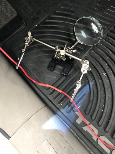

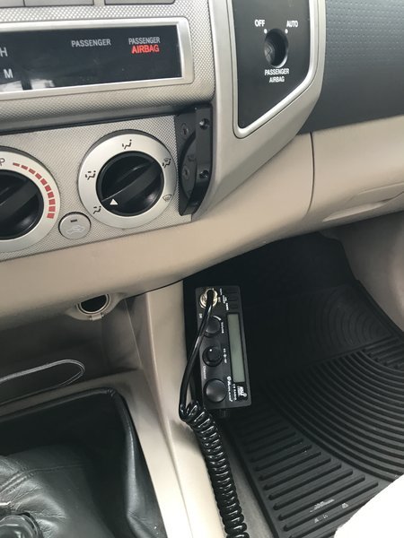

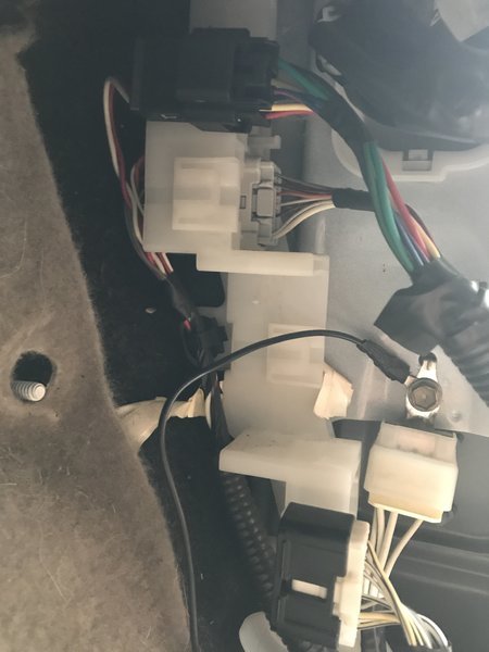

    Installed CB radio. Antenna comes tomorrow
    This is behind the passenger kick panel, and where I grounded my last CB with no issues.
    This little thing is so damn handy.
    Going to fab up a mount for the mic tomorrow if I have time.

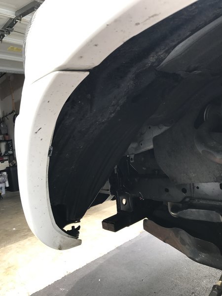

    Shoved fender liners forward to create additional clearance. All I did was remove the two bottom screws and one clip, and just zip tied them out of the way.

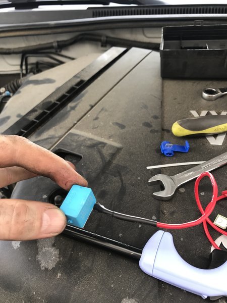

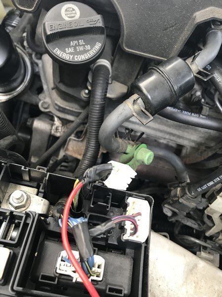

    Did the anytime fog light mod, but a little differently. I didn't have a female spade connector, so I just soldered the wire directly to the relay. For the other side, I didn't have a wire tap capable of tapping a wire that small. I just stripped some wire back on my added fog wire, and shoved the copper strands into the green wire pin, and taped it up. Less intrusive, and still works!! Those are now my DRLs
