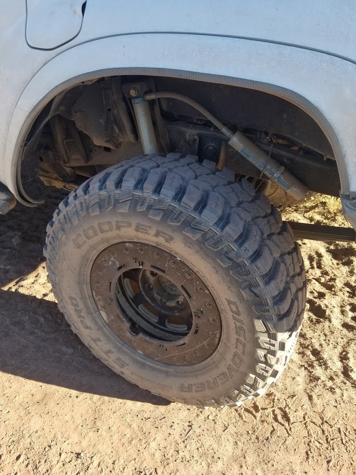

    WOcfLQ4j9RymMfCrRnAZetGB2MMNCshj3PYGHtmW_39f870419e5e7f97ca9158e5c05d4077f7c9efb2.jpg
  15. Nov 8, 2018 at 7:21 AM
    inesshell
    inesshell blah blah blah
    Aug 2, 2011
    #60986
    7,166
    All stock Superwhite 10' AC
    @TaKoToy
    for the trouble of relocates, i would have honestly stuck with b110s and spent money elsewhere
    otherwise ive enjoyed having rear resi alot on the long corrugated roads and long desert trail roads. they soak up a lot of stuff and just make blasting at speed through those two situations more comfortable

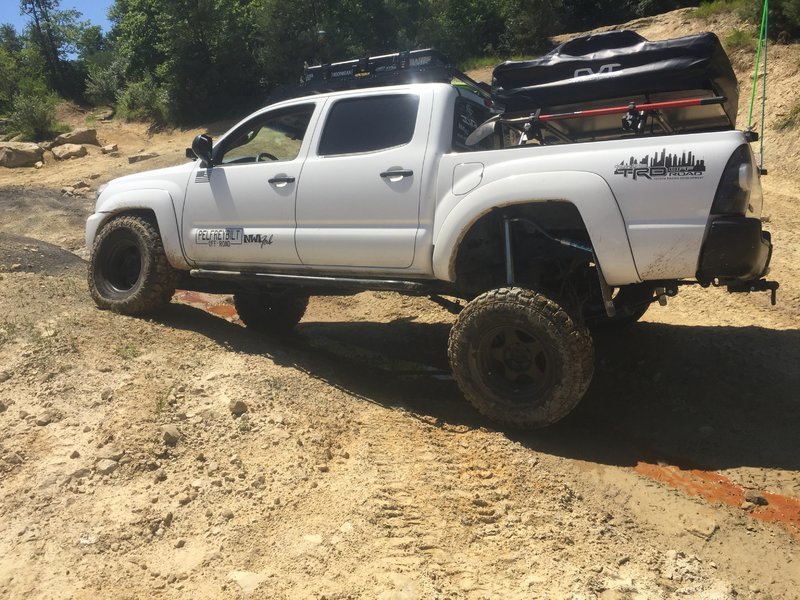

    Just wanted to throw my hat into the ring regarding the 63 vs non-63 swap with shock relocation and shackle flip.
    I ALMOST went the 63 route. Had most of the items to do it except for the kit from RuffStuff. Decided not to waste my time spending 2 days at a buddy's house to do the swap. At the time, I was planning a wedding and just purchased a house and the wife was going through some family stuff. The 63's and everything I had for that went to my little brother. I don't think the pain is worth the reward depending on how/where/frequency of time you spend offroading.
    Same ORV park, same obstacle to flex on, SIMILAR results. Having not taken a tape measure to it, my guess would be a difference of 1.5"; not really enough to warrant a pissing contest.
    Mine:
    Full dakar leaf pack with DK29XL AAL
    ATO stock length shackles
    BAMF shock relocation
    Bilstein 12" shocks
    285/75/16's
    My little bro:
    4 leaf Chevy 63's
    Ruff Stuff kit (6" shackle)
    12" Kings
    285/75/16's
    (his rear tire is SLIGHTLY lifted off the ground in this pic)
    The little bro is moving to 14" Kings with the front Ford shock towers soon.

    I think there they're so similar because you're both running 12" shocks and I bet that's limiting his travel. If you look at rattletraps truck with 14" shocks his droop is utterly insane. Again though, not worth it IMO for the amount of work that goes into it. You and I are on the same page.

    Correct.
    If you plan on sticking with 12" shocks, 63's don't really matter. Where you start to see the difference, IMHO is 14" shocks or MOAR. At that point, however, you're cutting into the bed or running a flatbed at 16"+.
    I am not sure if some of you have seen, but Nathan's truck with a flatbed running 18" shocks is nuts. His droop is INSANE. But, a lot of work went into his. Again, I think people underestimate this mod when you have people like him with 18" shocks thinking they will get the same results on 12" shocks.
