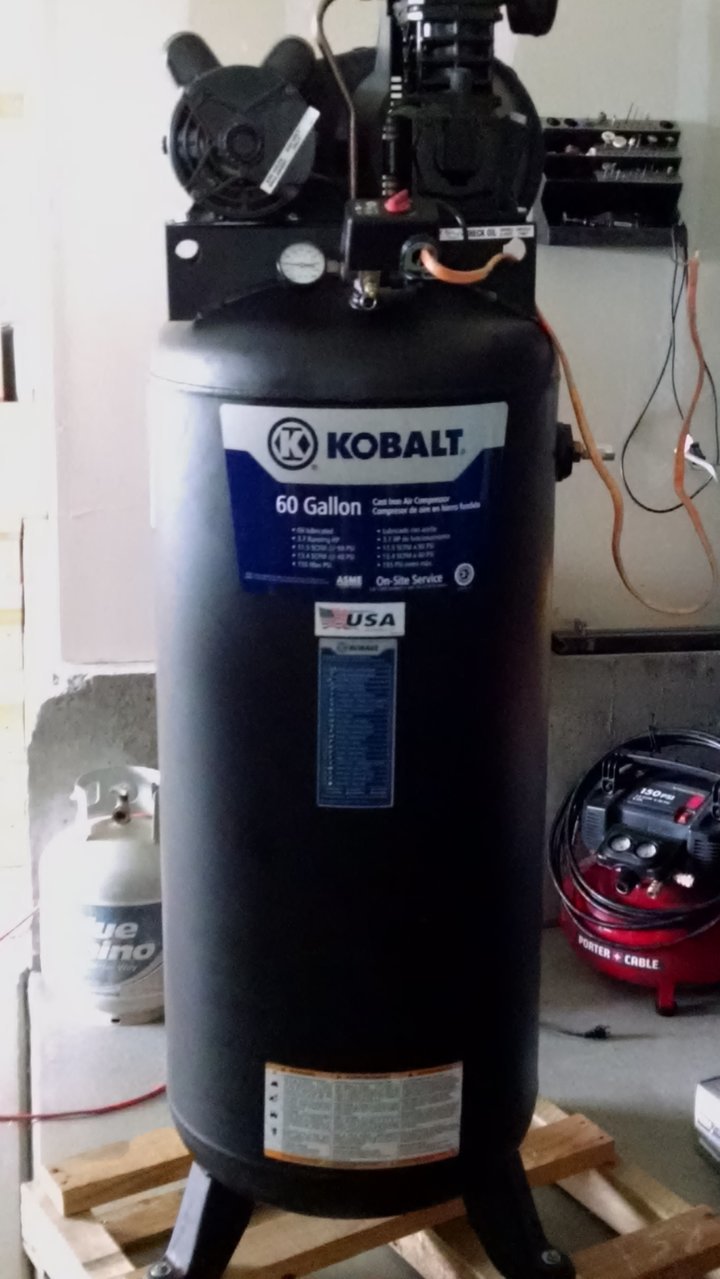

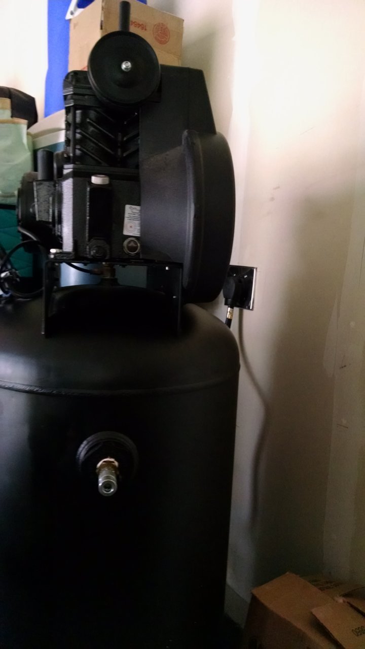

    12/2 is fine for 20 amp. That is how I wired my whole basement. 14/2 for 15 Amps. When I wired my 220 outlet in my garage for my compressor I ran 10/3 to a 30 amp breaker. For 220 runs, the longer the run, the heavier gauge wire you need to run.
    In reality, the quality of modern solid copper wire and the conductive properties of it, you could likely pull 20 Amps through 14/2...but I dont know if it's worth the risk.

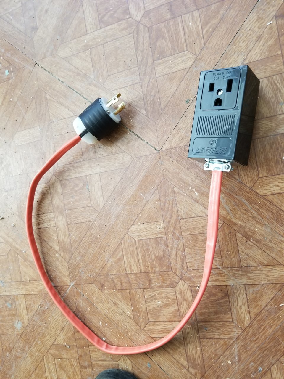

    I didn't make an extension cord, but I DID make an adapter to plug in a tig welder to a gas generator. It consisted of a twist lock 30amp plug, 10/3 wire (4 conductors, black, red, white, and bare ground) and a 50amp 3 wire range receptacle. In the range recept, I combined the ground and the white.
    14 gauge wire = 15amps
    12 gauge wire = 20 amps
    10 gauge wire = 30 amps
    Amps are determined by the breaker. You need to make sure the wire is sized properly to handle the amps, otherwise :bananadead:
    Here's a pic of the adapter I made. Making your own extension cord should be easy.

    The code says 80% of the amps should be on the circuit. So in reality, 80% of 15amps should pass thru a 14 gauge wire.
    You could have probably used 10/2 for your compressor. It likely didn't need a neutral. Neutrals are needed when devices that are being used have a need for 110 volts. I doubt the compressor had any kind of LED lights or anything like that?

    No leds or anything other than the motor running. Wired to a 4 prong dryer plug.

    To further expound on what I said....
    Extension cords are generally made better than regular romex (pictured in the adapter I made). BUT SJ cord is rather expensive compared to romex. SJ cord has each conductor insulated and is stranded, with a better, more resistant to scrapes, coating. That being said, if you're going to use the extension cord only your welder, then I'd be ok with it. Just take care of it, dont snag it on shit. Roll it out when you need it and roll it back when your done.
