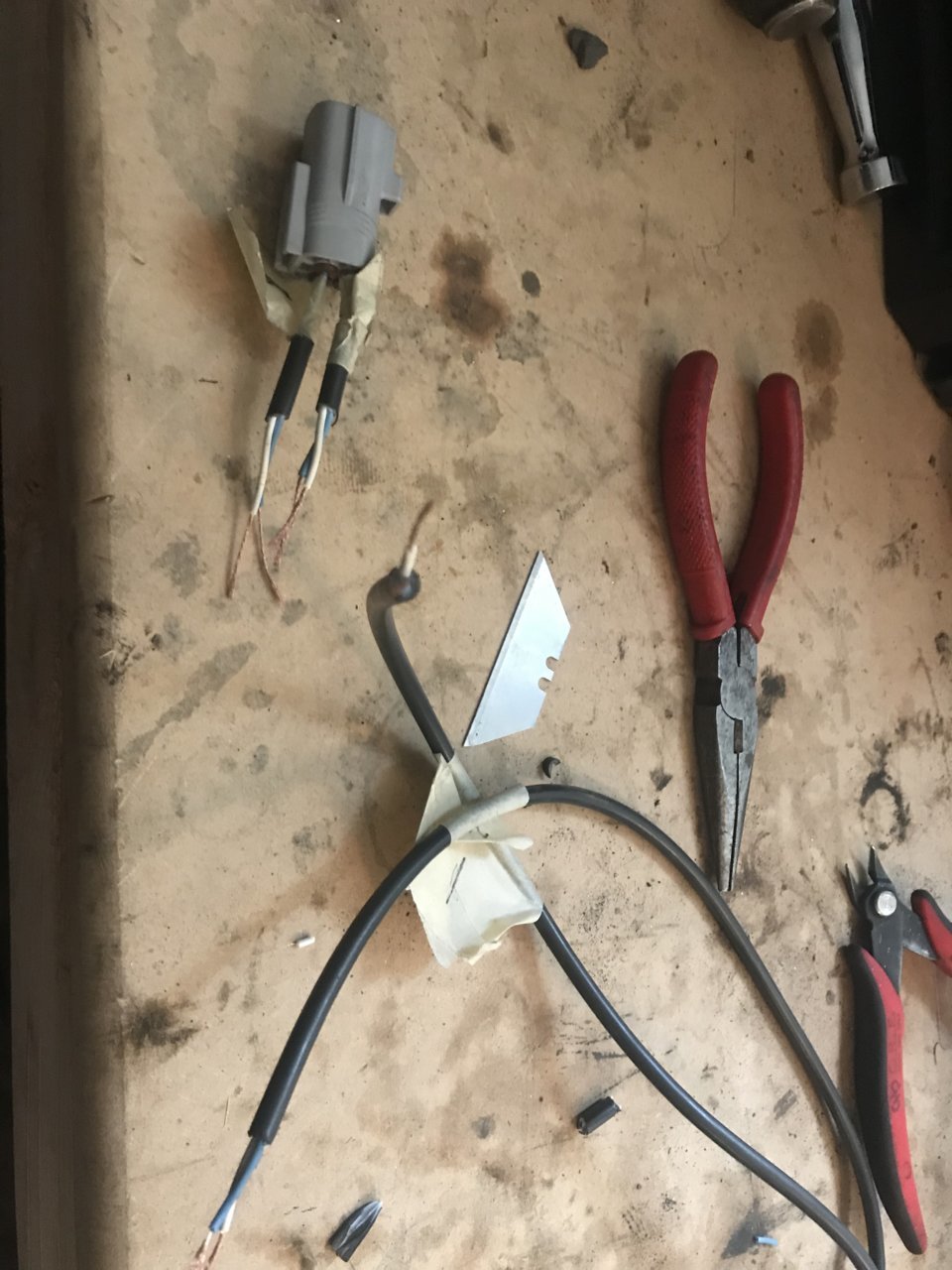

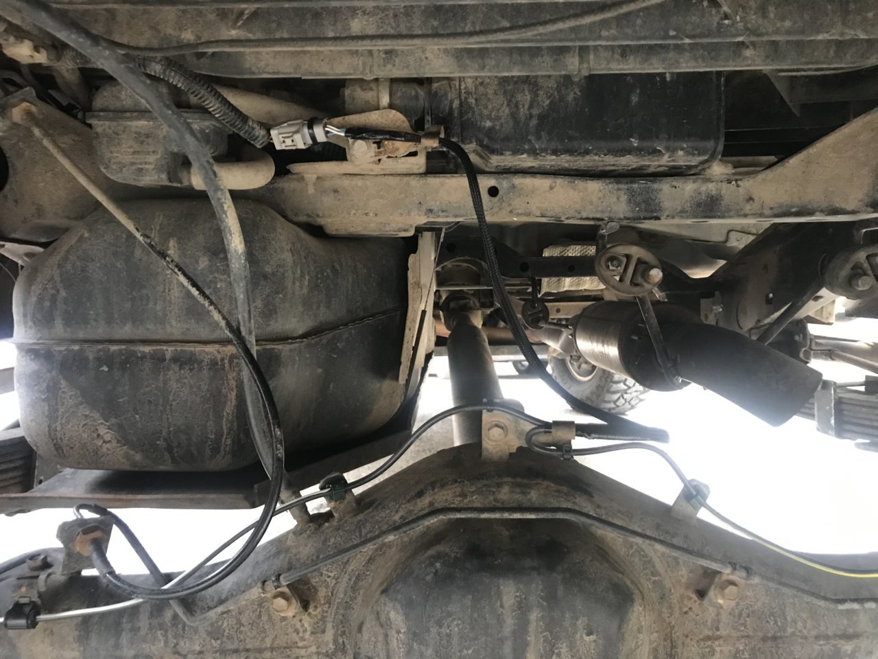

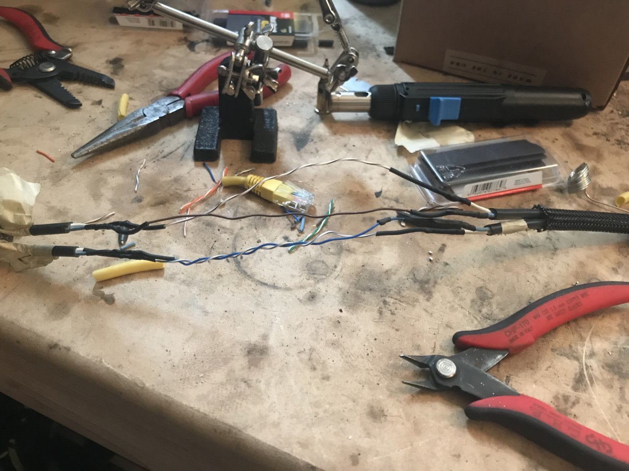

    Today’s project, replace my broken ABS harness, and simultaneously extend it 4”-5”. First I installed my new harness and went for a test drive to make sure it worked, and it did.
    Took it back off and went inside and used some CAT5 cable to extend it. Soldered and heatshrunk, and some Chinese finger trap on it. Looks damn good if I say so myself.
    Reason I did this is while up on the 2 post lift (where both sides are able to droop) it gets tight. I wanted the peace of mind for when the 12” shocks go on.
    Later this week I’ll make a drop bracket for my parking brake line. At full droop it’s tight, so it’ll only get tighter with 12” shocks. Just a simple piece of steel to lower it 1.5” to help take the strain off it.
