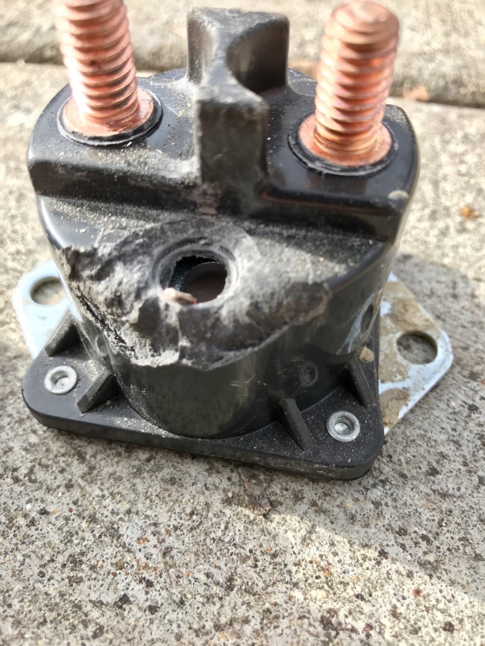

    My money is on a winch solenoid..that's what it was for me at least

    Was it something you were able to fix for free or did you need a new solenoid?
    What’s weird is as I was plugging my controller in, I jumped a few pins on accident and the winch moved. Done that plenty of times. So I know the motor and stuff is good. And we tested someone else’s winch controller, so it’s not that. Checked battery connections, those are solid. It has to be solenoid related.

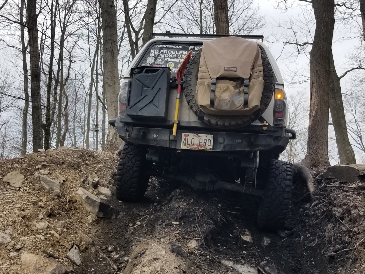

    need more droop
  4. Mar 30, 2019 at 7:53 PM
    EatSleepTacos
    EatSleepTacos [OP] Well-Known Member
    Mar 24, 2015
    #151688
    59,830
    Randy
    West Valley, AZ
    2017 4Runner
    That’s where this pic came from. I still had more down travel on both sides, thank you very much :p

    New solenoid

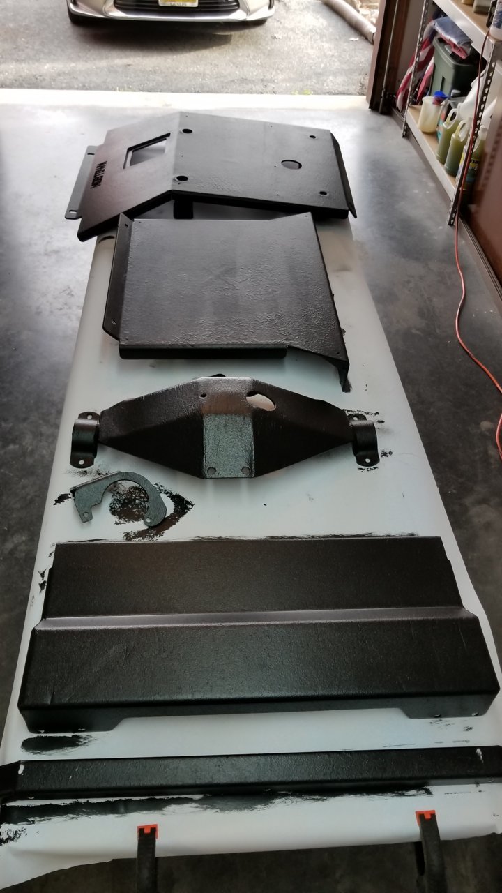

    Got up early and got the last coat on. Install is tomorrow.

    They're cheap you can use an old ford style starter solenoid like from a 60s-80s pickup or car. They aren't attached to the starter on them so they work. I would get one for the biggest truck with the biggest motor. Let's say a 70s era 1 ton with a 460 BB those starters drew a lot of amps so the solenoid is beefier. You can get a few of them and keep them as spares. Pro tip they also work for a lot of older outboard engines and can adapt to have a remote style solenoid on chevy starters.

    Damn Roberto! You qre going all out. The red looks perfect on there also. It will let everyone know she is a lady in the street but a freak in the sheets.
