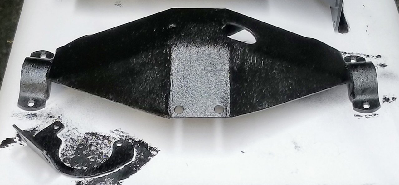

    Ok Kidz, since I bought it here I'm going to post it for sale here first, then in other threads. Randy suggested the NoVA thread. Lastly, I'll post it out in the general B/S/T threads but wanted y'all to have first dibs.
    https://rcimetalworks.com/product/05-15-tacoma-rear-differential-skid/

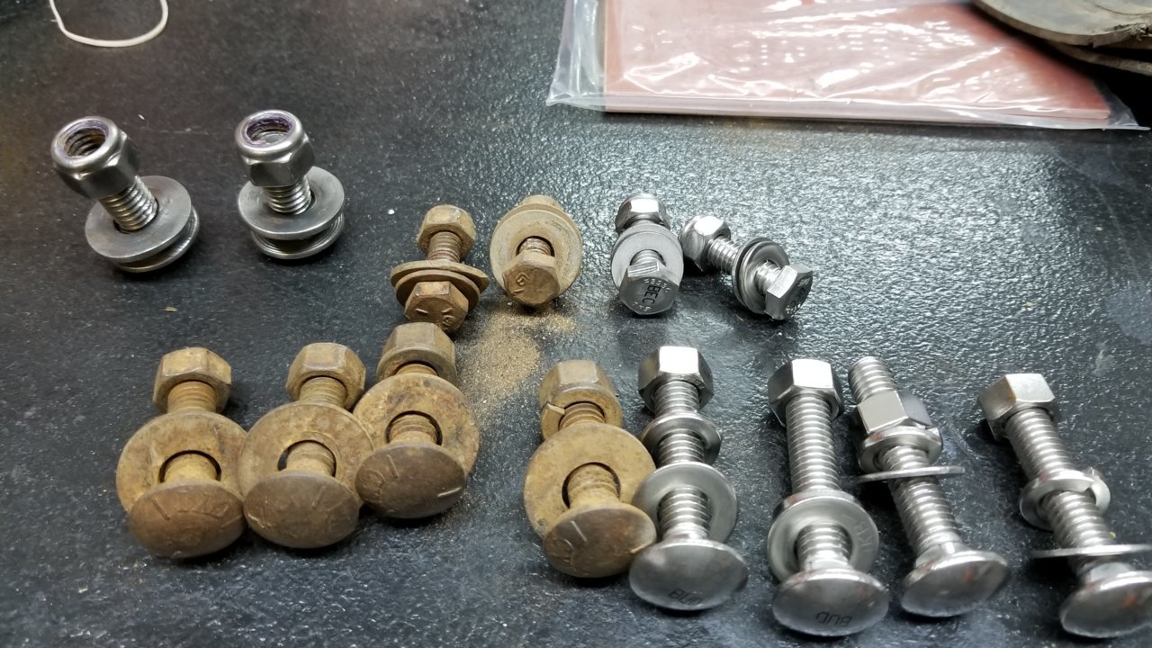

    Here's a couple pics of it after I ground all the loose powder coating off, inside and out, then shot it with 3 coarse of self etching primer, then 4 coats of bed liner paint. It's practically better than new. I also upgraded all the hardware to SS, and even replaced the rubber axle gaskets with a higher density rubber material.
    I'm only asking what I paid for it. $150. And I'm throwing in the new hardware, rubber gaskets, and all my time to prep/paint, and the cost of paint.
    Once I put out in the general public threads the price is going up.
    Note! This does not fit a 3rd Gen!

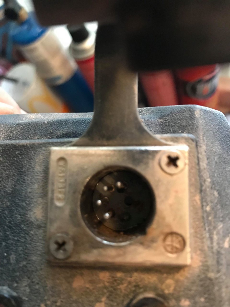

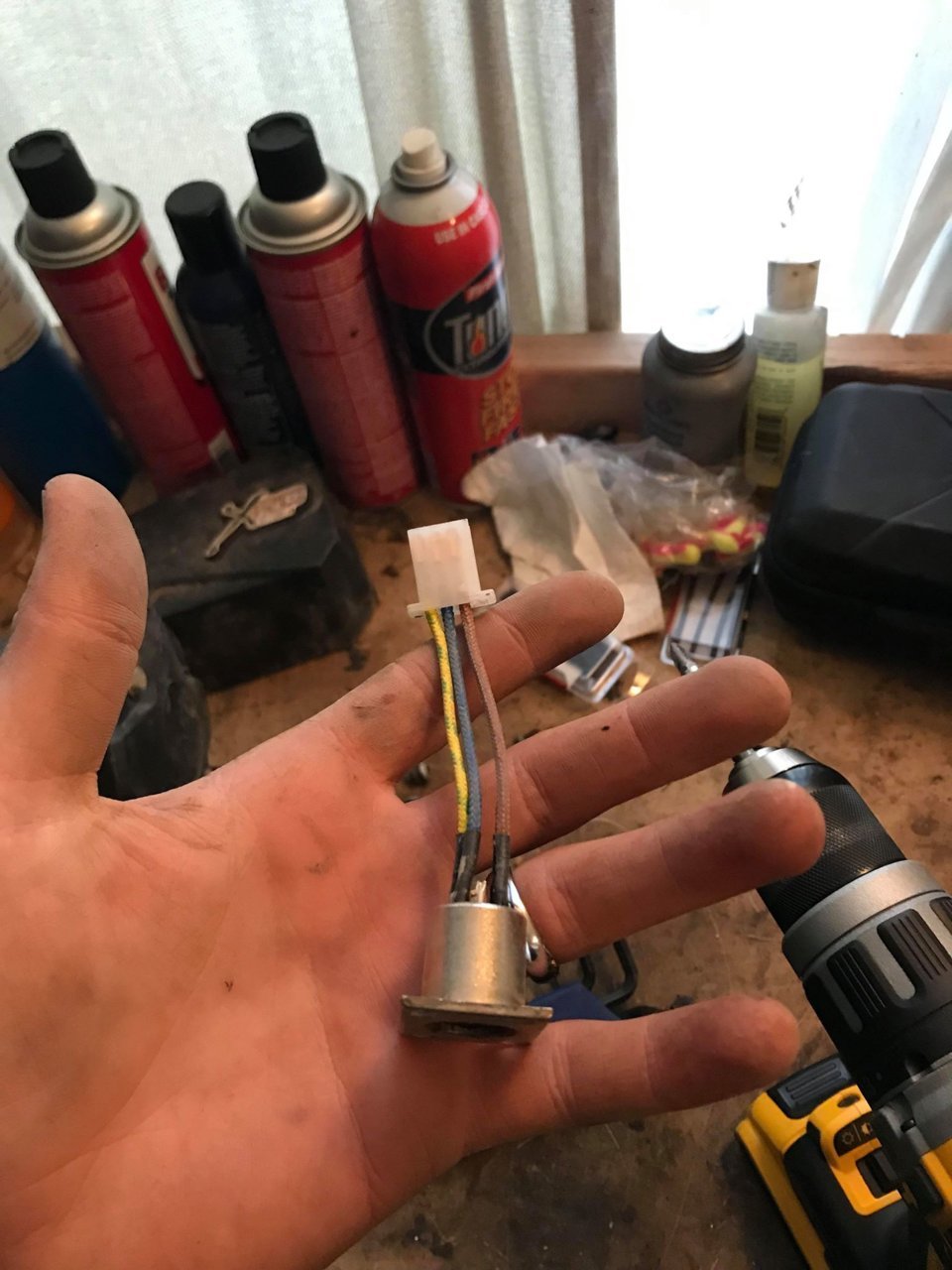

    Oh it was a controller issue not winch issue..
    Slashaar and geekhouse23 like this.
  12. Mar 31, 2019 at 7:14 PM
    EatSleepTacos
    EatSleepTacos [OP] Well-Known Member
    Mar 24, 2015
    #151688
    59,844
    Randy
    West Valley, AZ
    2017 4Runner
    Kinda sorta. The part on the winch the controller plugs into was fucked, so I’d call that a winch issue still. Either way it was a bummer that I couldn’t winch myself when I got high centered. At least it’s an easy fix and an opportunity to improve upon it. I plan on a dab of dielectric grease in there to prevent corrosion and keep this from happening again.

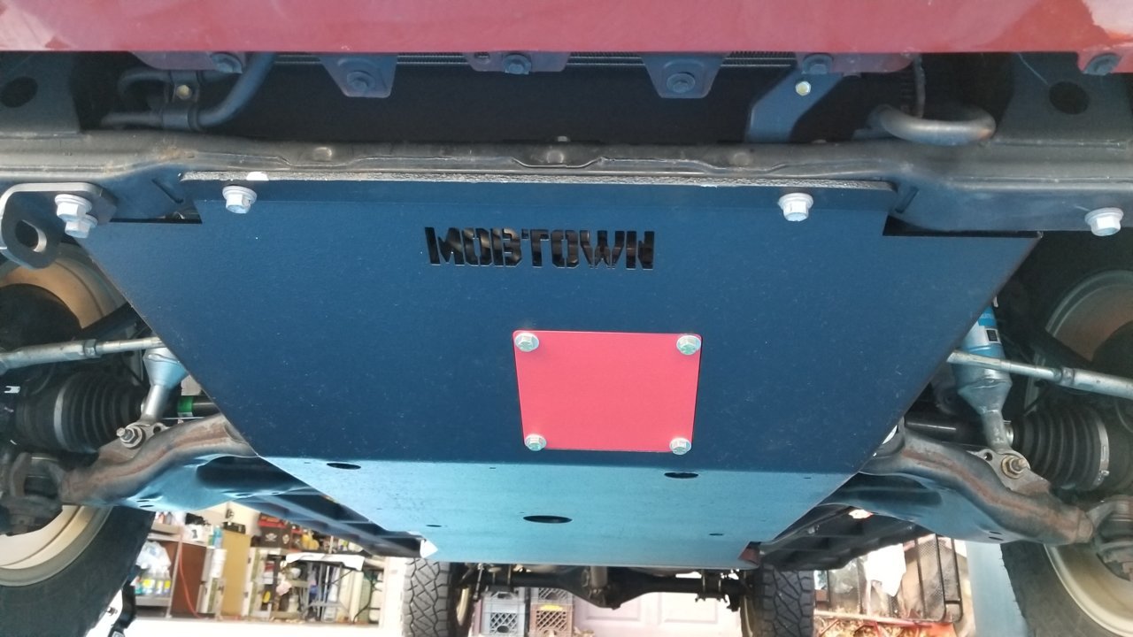

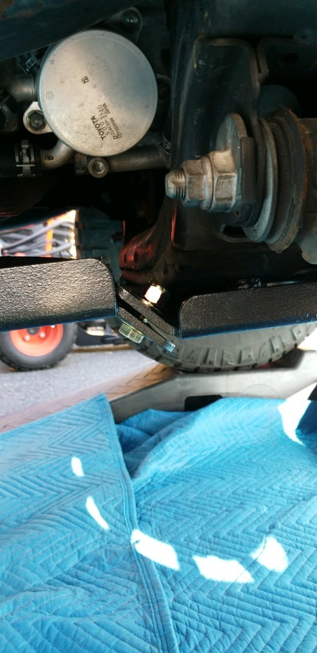

    Then there's this! :smokertransformer:
    I had a 50/50 chance on the mate up of the IFS & Tranny skids and I should have gone with my gut. Luckily everything was still a loose fit so I texted Randall and he confirmed my fear. I had it backwards. The IFS goes on the outside.
    So I had to drop the IFS and switch the setup.
    Then to be able to get the Transfer Case skid, support bracket frame mounting holes to line up, I had loosen the three bolts holding the support to the skid. Only then was I able to get the bolts into the frame locations. I also had to use a longer bolt (thankfully I keep hardware at the house and had a longer bolt) for the brake line attachment bracket location. There was no way to reuse the OEM bolt. Once I had those two frame bolts in on the support brace I had to retighten the 3 bolts holding it to the skid. Lastly I tightened the two bolts that hold the Tranny skid to the IFS skid.
    All I can say is, once it's all bolted up and tightened down, it becomes a structural part of truck and even though you remove OEM cross braces, all three of these skids make the underbelly impenetrable, and I feel, more sound!
    Once again @Mobtown Offroad FTMFW!!!!!
    Thanks again to Jerry @UntamedTaco and Randall @EatSleepTacos !! Jerry really saved the day with his instructions link, and Randall saved me from myself with his assistance!
    Total time including setup (jacks, jack stands, ramps, tools), bolting everything up, then redoing the IFS skid, and the workaround on the Transfer skid support (includes fishing a nut outta the frame! That shit added 20 min alone!). Then dicking around with the diff diaper! Then putting everything away, and wrapping up the diff diaper.
    Almost 4 hours! The fact that I did this by myself, miraculous!!
