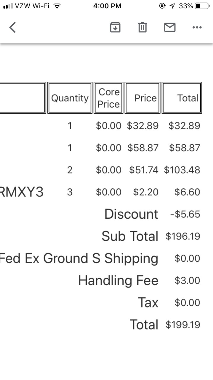

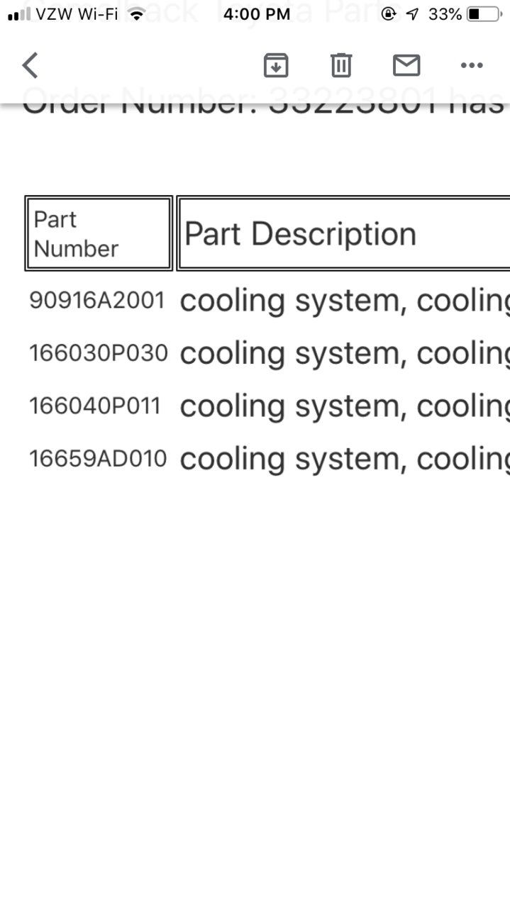

    I did not. I wasn’t sure if he was still around or not. Here’s my parts list.
    BD84009F-37E9-459D-B6F0-0ED0B6122053.jpg 348FA145-B8B3-411A-99CC-3413B68E0EEB.jpg

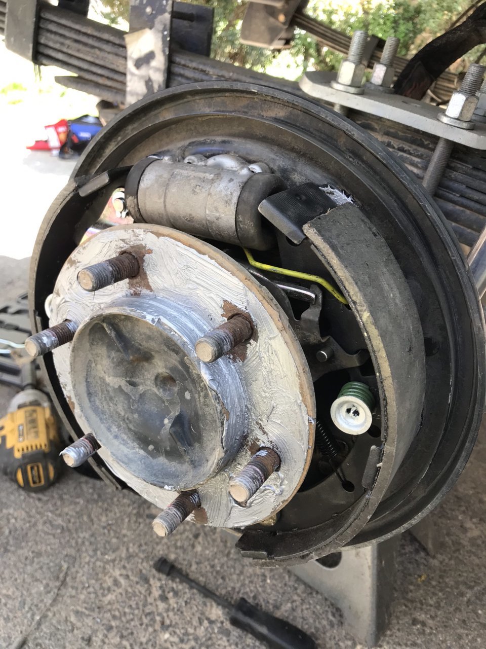

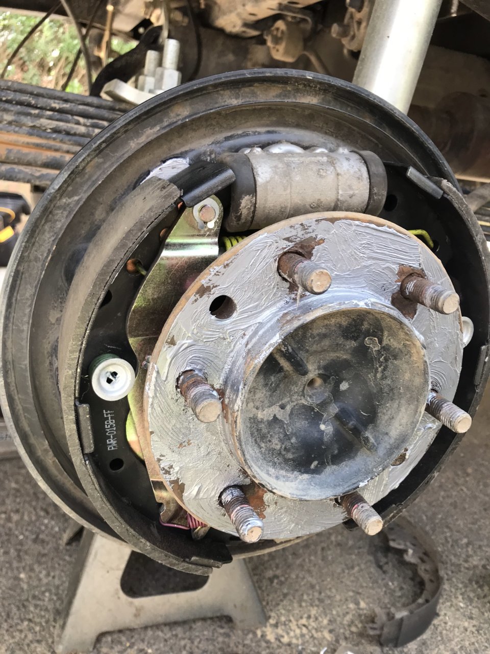

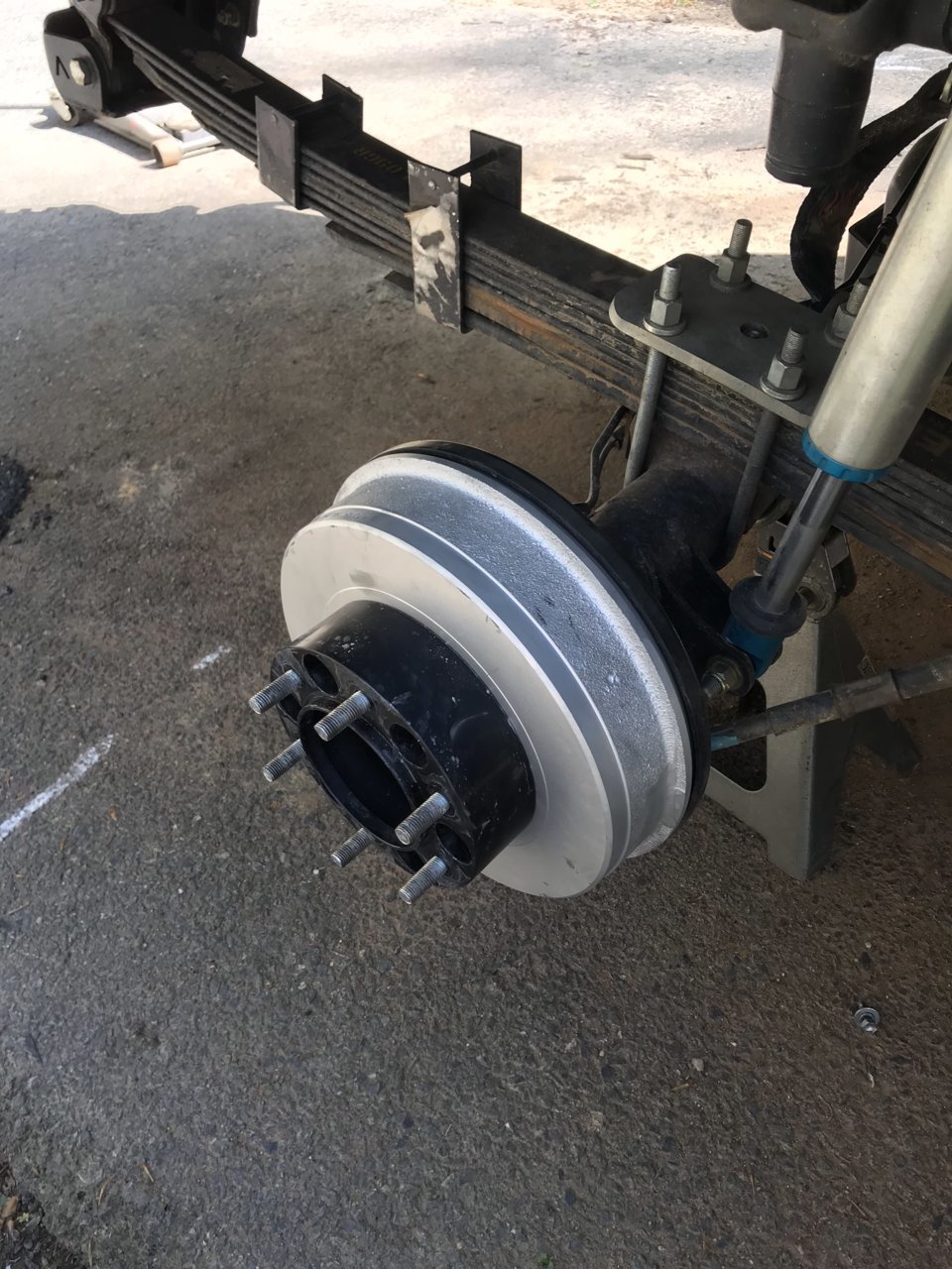

    Replaced my shoes and drums today. I fucking hate drum brakes with a passion now. Learned a lot though and could do another set in half the time.
    91275A63-FA37-4A3F-B26C-D18EE932C808.jpg 44A23C51-007E-4390-B08E-8483E0339FE0.jpg EFA1B2A6-D2AC-47FF-B2ED-F8F41CE4E950.jpg

    Fucking winged the hell outta it. I had a little help from a chrisfix video but it didn’t help as much as I thought. I took pic of it all, and only did one side at a time so I could reference the other side (that saved my ass a few times)
    The reason I hate them now is putting it back together. I got out of order and had to take back out the biggest, strongest spring that was brand new. Talk about an adventure. Had to go buy needle nose vice grips for that one.
    Other adventure was adjusting them. The little access hole is tiny and you can’t see shit. So I had to take the drum back off, figure out how to adjust it blindly, and redo that.
    All in all took about 6 hours, including going to the store to buy the new vice grips.

    Did the best I could, yes. I live on a steep hill, so I did like 5 small laps to where I kept coming downhill, and did 7-8 hard stops from 30mph to 5 mph. Then let the brakes cool. USed my fancy new laser thermometer to check, and the front got to 350-400 and the rear to only 115 haha
