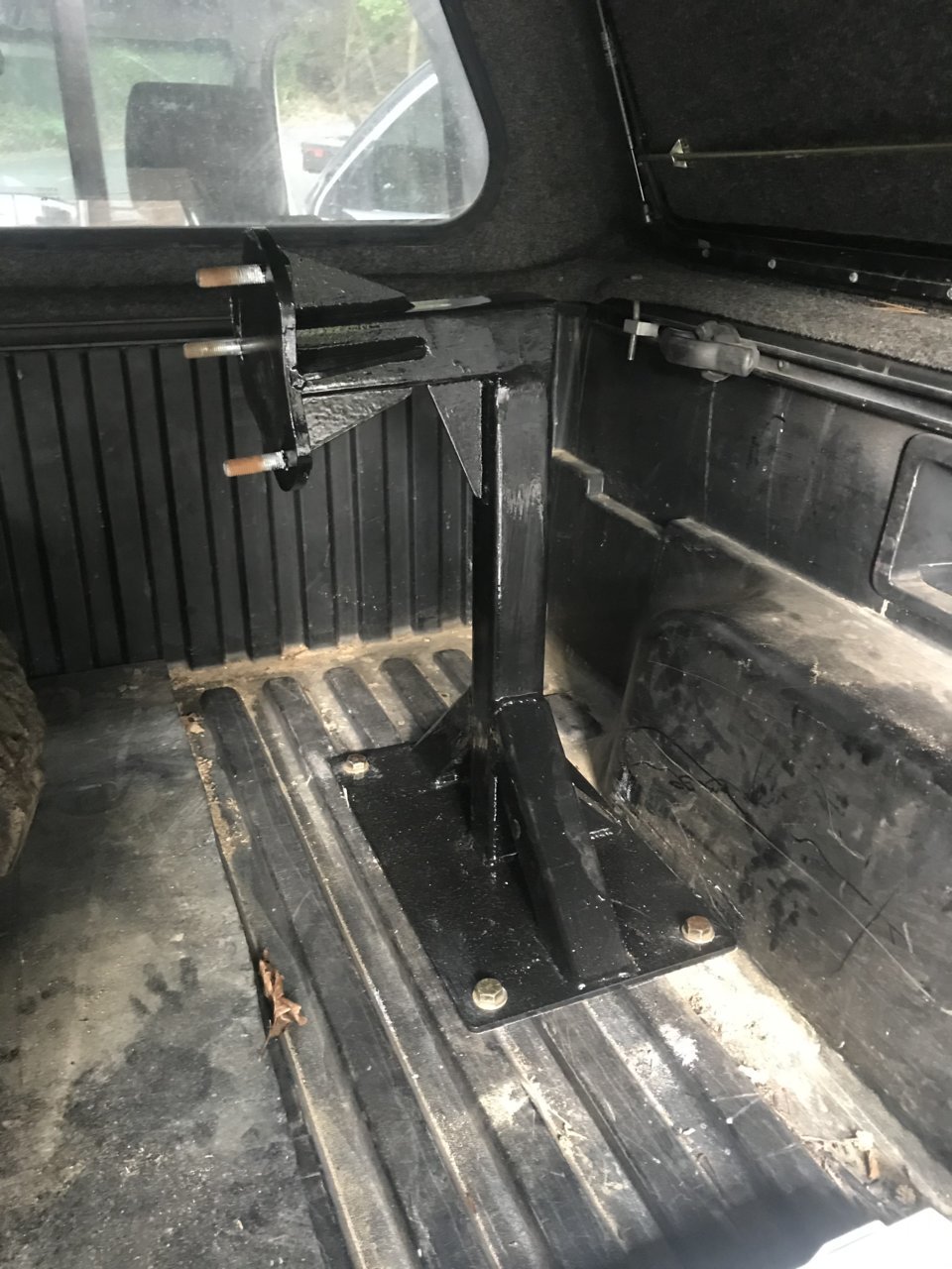

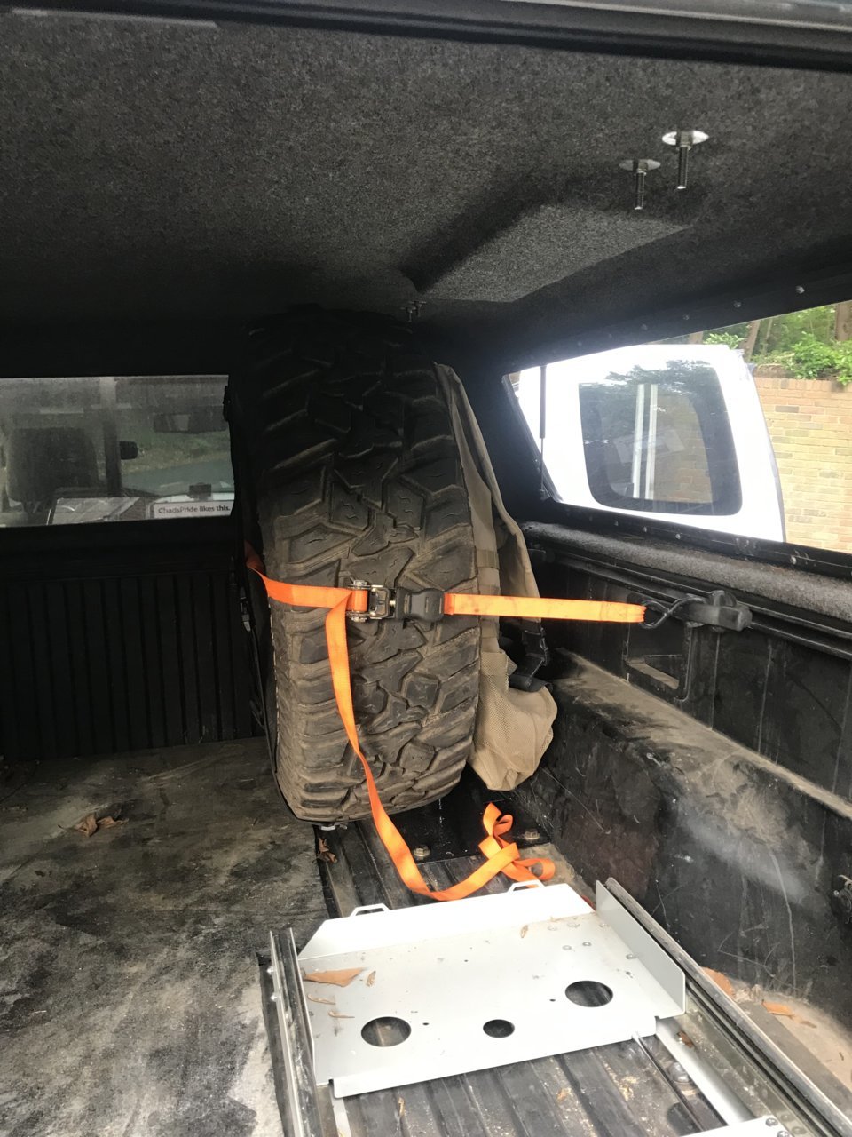

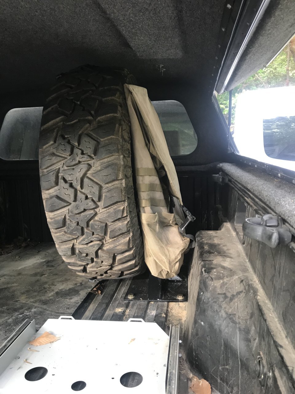

    Did a few things today. Installed the awning, and mounted my tire holder in the bed.
    Overall, I’m not super thrilled with it. The floor of the bed flexes easier than I thought, and it blocks about half of my rear view window. I threw a strap on which really helps with flex, but time will tell if it becomes an issue.
    I may just ditch it and strap the tire to the side of the bed. That way it won’t crack the floor and it will suck it up against the wall more.

    Damn, that sucks Randy! Why did I think it would be closer to the bed side on the mount!? I have an idea but it's too hair brained to bring up.

    you could weld on another bar on the back that reaches the rail and put some t slot nuts in to anchor it instead of the strap maybe kind of sorta if ya wanted too haha doesn't fix the blind spot issue tho hahaha

    Fucking hell that’s a good idea. I’m gonna try that. Thanks erik.
