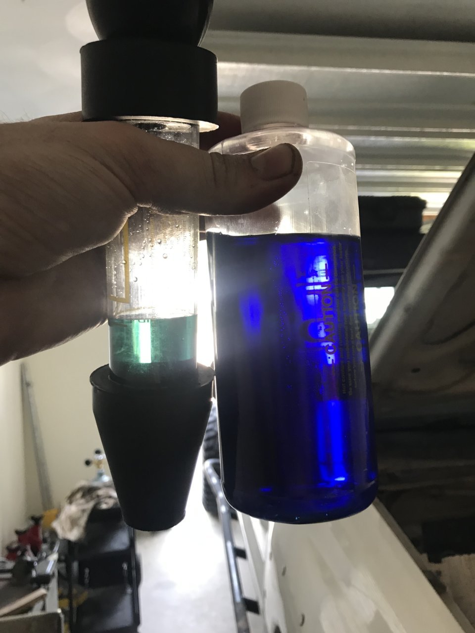

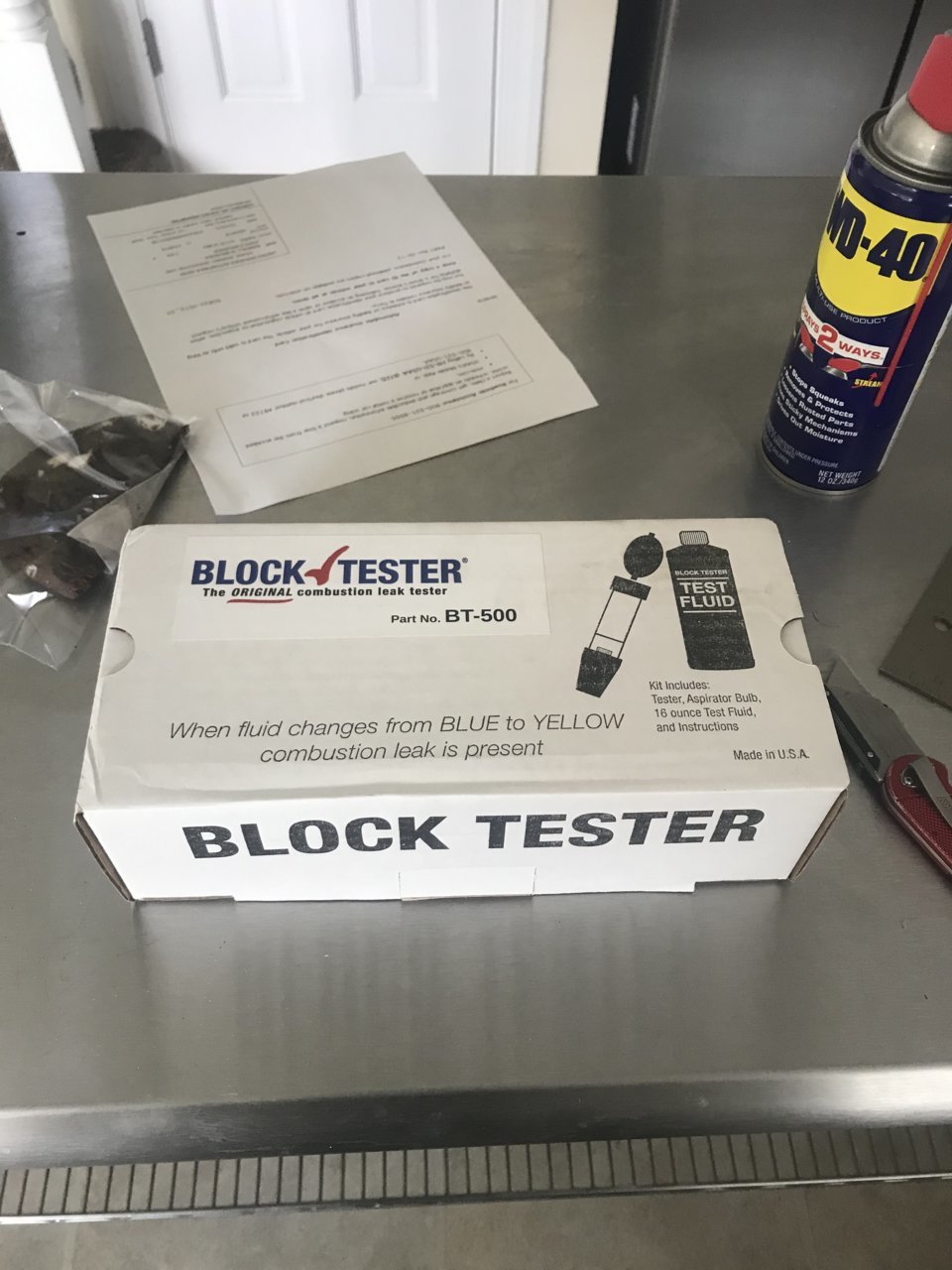

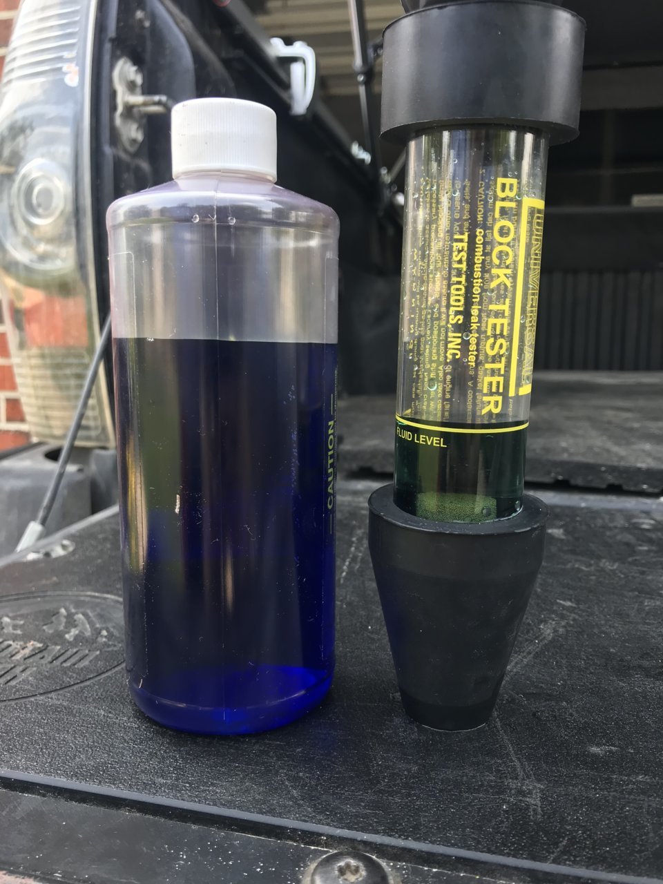

    Checked the cooling system today for exhaust gases, which would confirm head gasket leak. Supposed to turn yellow but instead turned a little green. My conclusion is that there was just a small amount of gases present, aka just a small HG leak.

    It'll turn green if contaminated with coolant. It has to be fairly low to get as accurate a test as possible. They are hit and miss even at that.

    There was no coolant in there. The fluid level remained exactly the same from before and after. I drained about half of the radiator so I wouldn't get coolant in there.

    Gotcha as long as it wasn't steaming then yeah your assessment is probably good! There is no real definitive test for HG sadly. A gas analyzer is the closest you can get but not many shops even have them.
