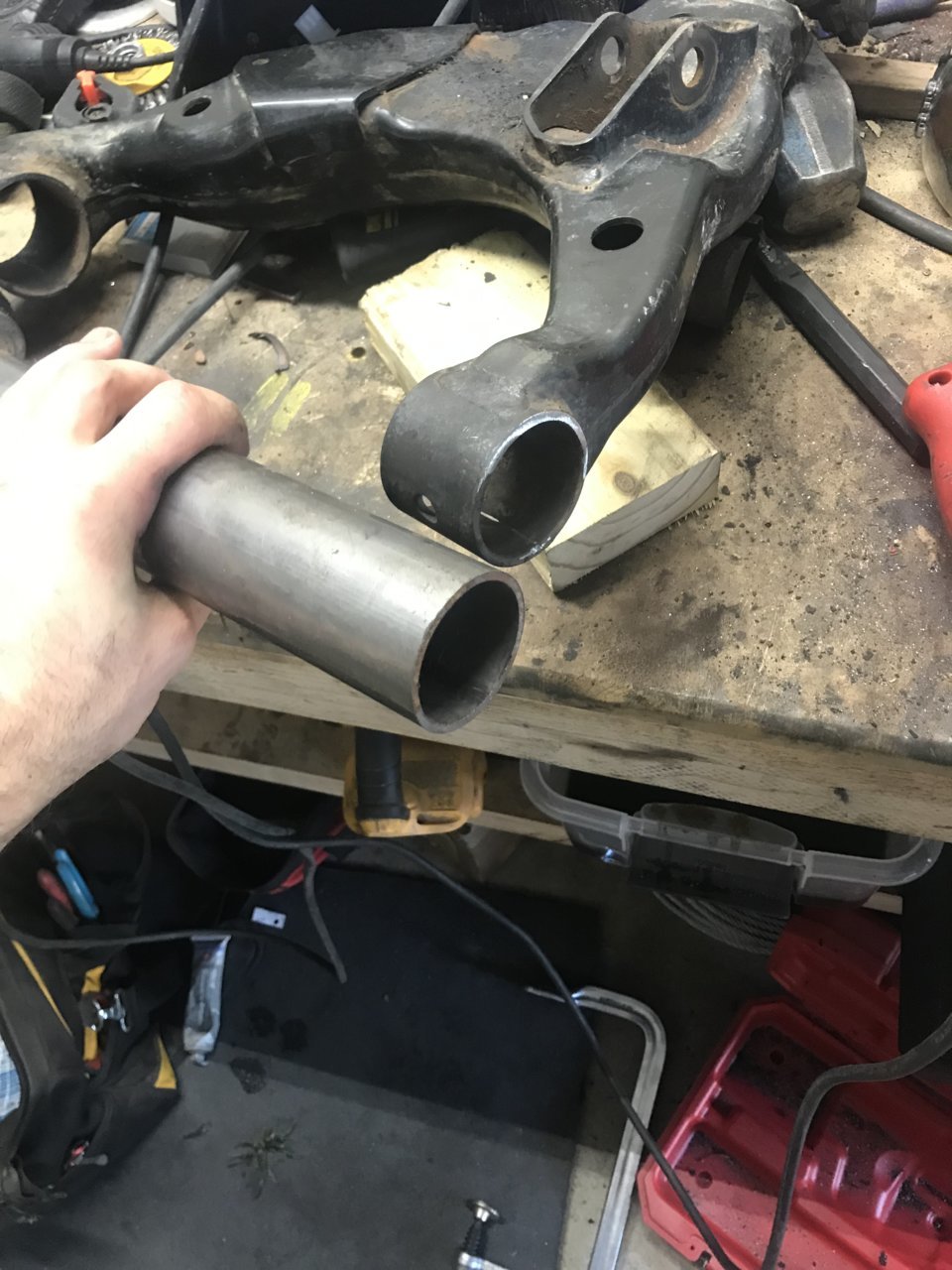

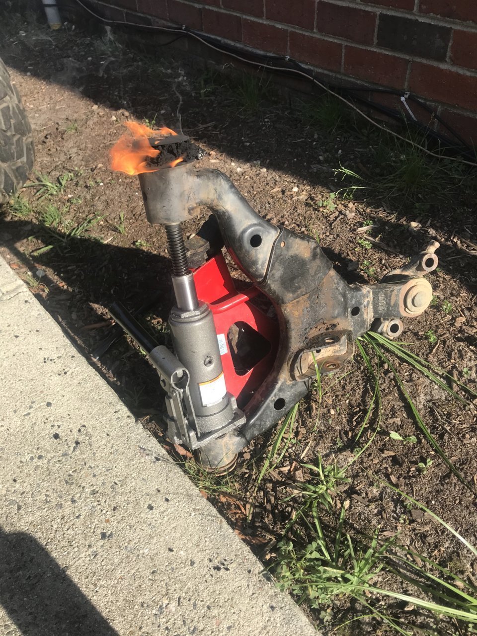

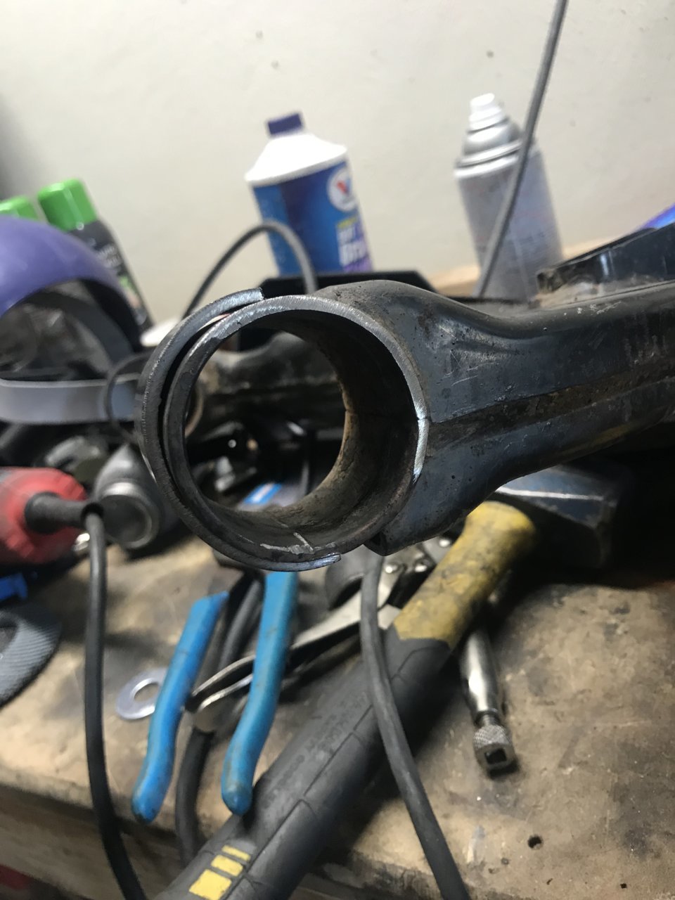

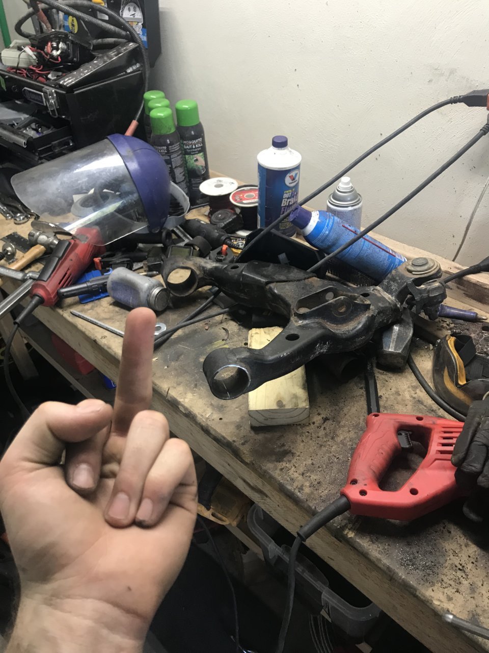

    Boy oh boy is getting the rubber bushings out a bitch. Only did one arm and stopped for the night.

    You know, my bushings came right out. Must have been lucky. (Or skilled)

    Mine most certainly did not. What a pain in the ass.

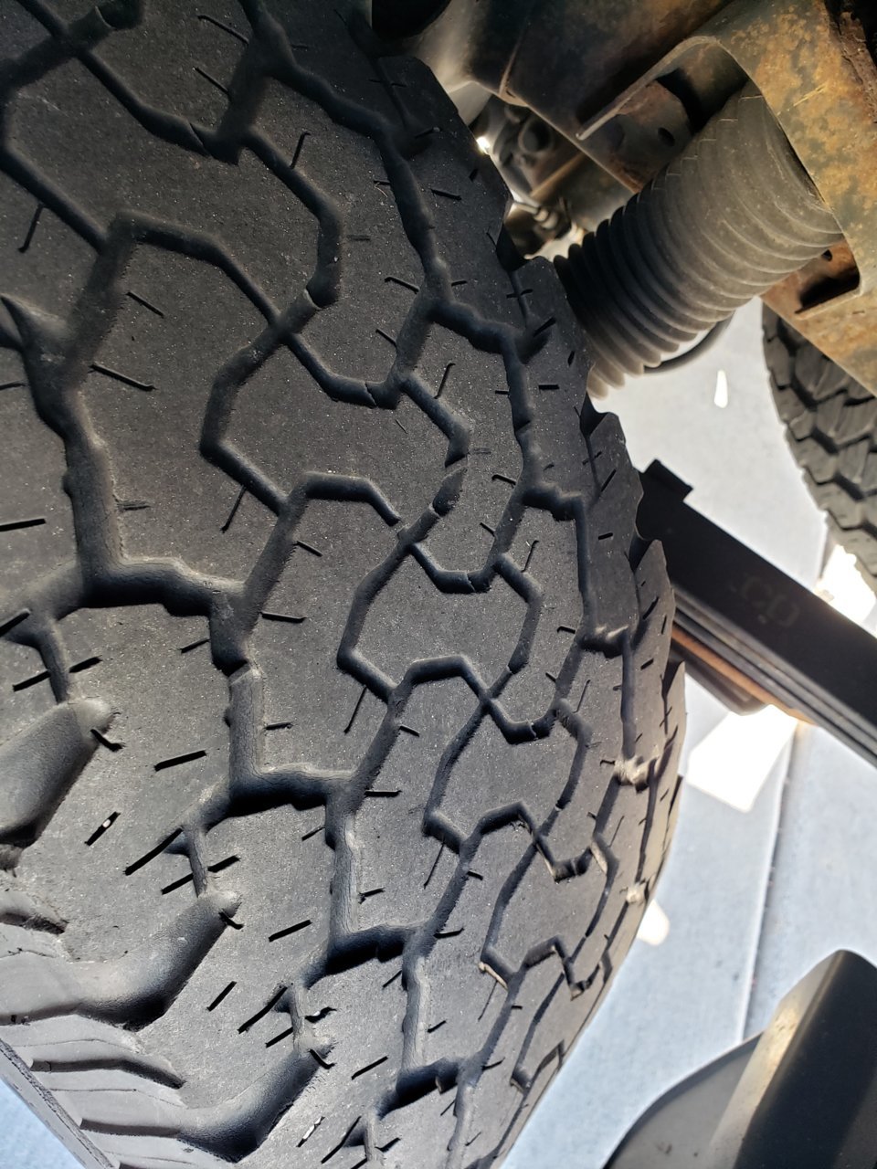

    Need to do something soon with mine. I am to the wear bars...( the picture makes them look like they have far more tread than they actually do)
