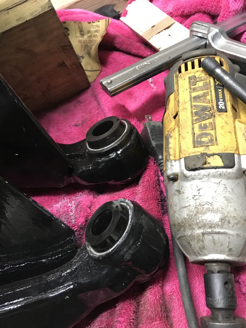

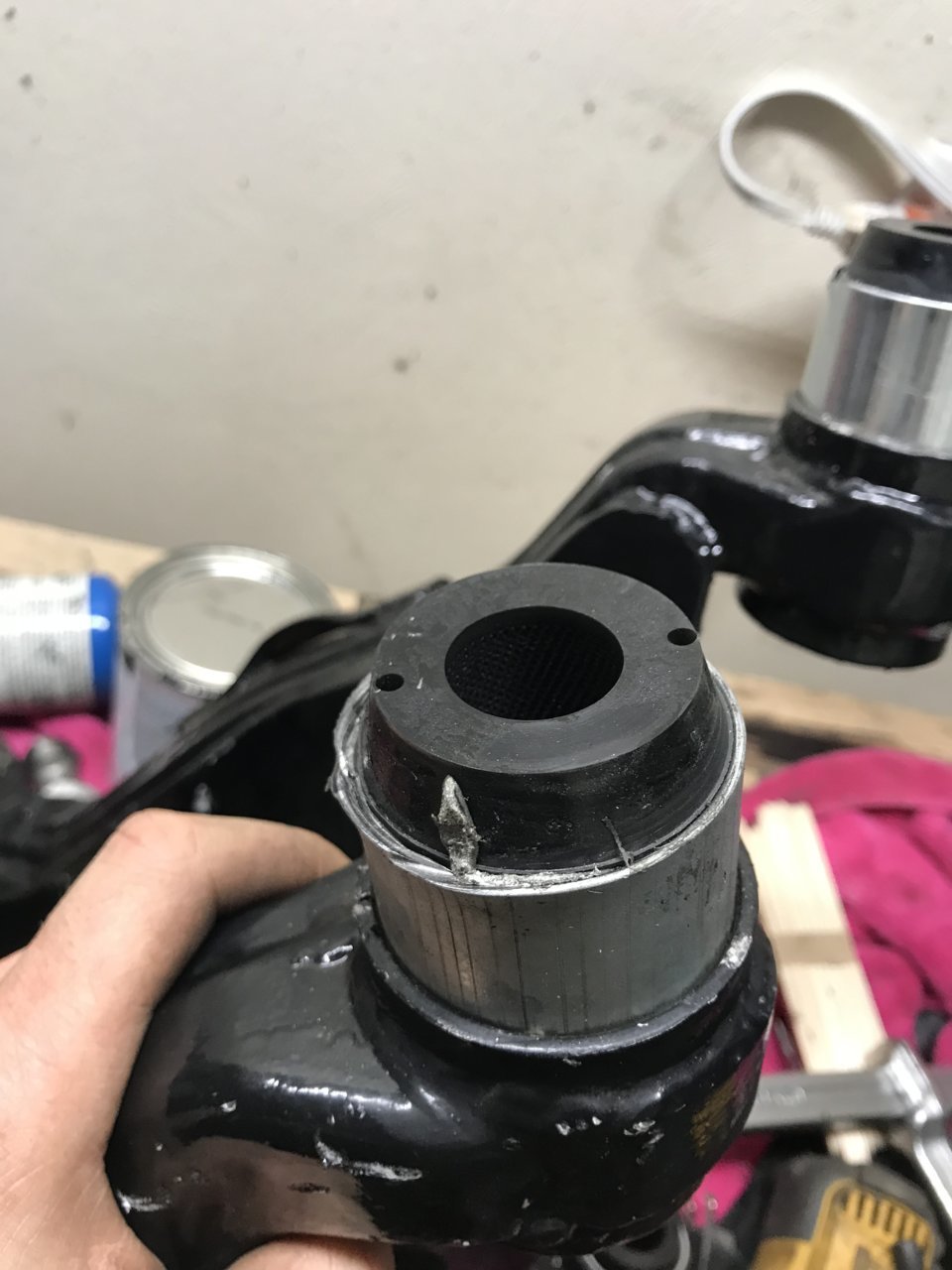

    Pro tip, don't attempt to hammer the whiteline bushings in. The fit was quite snug and I fucked up both bushings. Reached out to whiteline in hopes they'll sell me just the two bushings, instead of a whole set. Pics to follow.

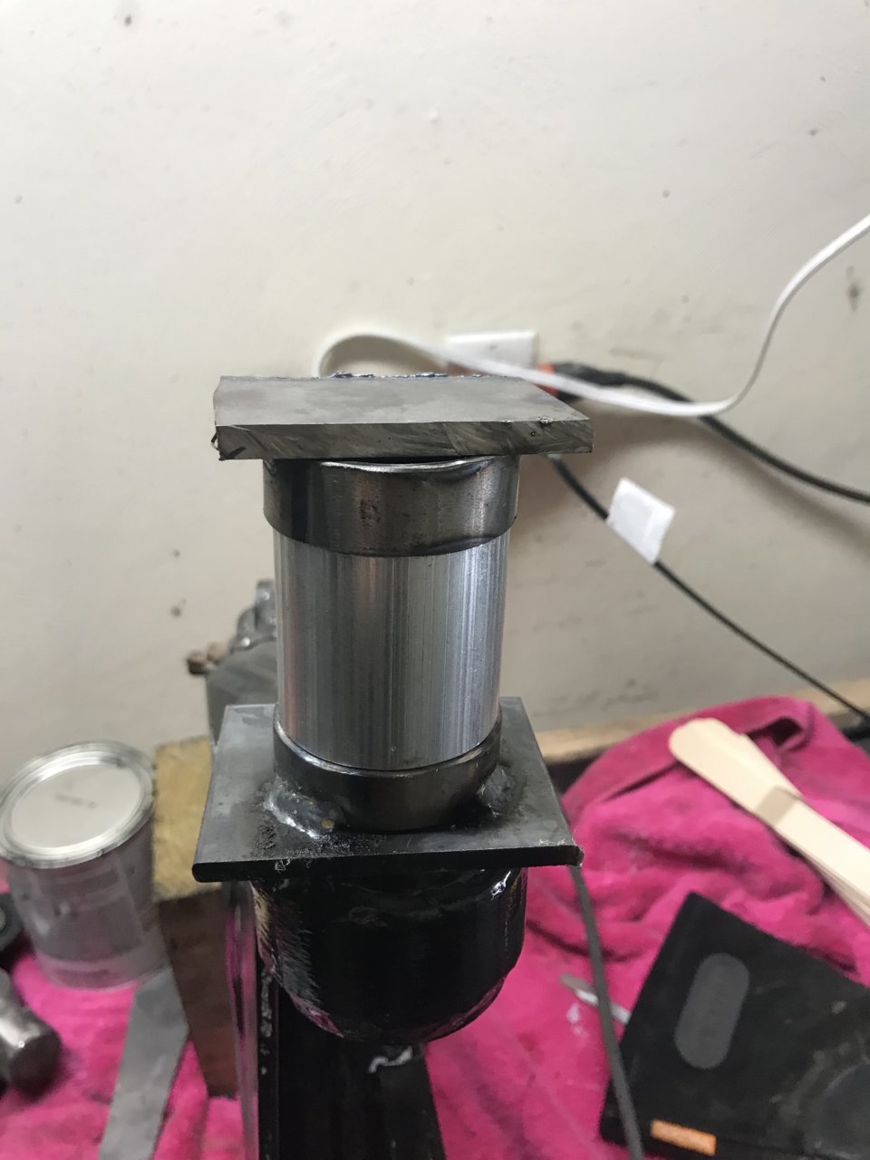

    On the plus side my homemade things helped press the small ones in with no issue.

    Second pro tip, don't say "fuck it, what's the worst that can happen?" and just run the bushing in, pressing from the rubber and not the sleeve. Now the bitch is stuck as fuck in there.

    Well shit. At the shop having a bunch of old bearing races, exhaust pipe, etc we could fine something to work then with all my different bearing press adapters I could always figure out somthing to make it work that way. I assume the ones that are installed are good? The first pic of the messed up one still looks useable same with the 2nd one just with some file work to clean up the sleeve.
