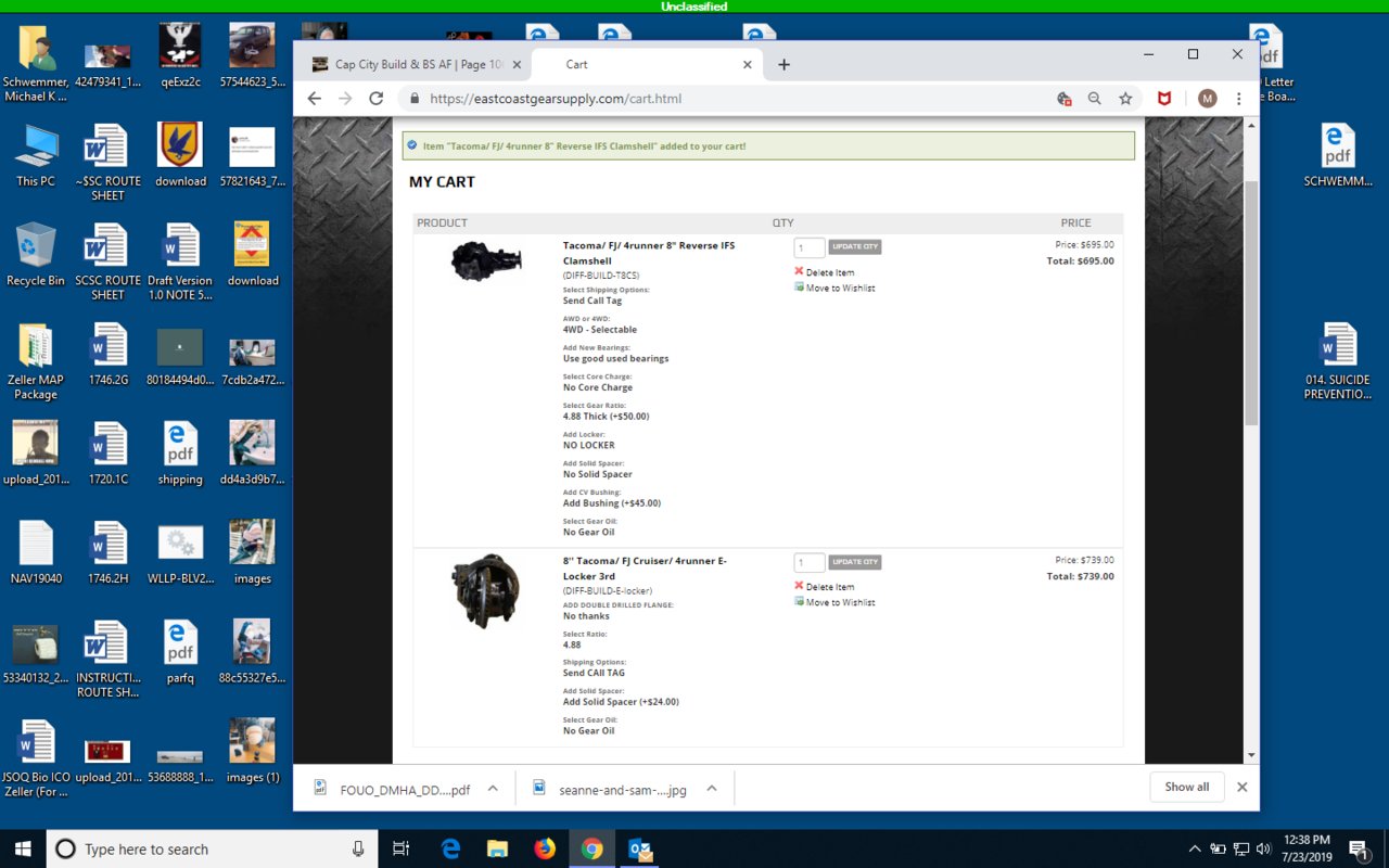

    Ohhhh, I misunderstood you, sorry. So how far away are they? Is it drivable? Or just not worth the drive? Seems like a cool road trip if you can set it up. Of course waiting for the mail man drinking a beer in the A/C is also cool, pardon the pun.
    And what about that break in period? 10 miles 5 times = 500 miles? I was confused by that statement in the vid. Or did he mean drive it 10 miles 5 times letting it cool down each time then after another 450 miles change the fluid? Also, does this apply to lockers as well? I would like to regear for larger tires some day but would also like to add e-lockers. That's a long way off of course but still something I have dreamt about.

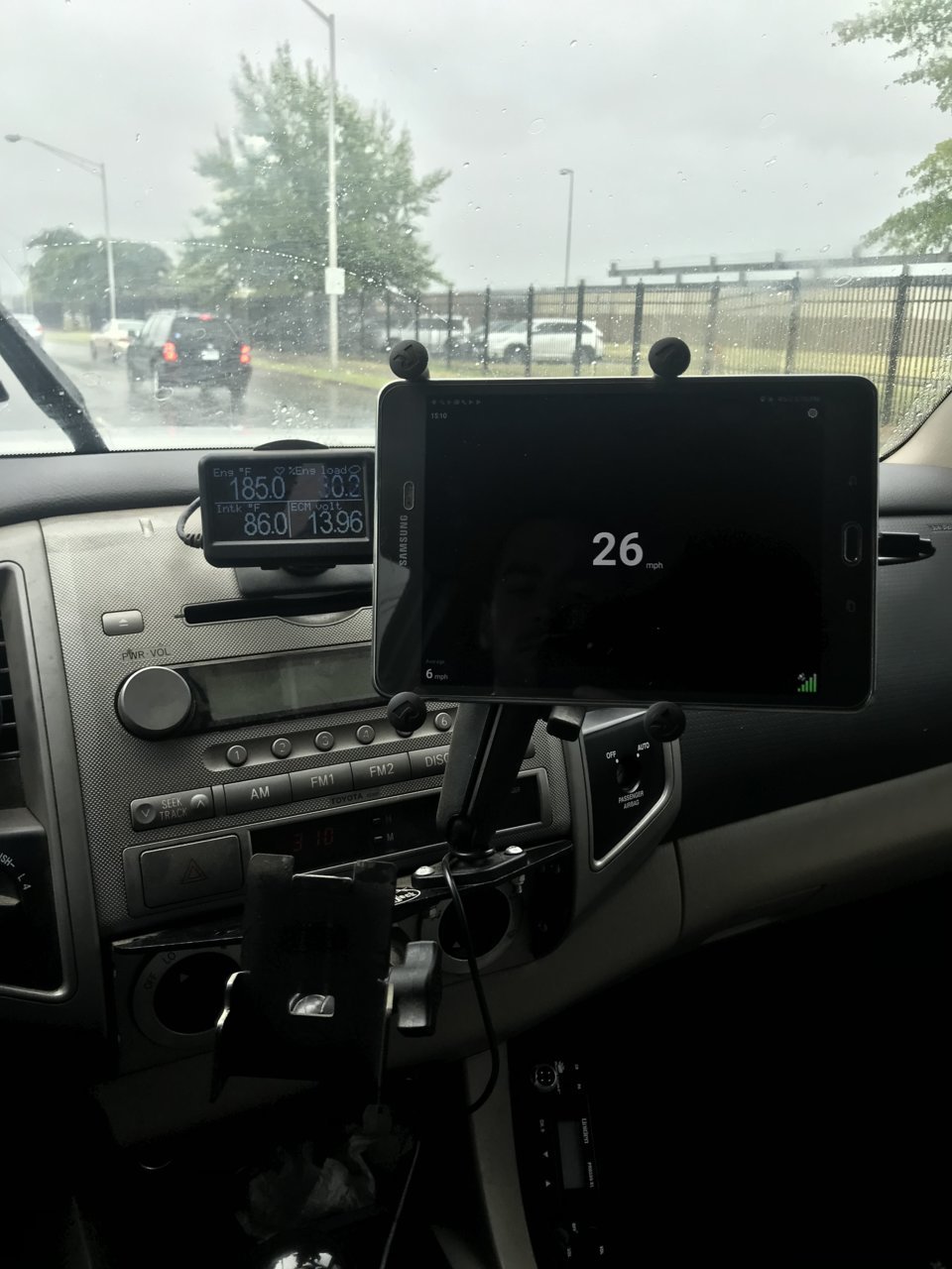

    Pulled the trigger on a hypertech speedo calibrator. My speedo is about 20% off and it’s really hurting my ability to gauge how fast I’m going since what gear I’m in+RPM=speed is engrained into me as a manual driver. It’ll say I’m going 82-83 when in reality I’m going 69-70.

    This is my temporary solution, but it just wasn’t doing it for me. I found myself driving way too slow.

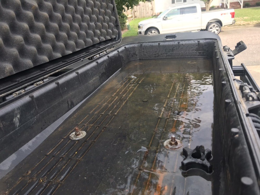

    Over these planos. Both were filled like this. Spare parts rusty and recovery gear moldy. Going to eventually replace with pelican cases. Deciding what I want to do with them in the mean time, may take them down.

    That sucks! Huh, I wonder if it is a fluke? Wonder where the water is getting in?

    I'm looking to get some aluboxes. That happened with my plano too.
