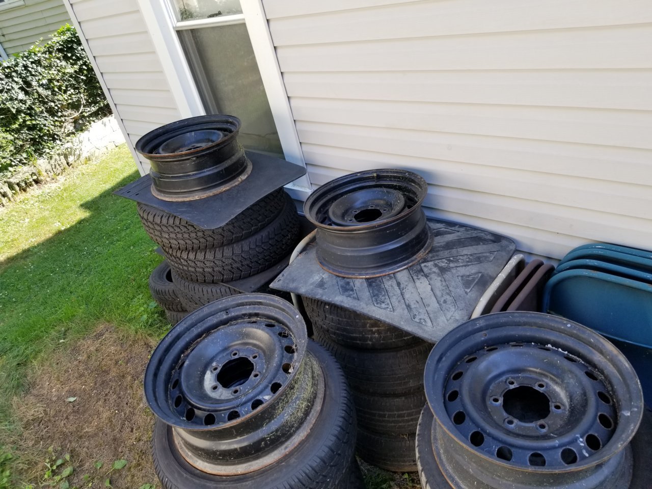

    I already bought 17" steel wheels. I even already bought new OEM TPMS sensors. Right now the wheels are at Kore Offroad about 6 hours north of me. They started off in Pittsburgh and are going to AOAA then to eastern PA, then ultimately to me via our fabulous TW Express! My lovely wife, aka the smart ass said the wheels will have more miles on them than I'll ever put on them. HA HA HA.
    I paid $100 for them. I paid $130 for the TPMS.
    Can I work with these or should I look for 16s?
    Justanotherhemi likes this.
