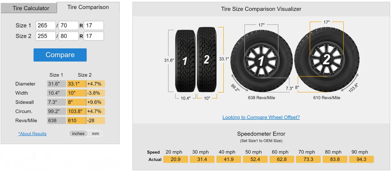

    I just assumed 16s. You can buy 255/80r17 and achieve the same exact thing.

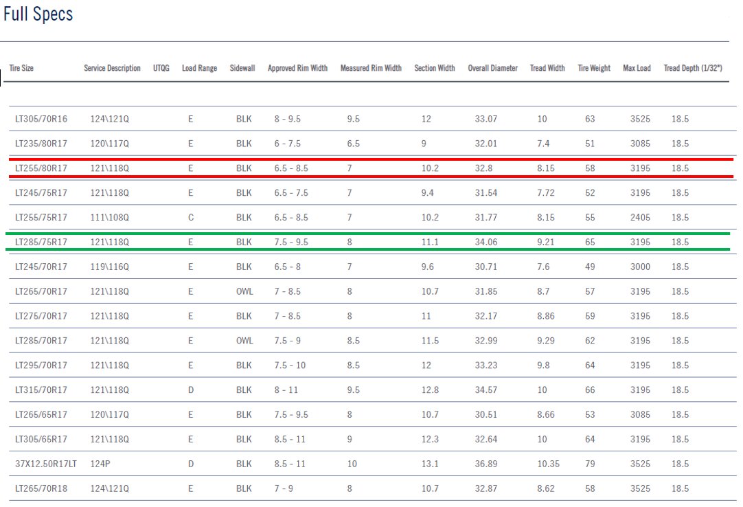

    So the 255/80 is a better choice than the 34" 285/75 ?
    Also, did I calculate that wheel spacer need correctly?
    Thanks again Randall.

    They’ll be better in the the sense that the 255 will be much more trouble free. Less clearance issues and better mpg. Less noticeable while driving down the road. No need for spacers with them either.

    Ok, when you say "trouble free" I assume you mean taking everything else you specified into account? Also, "Less clearance issues". Does that mean no clearance issues or will I still need to do the CMC and Pinch Weld. If so then I am not opposed to going to the 285/75, with spacers and buying the OV Tune to help with MPGs.

    Correct, you wouldn’t need to touch the cab mount or cmc. That’s why it’s a popular size since it’s so low maintenance.

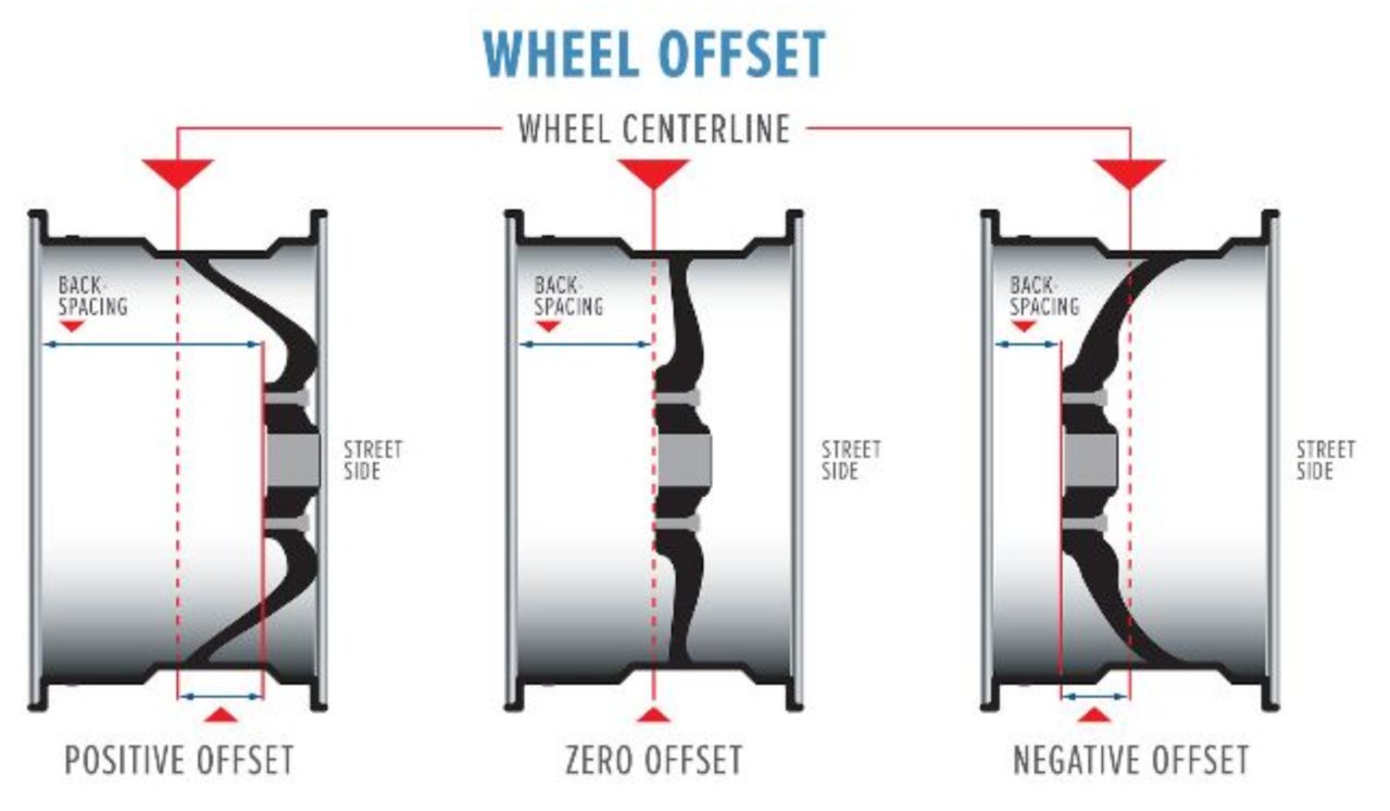

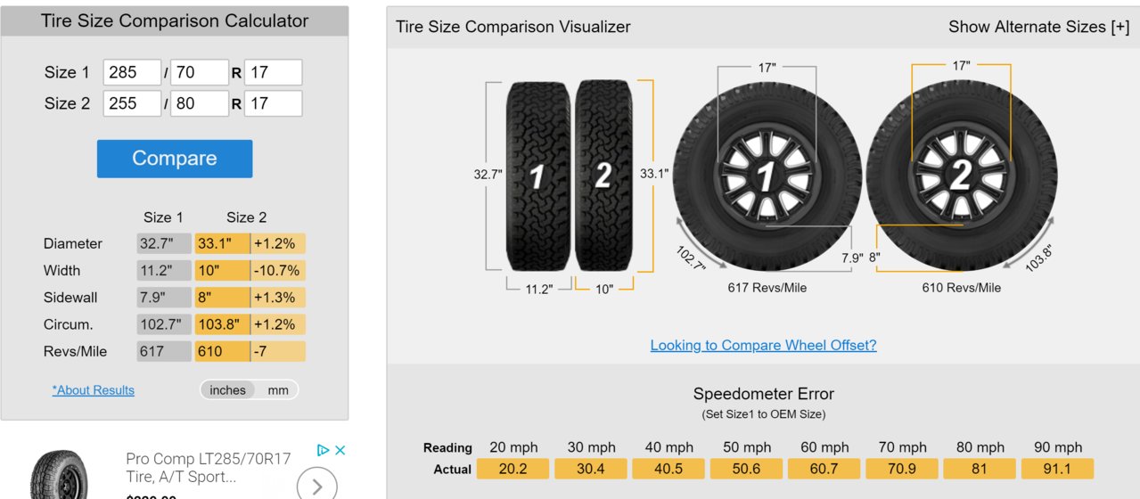

    I'd like to achieve as much lift as possible with the tires. But basically the 255/80 is taller than the 285/70 and narrower.

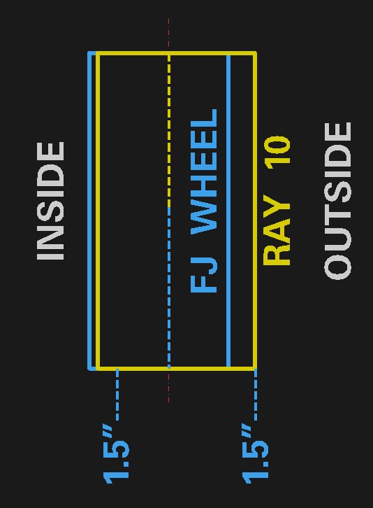

    Could I still run wheel spacers to help push it (the 255/80) out farther? I think that if it is tucked in there beyond the fender flare it will look a little silly. I certainly don't want to spend money I don't have to but..........however, you know I already rub with the 265/70s so.......

    You certainly could, but then they’re going to rub. The reason it doesn’t rub is because it’s nice and sucked in. This would also keep road salt and mud from flinging up on the truck.

    Cool Cool Cool! I was afraid of them hitting the UCAs.
    You know, the mess or lack thereof was definitely a serious consideration. I realized that as soon as I drew up my own backspace and offset diagram. Especially off-roading.
    Thanks Brother! I'm glad I asked for help in here. I really appreciate your, and everyone's input a lot! Y'all know that.

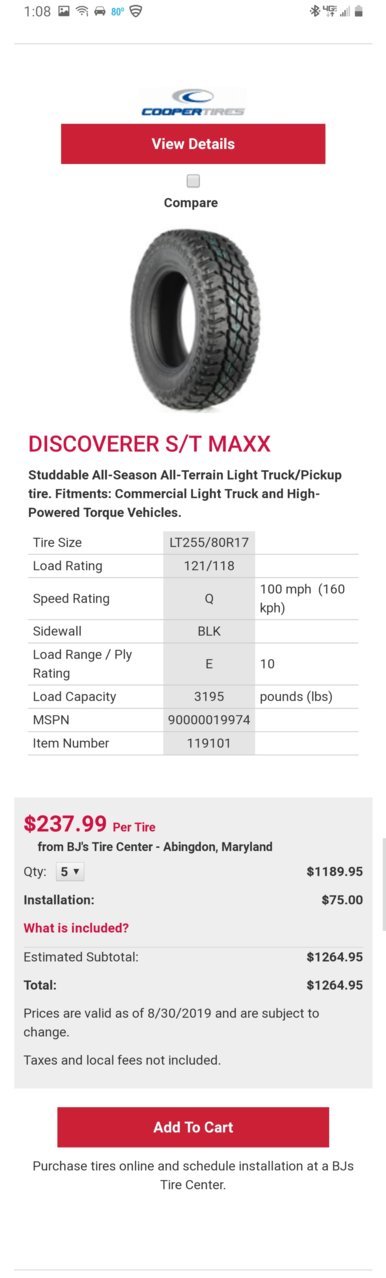

    TTC Member #0125
    This seems like a great price. On the rim, out the door, including lifetime rotation, balancing, flat repair, road hazard, etc.
    Plus Tax of course. Total would be $1,341.00 for 5 tires.
    Justanotherhemi likes this.

    Do you happen to know the specs of the wheels? I don’t think they’d rub the uca since they’re even narrower than stock tires.
