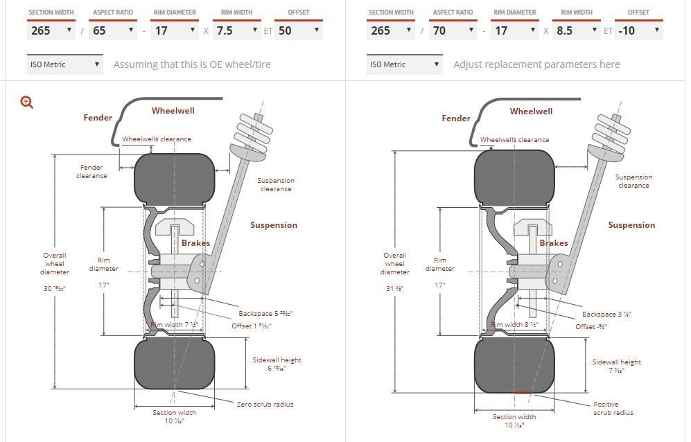

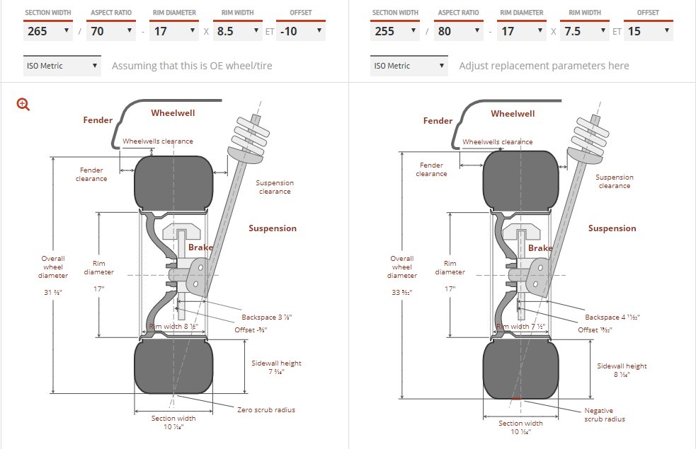

    These are (were) the specs:
    OEM Wheels 17" x 7.5" ? BS, +30mm Offset - OEM Tires 265/65r17
    Ray 10s 17" x 8.5", 4.30" BS and -10mm Offset - Nittos are 265/70r17
    Steelies 17" x 7.5", 4.50" BS and +15mm Offset - Coopers will be 255/80r17

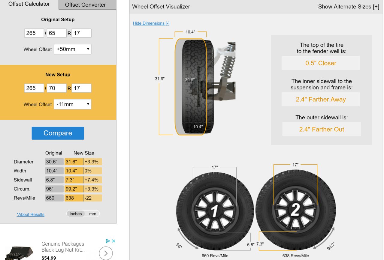

    I found this handy dandy little tool today: And was able to create this:
    This OEM vs Current:
    And this is Current vs Winter Setup:
    Of course this is just a graphical representation. It doesn't know the geometry of the fender, brakes, or suspension. It does prove though that the 255/80r17 as Randy, you and others have said will be less maintenance.
    This website is also useful if you switch the tabs at the top: OEM vs Current
    Current vs Winter
