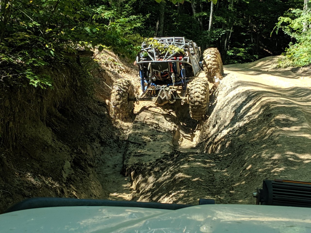

    Tose rock bouncer rigs scare the shit outta me in the best way possible. The race ones are pushin 1200+ hp :eek:

    They make me all warm and fuzzy inside. I love the feeling getting in it and settling in. Reminds me of some of my old cars. Some of the rock bouncers are pushing upwards of 1600 hp now.

    I sat in a trophy truck once, and my brain and my body agreed "this feels right". Love workin the races out here and when all the trucks are on the staging line, the chorus of loped cams and race gas brings a euphoric sensation.
    Worked speed patrol for the pits one race this season right by the start / finish where there was a big transition. Lots of air time for the big boys.

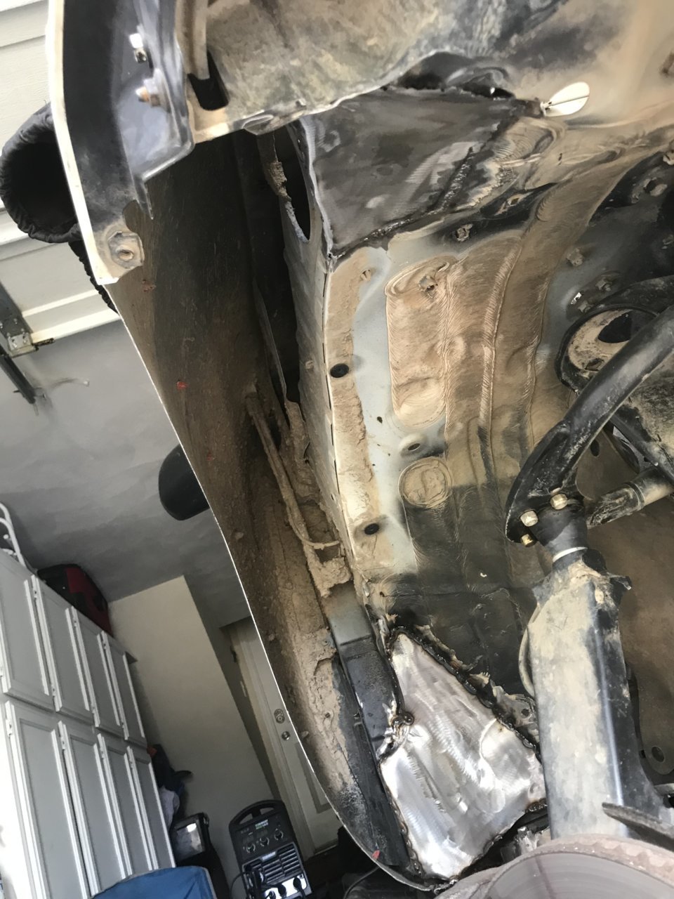

    More progress on tubbing. Passenger side is all cut up and welded. Firewall, cab mont, and front fender behind headlight.
    Just need to clean up the welds a little, and seal it all up.
    Bocsy44, RobP62, Rome604 and 3 others like this.

    :drool: Looks good. Appreciate you documenting your process.

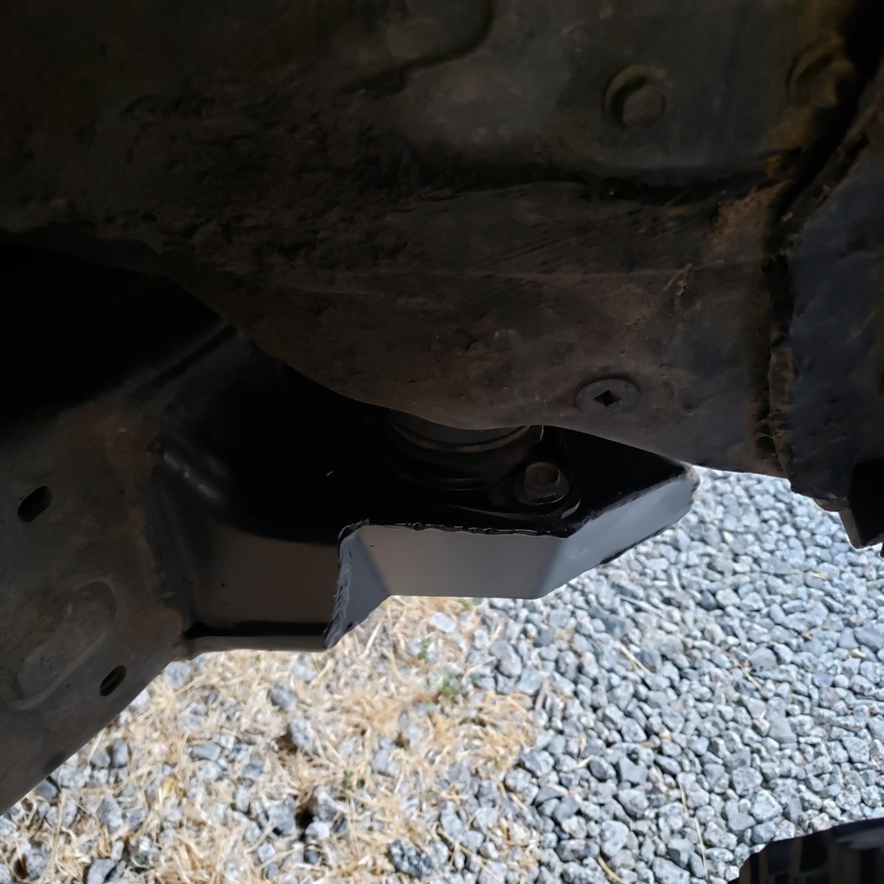

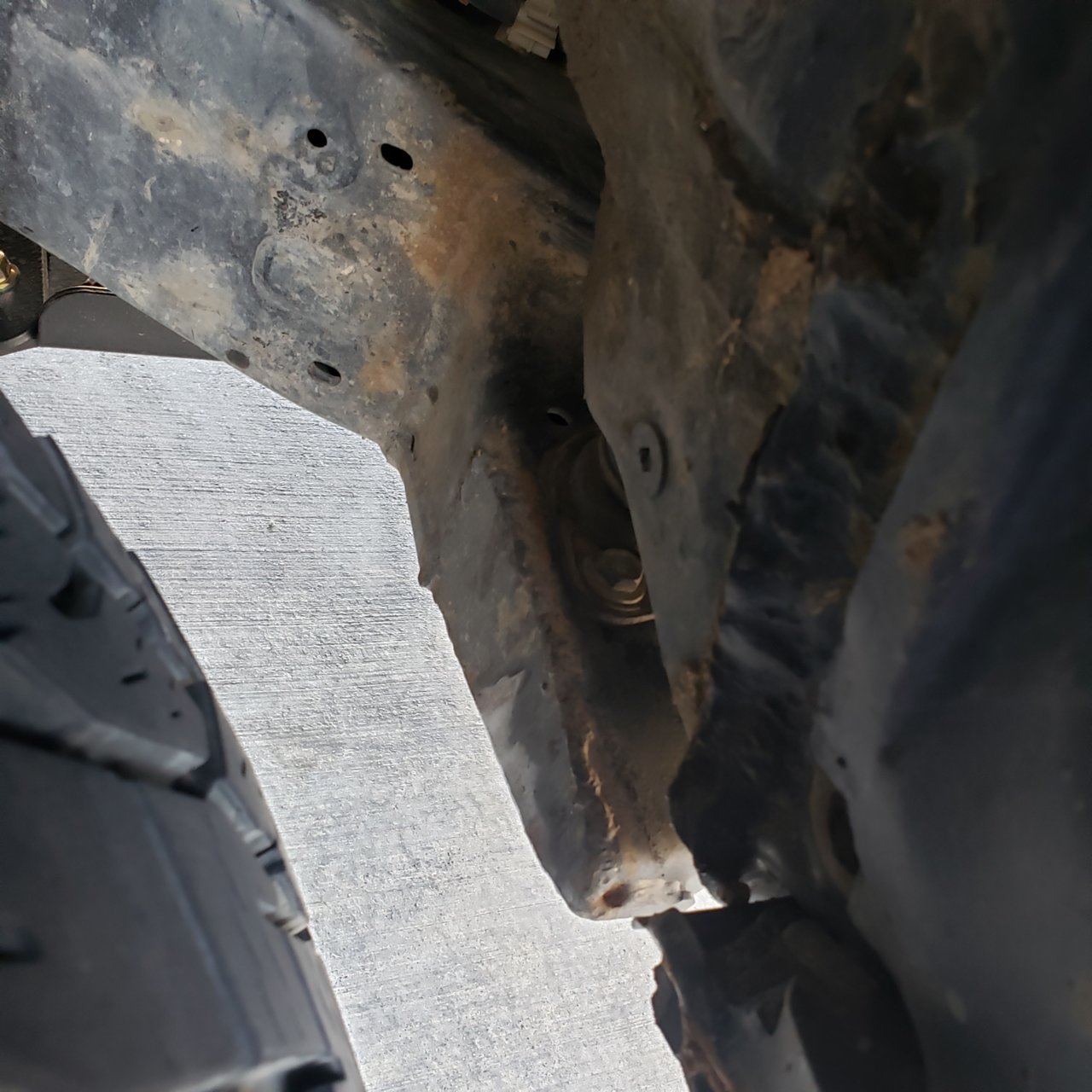

    I took my first step towards 35s. I redid my cab mount chop.
    Before:
    After:
  18. Sep 14, 2019 at 2:51 PM
    Taco-Obsessed
    Dec 23, 2018
    #276756
    7,444
    Did you relocate your cab mounts or just cut them back more? If relocated, alpine?

    I bought alpine preemptively, however I ended up not needing them. I just cut the fuck out of my cab mount. The mini bolt on top is now cut in half and just welded on. You can see it in that second pic up there.

    Got the passenger side 100% done. It’s all sealed up, sprayed with flex seal, interior back together, greased everyone I can in the front suspension, and torqued to spec. I made sure to caulk inside and outside thanks to a tip from @cynicalrider. Can’t say I would have thought of that.
