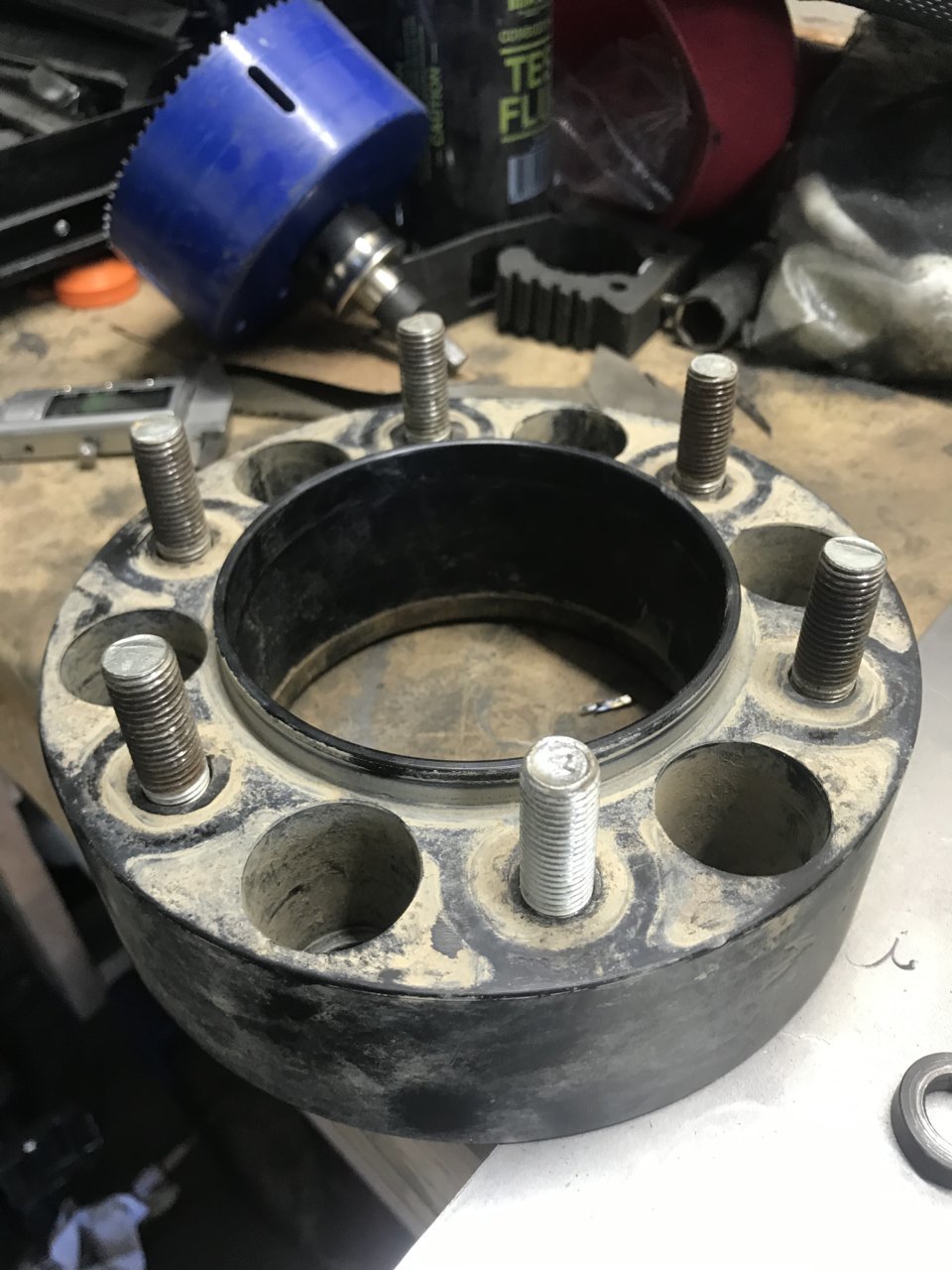

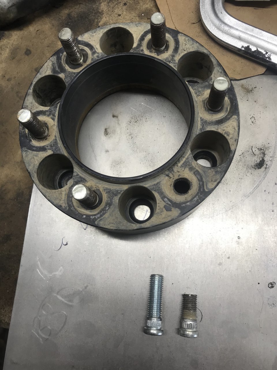

    Pro tip, dorman 610-254 wheel studs are a direct replacement for bora wheel spacers. $2 at the auto parts store. Hammered the old one out, and had the new one installed in a matter of minutes.

    What size spacer is that? Good to know for mine! I figured that the spacer companies probably used some aftermarket off the shelf 12x1.5 stud. Glad you figured it out.

    That’s a 2”! You can confirm by looking at the back of the stud. Should say 254 on it. If it’s a different number, try searching “dorman 610-XXX” with the numbers and see what comes up.
