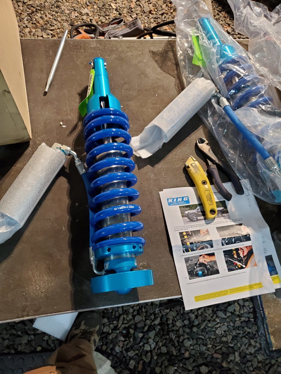

    Soo who all has kings on 700# coils? Any recommendations on preload? Full bumper synthetic line winch, aluminum skids, kinda fat in the back :anonymous:

    Start with 7-8 threads of preload

    I'm trying to wrap my head around how much beefier these look that my 700# fox's. Logic would say match the preload I have on the fox's. They just look more built than my fox's so I'm skeptical. I guess it's easier to take away than add preload when they are on the truck. I have never adjusted on truck anything with resi's so not even sure it can be done. These also have a 18 stamped on them. I dont think you could fit a 18 inch coil so not sure what that is. I think my current coils are 14 x 700# eibach.
    I'm way overthinking this :rofl:

    I’m running these coil overs with those coils and have 7-8 threads and about 2.5” lift. I’d say start there and adjust as needed. Maybe 9 threads since you’ll be a lil heavier

    9 threads total or over how they ship them? Thanks for the advice!
    My back is killing me and I really dont want to do this twice. I still need to pull apart the rear and do resi mounts. They came today as well. I should have just left it on jack stands. After two back surgeries those 35s are not easy to throw around anymore. Seriously thanks for entertaining all my silly questions:thumbsup:
