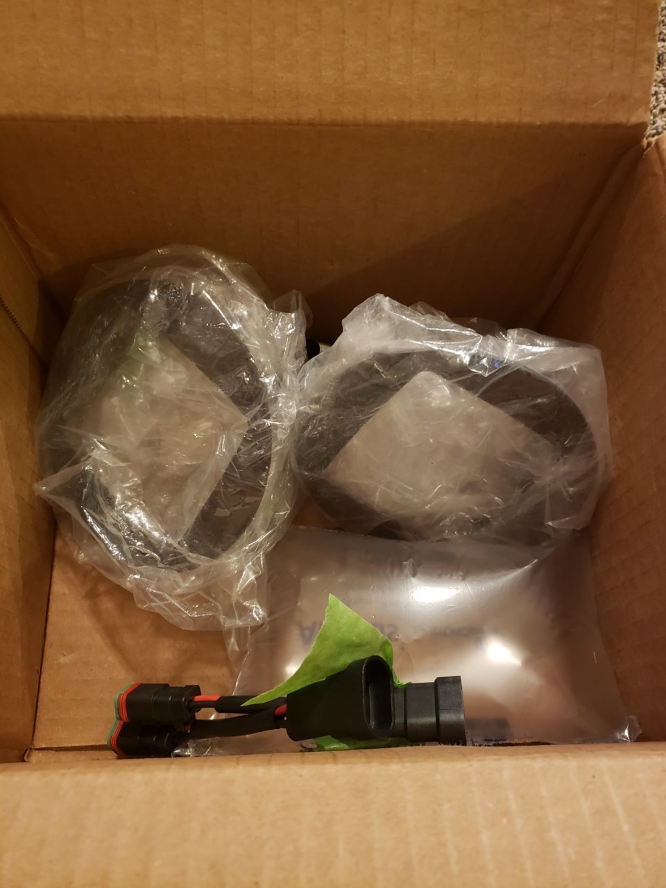

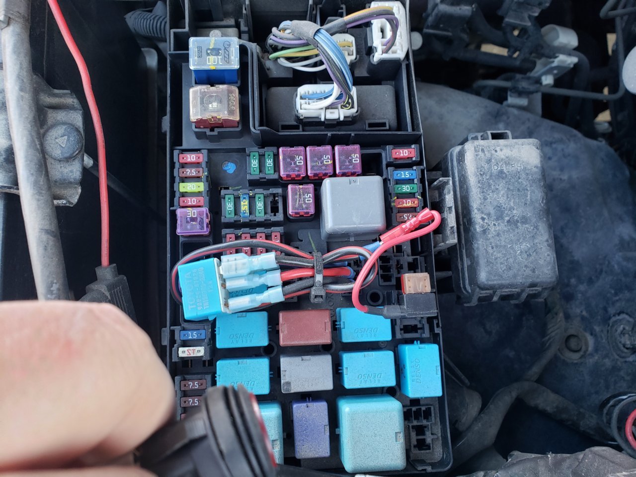

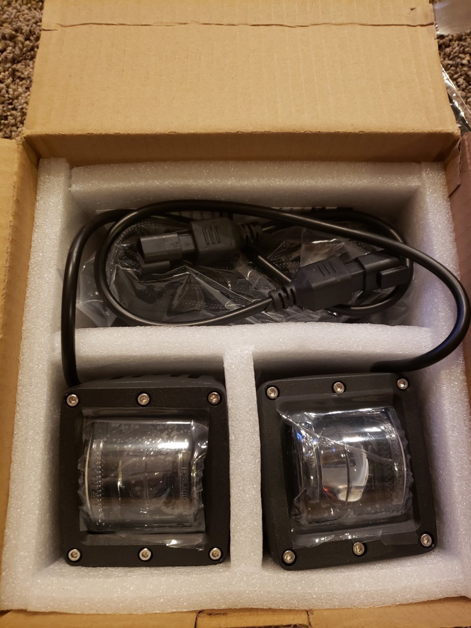

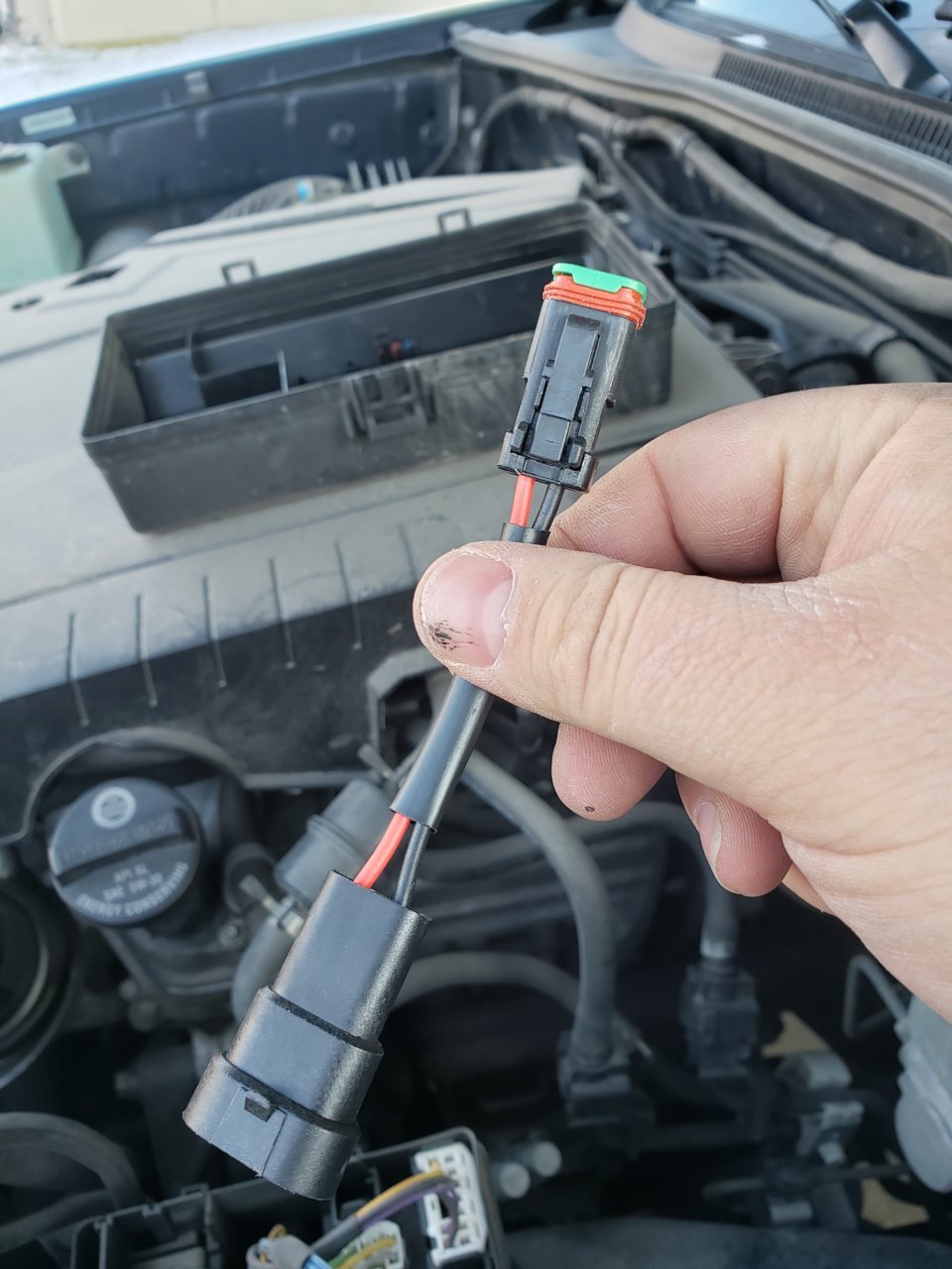

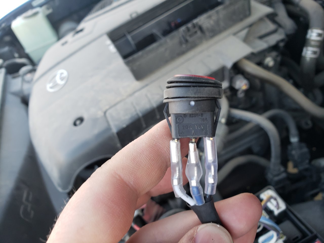

    Wiring gurus...I need assistance. I installed my new pod fogs with a caliraised pod adapter. But they wont work. They came with an independent wire harness. My question is, is there any way to tie the wires at pictured switch or harness into the fog light relay so I can maintain my factory switch?

    Polarity is probably wrong. Try This.

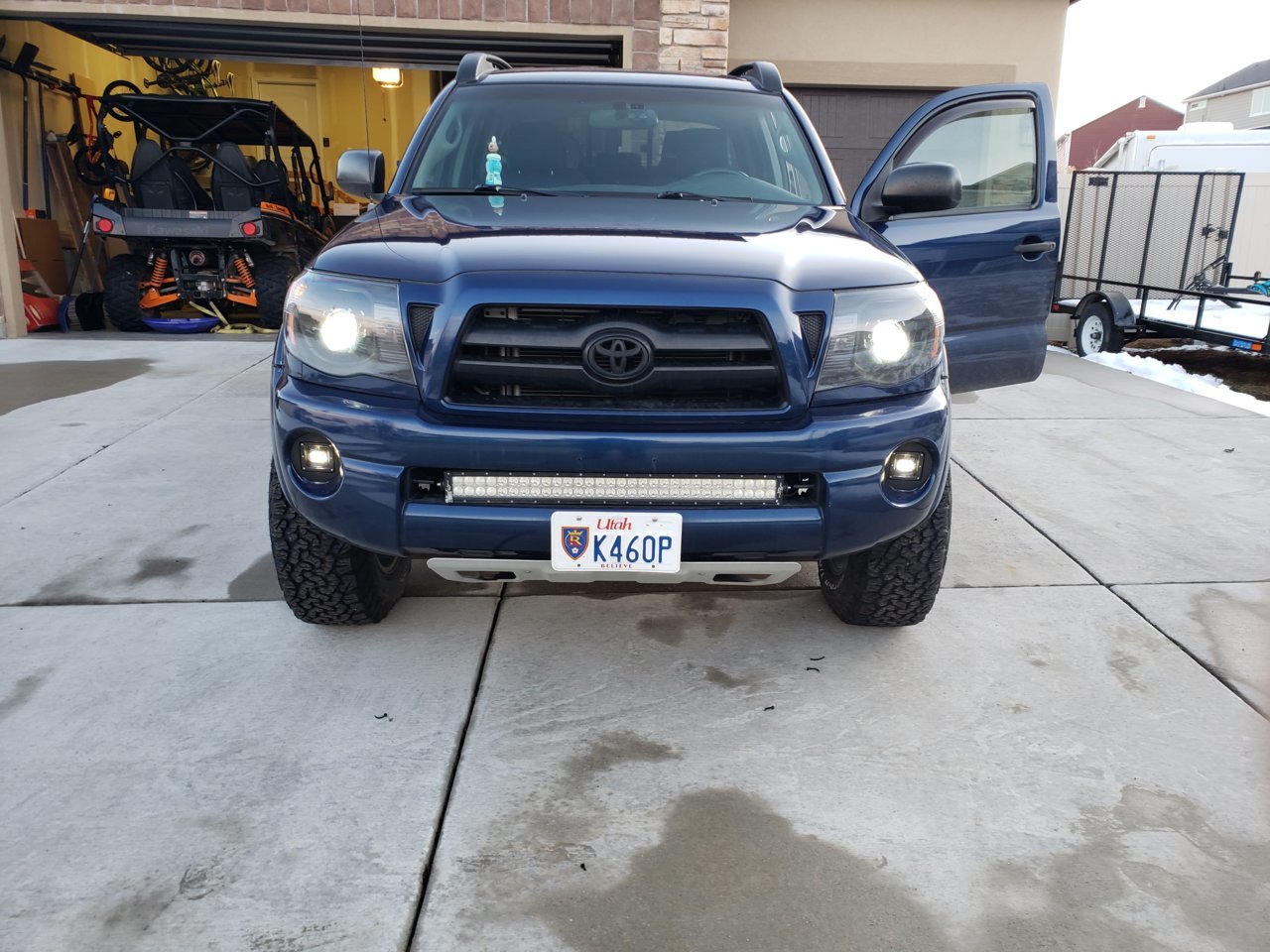

    DUDE!!! You are the man!
    15 seconds making the switch and hooking the pigtails back up and...

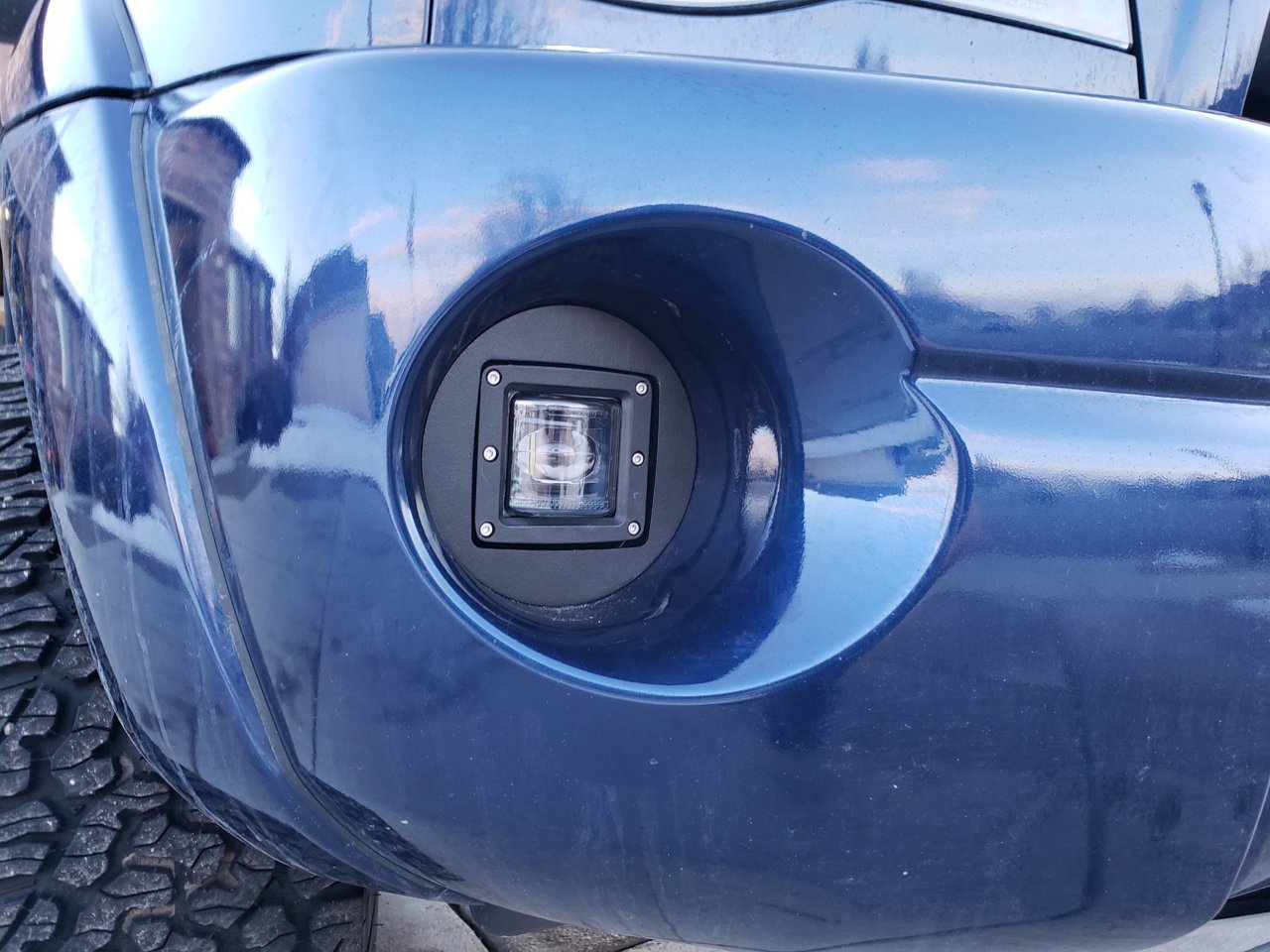

    Here they are installed!

    I had a very strong feeling that was it!

    I wondered about that earlier when I was laying underneath cussing, but in my frustrated haze, I didn't even think to Google how to switch the wires in the Deutsch connector!

    Damn Daniel! You did good. The fogs look on point.
